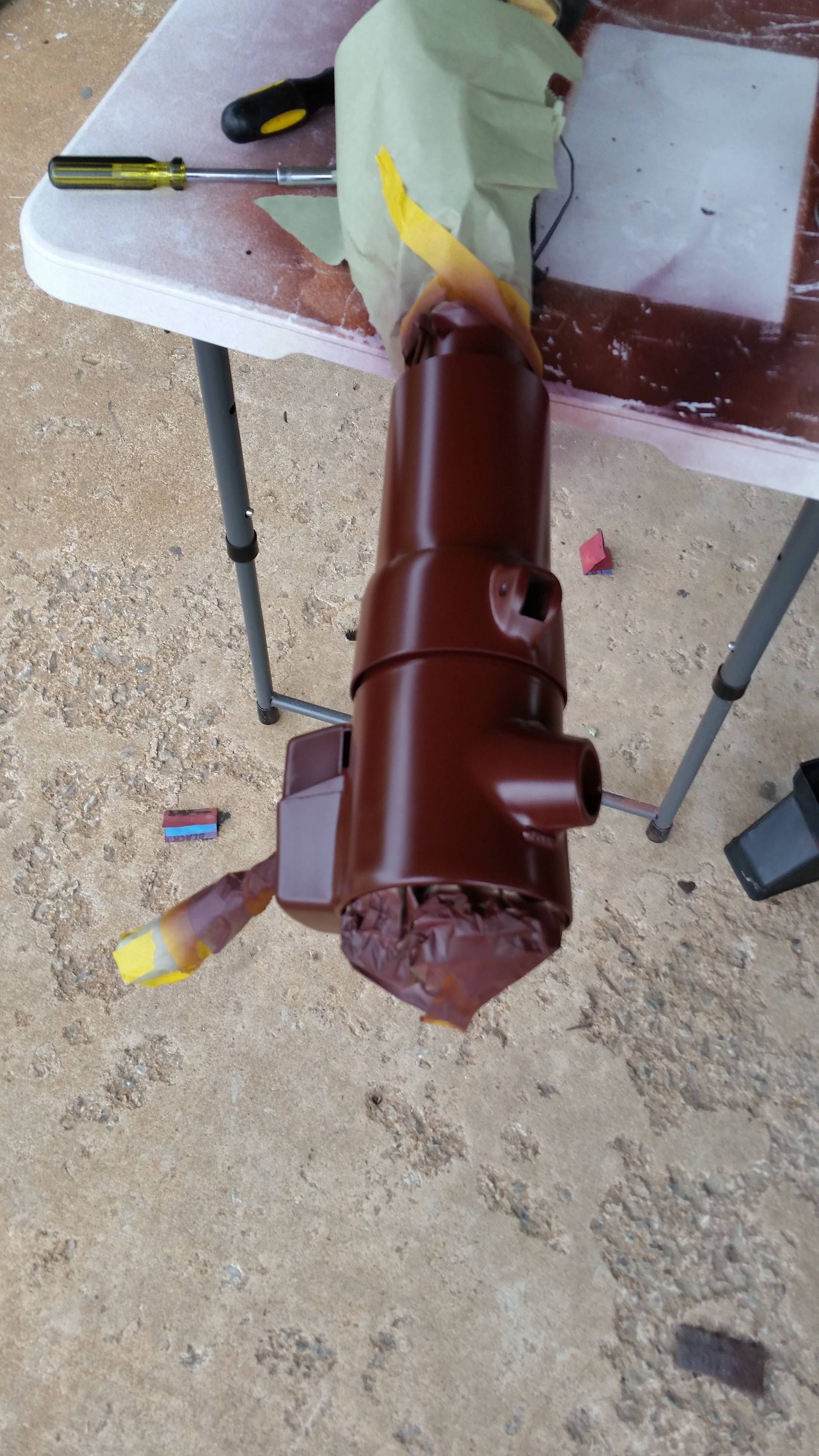

and this is why you want to use SEM instead of dupli-color.... caps showed same color, column in SEM...
