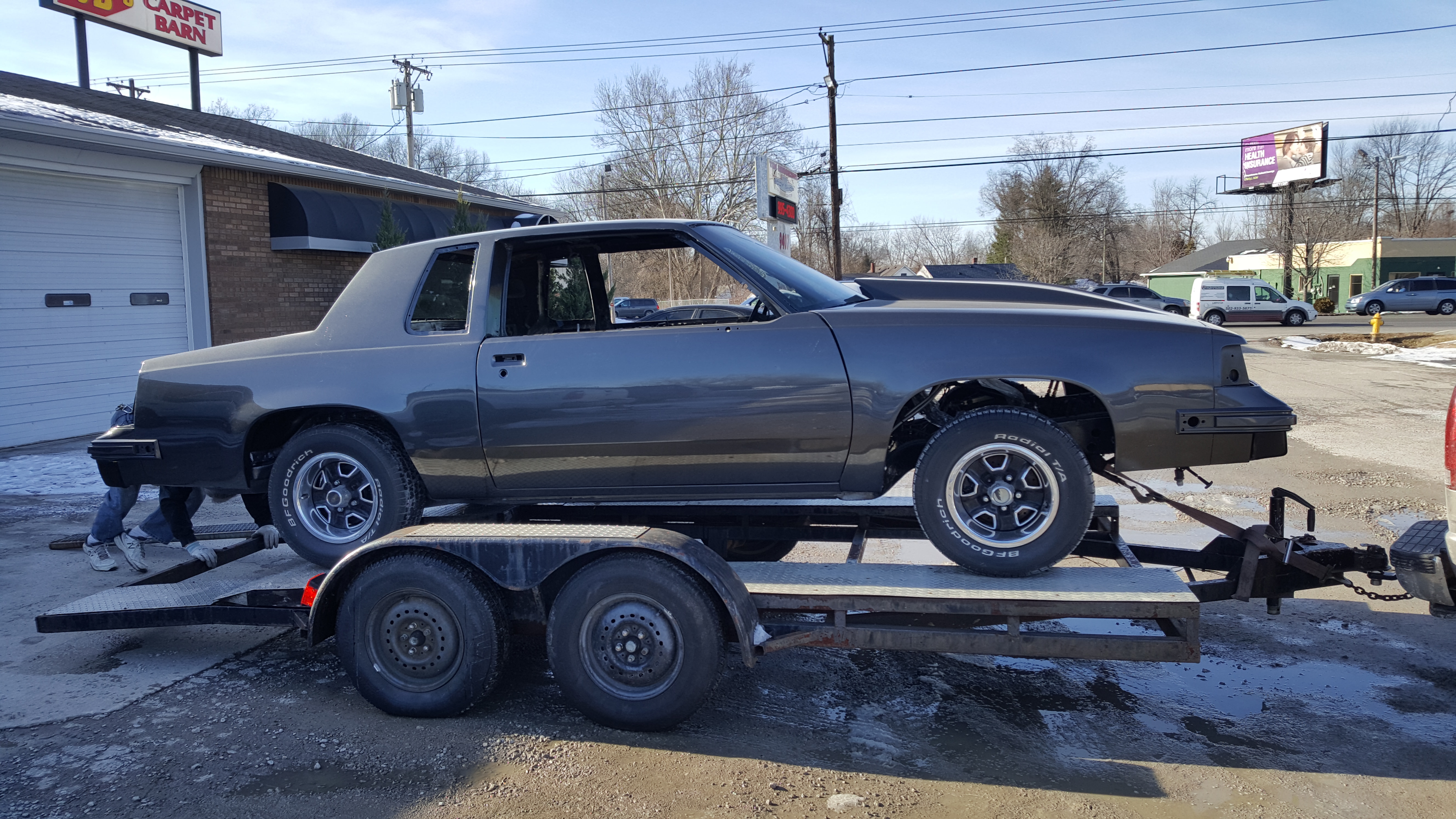

Here is a couple pics of mine. '87 Cutlass that has been through a ton of metalwork and subtle body mods. As mentioned, I just brought it home from paint yesterday....View attachment 80947 View attachment 80948

Gorgeous car Injectedcutty! I hope to one day get around to at least repainting mine.
