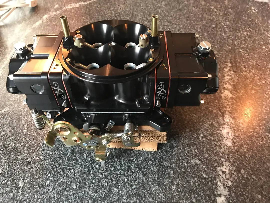

Why are you even messing with power valves - rule of thumb is +4 on jets w/o power valves and that's when you jet square. As I said earlier quit guessing and use an o2. I've used APD and been very happy with them and service. Just bought a pro billet from them.
Looks like a good peice wish I had the money for something that nice lol
