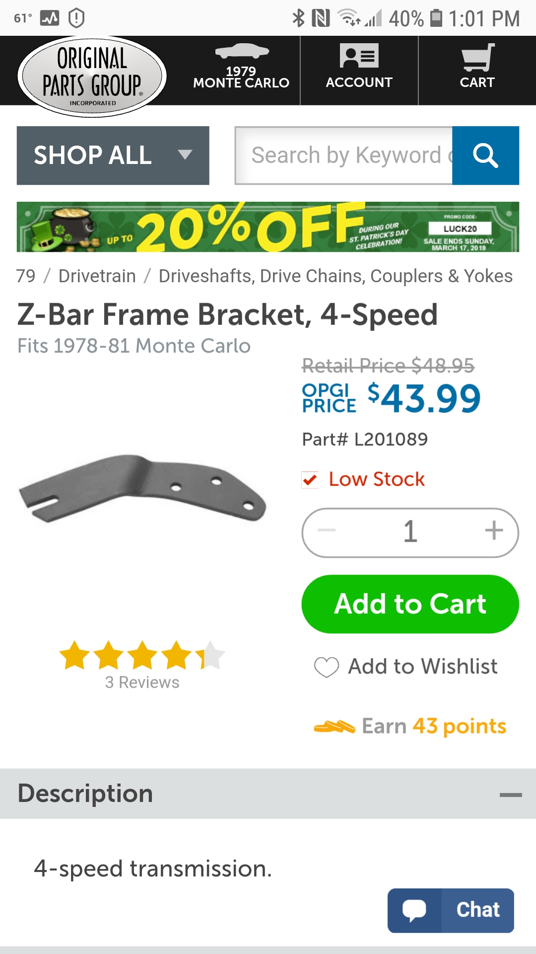

James, you can get the frame bracket from OPGI or the Parts Place.....

Shop around on that bracket and anything else you need clutch linkage, wise. OPGI is pretty proud of their stuff. All of the pedals, linkage, ball studs, etc. is reproduced and is available. All my stuff was worn out and hacked up (my frame bracket was good, and I think my clutch pedal just needs new bushings) so I bought a new equalizer (z-bar) and ball studs from the Parts Place. I'm going with the spherical rod end linkage.
