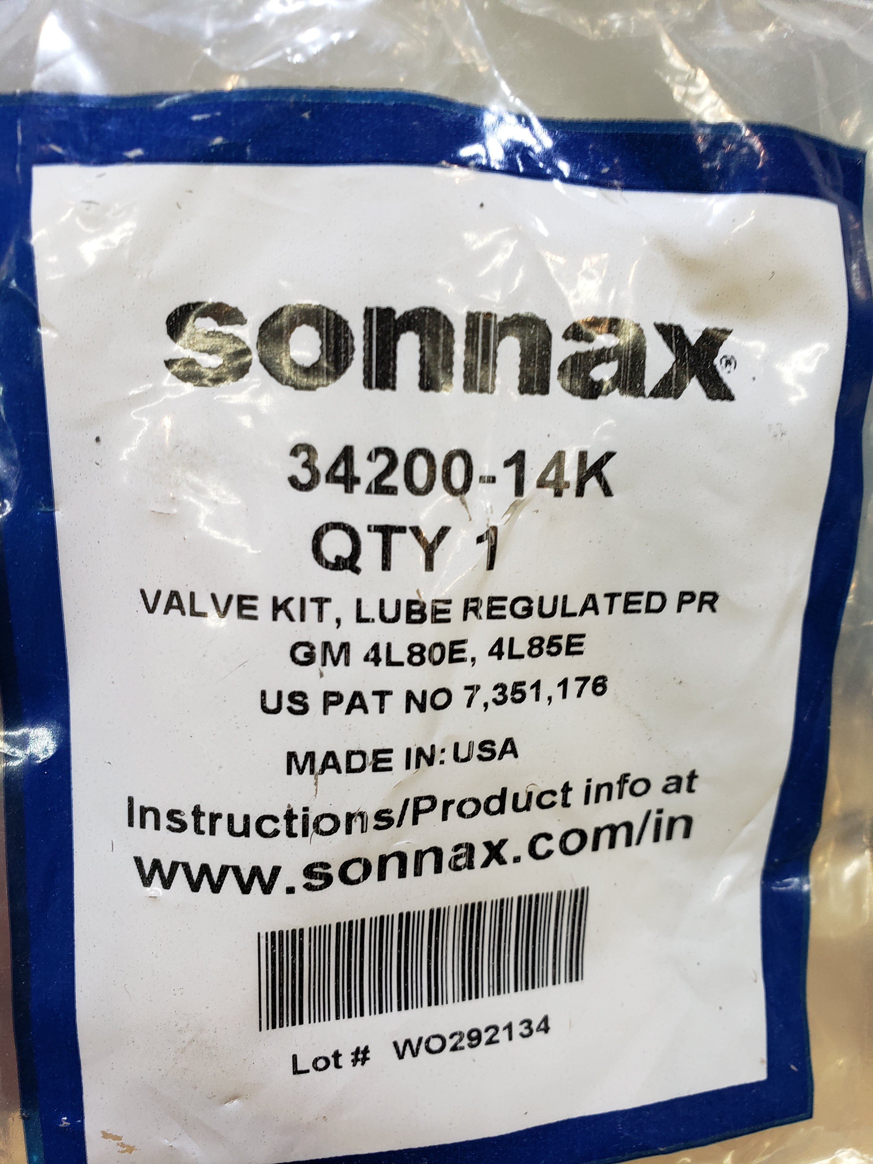

Took some time to install the Sonnax lube/line pressure valve. Hopefully this fixes up my dragging lockup clutch.
Also discovered my trans cooler ORB o-rings were both torn so it's been seeping and got the fan and fins all soaked. Minor issue but annoying.

I had to use a sunnax valve in my 80e after I put a higher stall converter in it. Worked as advertised.
