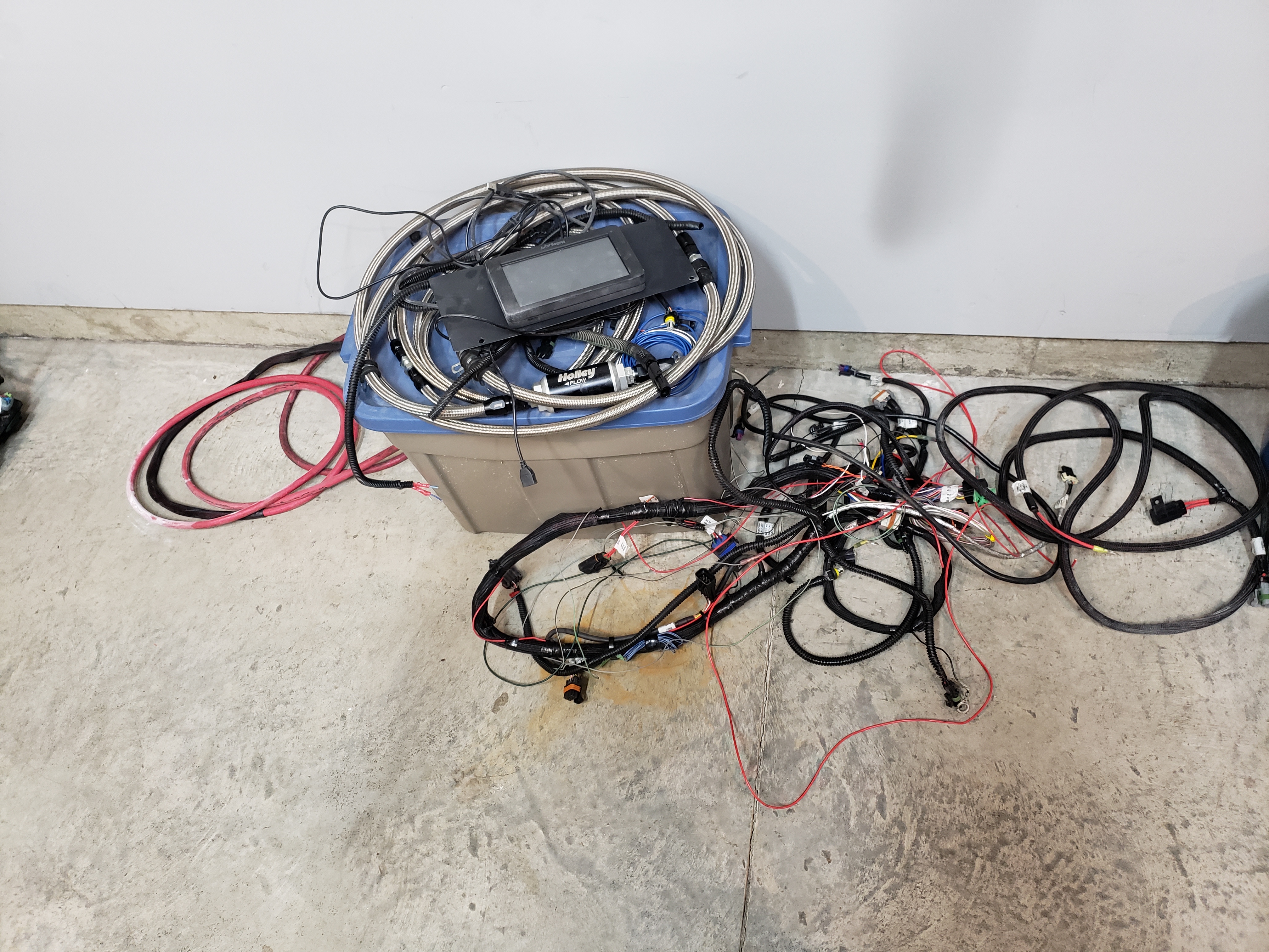

Got pretty much everything out of the regal tonight. Just need to unbolt my ecm/fuse block, unbolt the fuel regulator and hood before the powertrain can come out. Only 4 bolts hold the motor and trans in now. Tomorrow is hopefully hanging the second fuel pump in the tank and getting the hood off so the swap can happen this weekend.
Sad little pile of wiring on my garage floor.
I can say again I hate the dust side of bodywork. It is so thick in the regal I was covered in dust by the time the wiring was out. Poor car is just full of dust.
