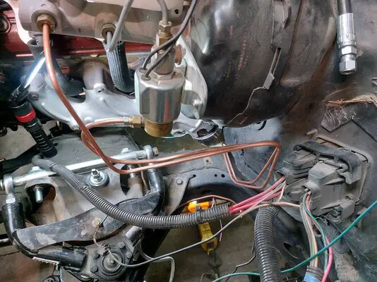

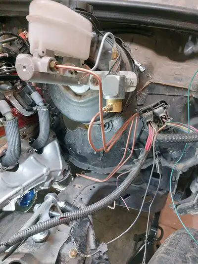

Got 3 of the brake lines made today. Still need to come up with an adapter for the line from the rear end but I need an adapter for that one.
I decided to route a little cleaner as I was sick of fighting the coils on the stock lines when checking plugs.

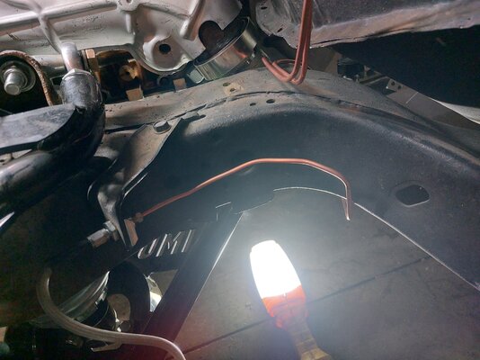

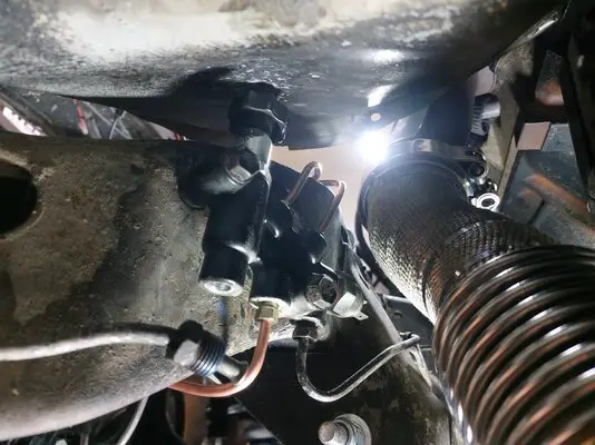

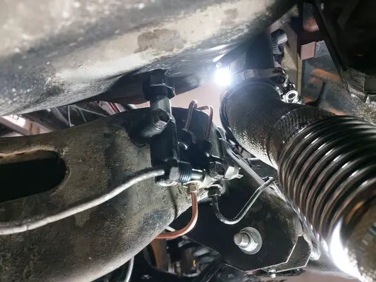

Ran the drivers brake line under the frame, mostly to stay away from header heat.

Fair amount of clearance now, I don't have a before pic handy but I had one line heat wrapped because is was close to the header band clamp.

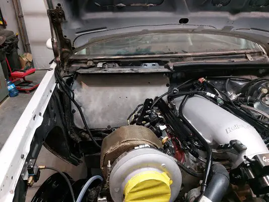

Then got the rivets from the previous heater delete, that the previous owner installed, driller out and scraped some of the sloppy gobs of silicone out to install the Mike's Monte aluminum delete, you know, light weight racecar and all.
