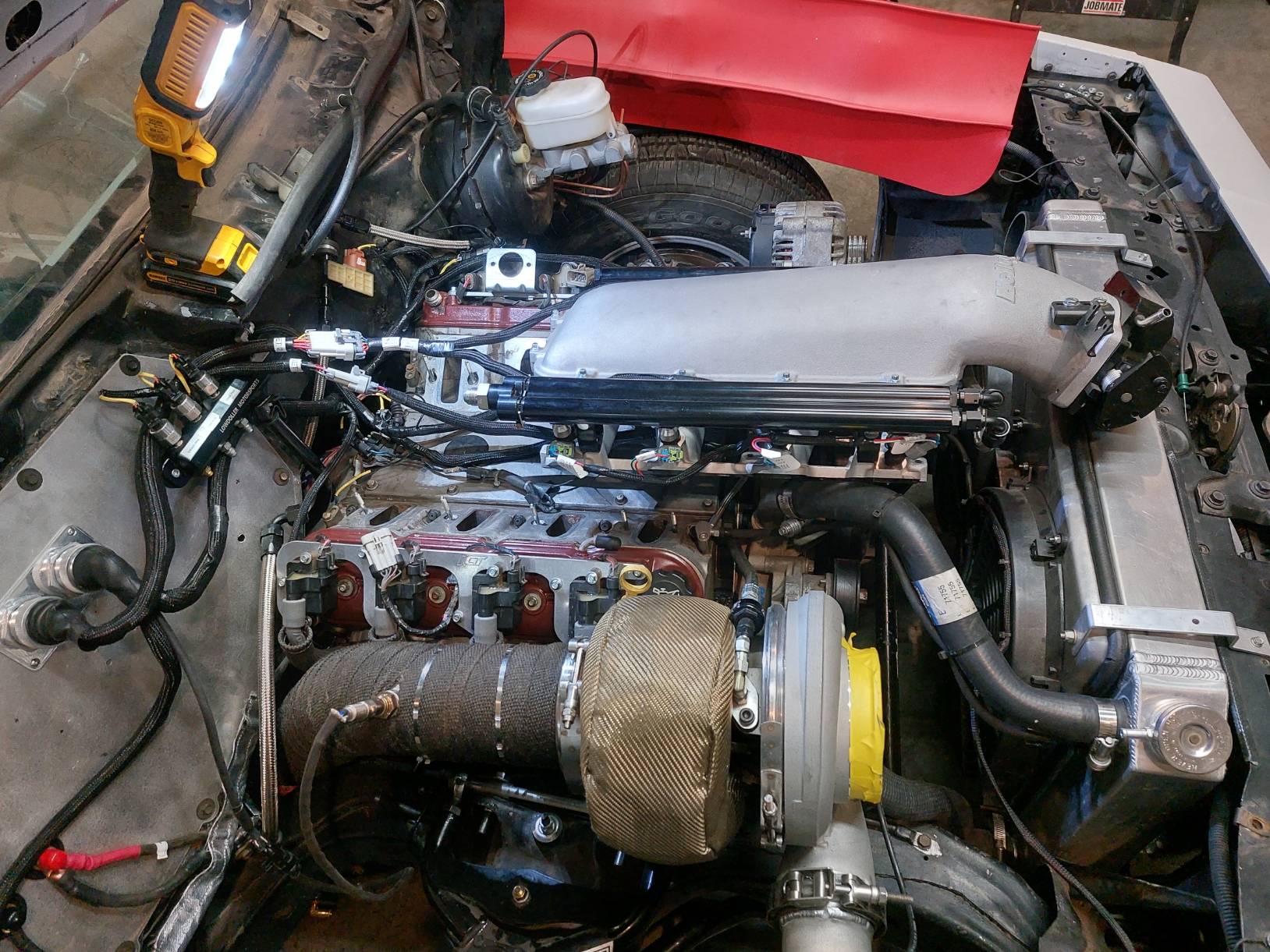

Quick update with todays progress. Despite it being a beautiful day outside and the dog loving the sun.
I got the underhood stuff buttoned up, wiring is 90% complete for the harness, only have a few things left to put in (fans 4 port valve and Nitrous). Discovered that I forgot a primary cable to the starter, kinda important.

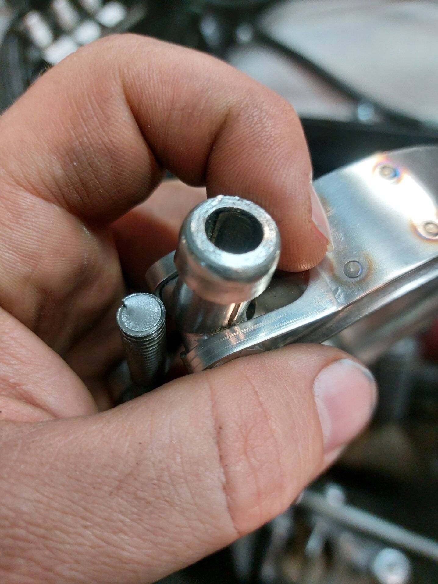

So here we are. broke a v band in the downpipe install, luckily I had a spare 2.5" clamp so it was a minor setback.
View attachment 197107 View attachment 197108
Removed the intake to run the ignition and injector lines, installed the head grounds and got everything in an torqued in place.
This is the final underhood for the night, only a few small things left to do. I also got the in tank fuel pump wired in and tested for function.
So I connected the laptop and checked all the sensors, updated firmware, and rolled the engine over.....

Tomorrow will be trans cooler and fuel system test. Then finish ECU wiring for the in cab stuff and a fire up hopefully.
The beast is alive.....
Idles at 650 also.... not bad for a 226/236 degree cam with 0.590" or so of lift...Nice chippy-chop!
