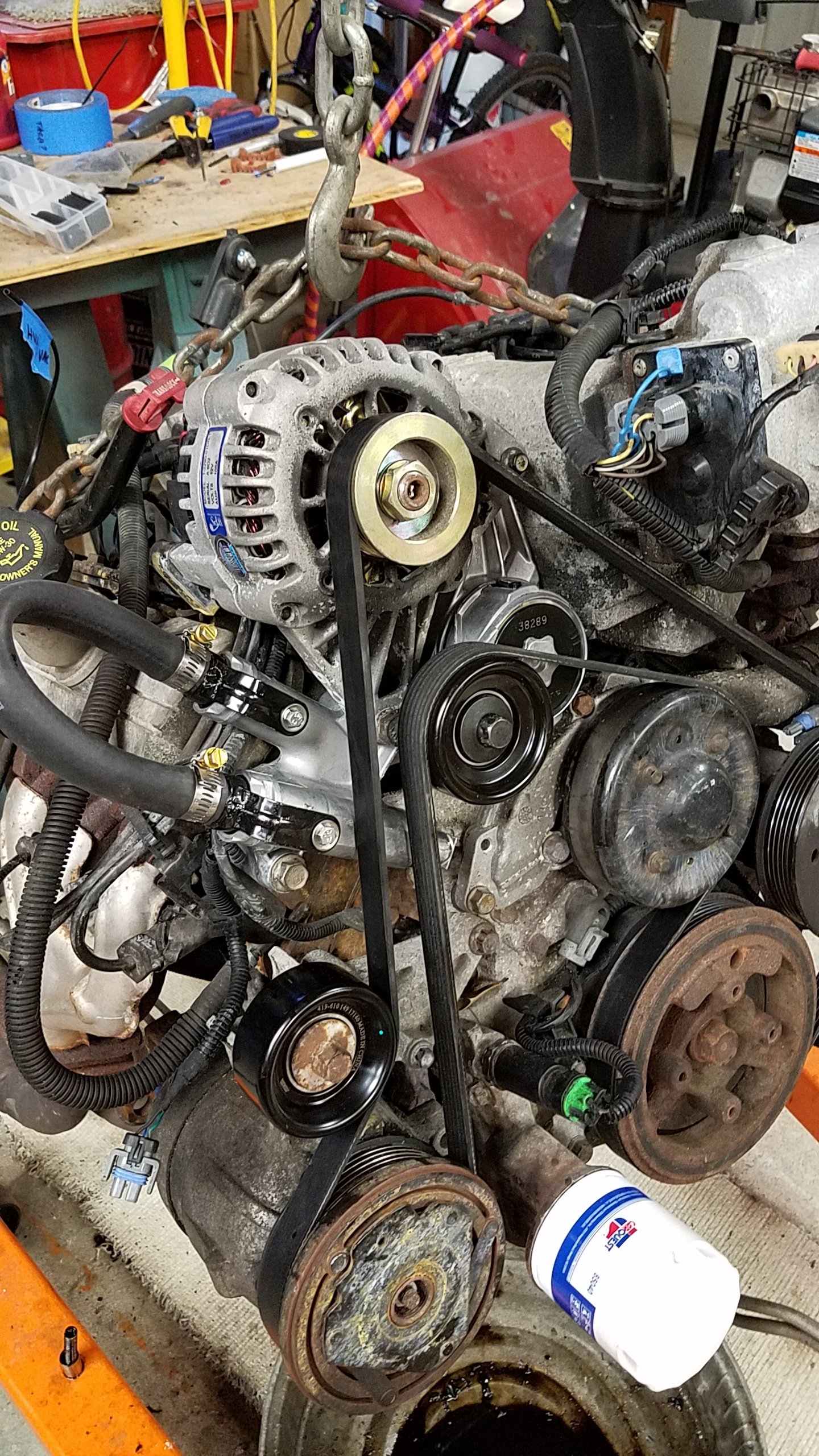

Then, on to the motor mounts where things got interesting....
I'm using the standard Anchor replacements. I don't even know if they'll work, but I have my fingers crossed.
The holes needed to be opened up on both. The driver side needs about 1/4" trimmed to clear the dipstick tube
The passenger side was more complex. There is a boss with 2 tapped holes that needs to be cut off
I wasn't comfortable grinding any further no knowing where water passages are. It's close but not perfect
HOWEVER, the engine mount wants to occupy the same space as the A/C compressor.
After a bunch of brain F-ing it, I finally figured it out. I rotated the bracket up as it pivoted on one of the bolts, then made a bracket to support the orphaned tab. I still need to fab a rear support. I rerouted the serpentine, and it actually needs to be shorter. I might not have quite enough wrap on the power steering pulley, but I'll deal with that later. It looks like the A/C compressor is going to be really tight to the control arm attaching point. I'm running with it for now.
