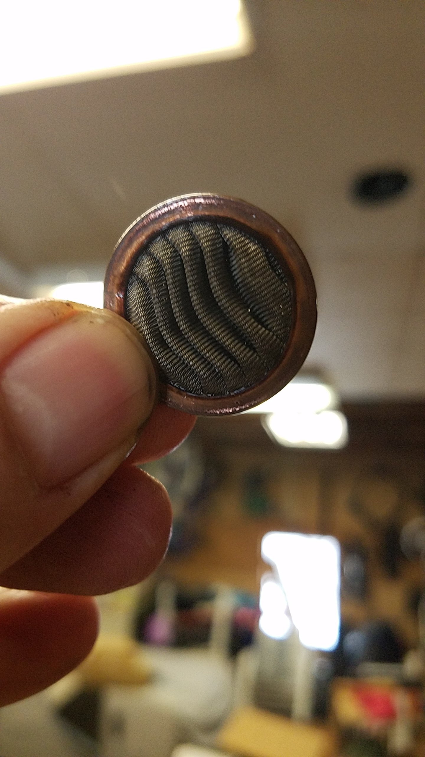

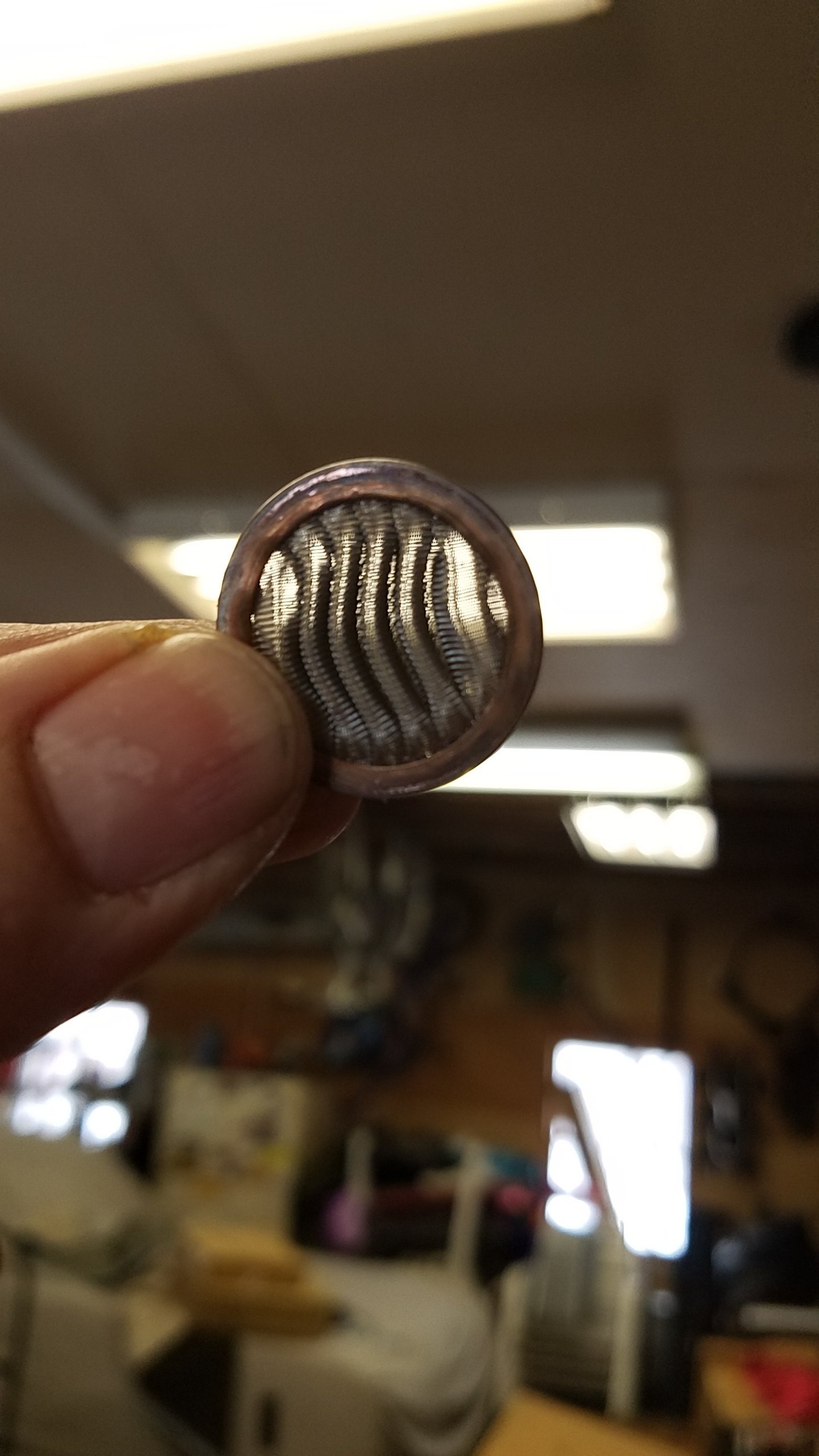

So, I am quickly learning how a clogged fuel filter can wreak havoc. I have a sneaky suspicion that it's the cause of all the random codes I get. This is the 3rd time I've had to clean it since completion. It's the same black dust everytime. Ethanol eating the rubber inside the AN hose? Or, residual dust from making the lines? The tank was pretty clean, the pump and sock were new, and I flushed the sender lines. :rant:
View attachment 103699View attachment 103700View attachment 103701
Seems like an awful lot for being left over from assembly
