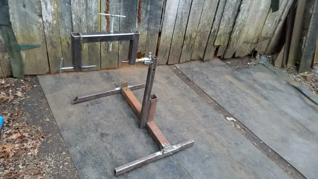

I looked for holding fixtures online and the only ones I found mounted to a work bench. At the present time I'm using the garage at my mom's house. It's pretty cluttered and there's not really a traditional work bench to mount the holding fixture to, so I built my own with a stand.
First thing you gotta have is a welder. I have a Hobart Handler 190 MIG welder. I really like it.
For the holding fixture and stand I used some 2'' tubing and a piece of 3" tubing that my dad had saved and was just sitting around for years. I figured I might as well put it to use. I bought some All-Thread and nuts to fit it and a couple pieces to make the pivot point.
These are the pieces I used for the pivot point. I can't remember what they're called.
I don't have a chop saw to cut metal right now so I had to use what I do have, a Sawzall. If you take your time and cut slow, it works pretty well. Measure twice, cut once and weld it together.
The fixture with the stand.
Then Primer.
Then Paint.
Then Primer.
Then Paint.
