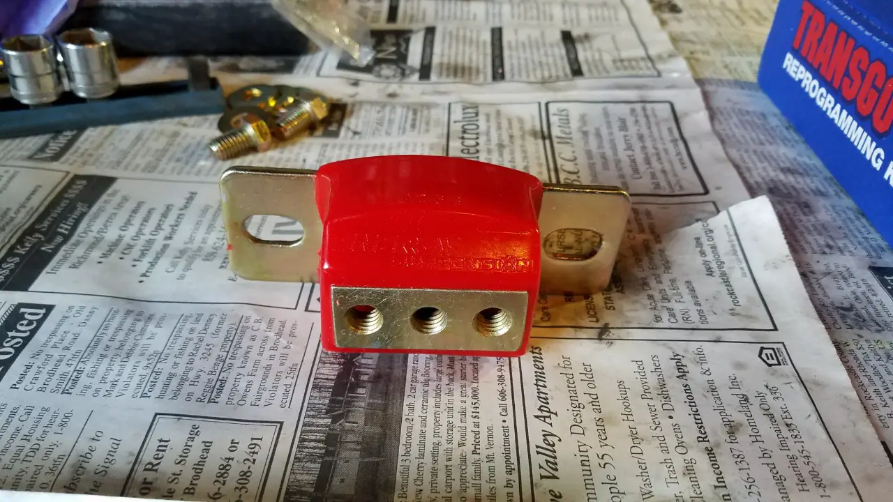

The poly transmission mount.

Any particular reason for the poly transmission mount?
Reactions: Opie Knievel
Do you or did you have a broken motor mount?
As far as I know, I don't. I haven't driven the car in months and I haven't been messing with it since I parked it when the transmission went out. I'll check it out before I start driving it again.
I do not like using poly or solid trans mounts.
Aluminum case VS. steel X-member
Steel X-member is going to win that fight.
I rather replace a 10 dollar rubber mount than my trannys case.
Reactions: pmoore4321
I'm hoping I don't have that problem. I guess I'll find out.
If you keep breaking trans mounts there is a problem.
That poly mount will make it worse since the rubber mount will no longer be the weak link.
Something somewhere will have to give.
