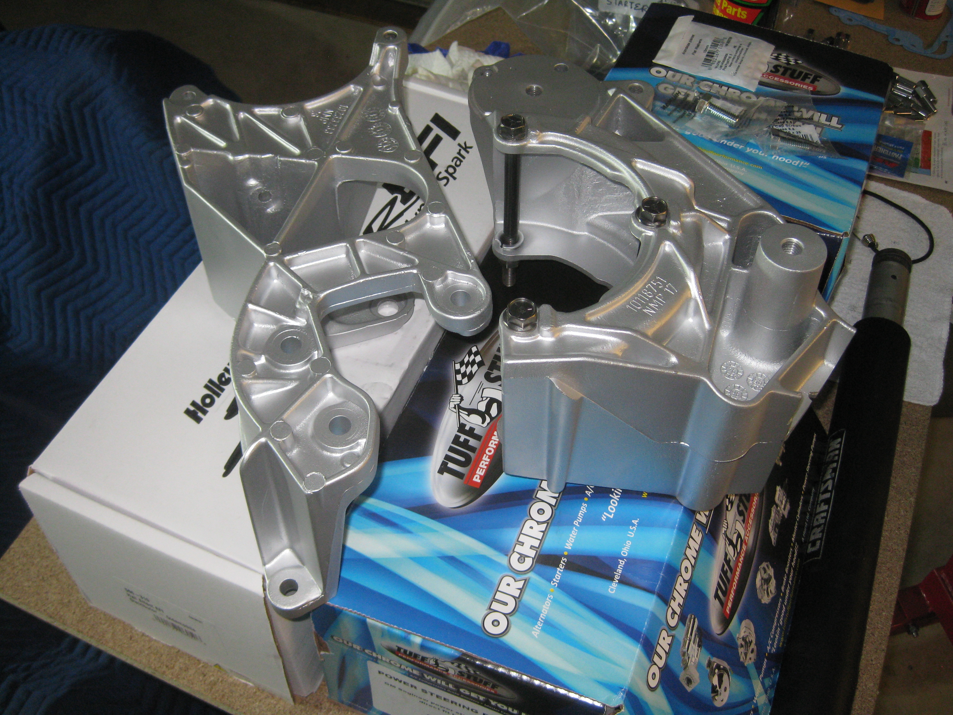

Tuff Stuff Saginaw power steering pump in black powder coat, I have a new Dorman serpentine pulley to go with this.
Matching Tuff Stuff 160 amp alternator. Powder coated black with polished serpentine pulley, fan, and nose cone.
I have all the mounting hardware cleaned up and ready for paint.

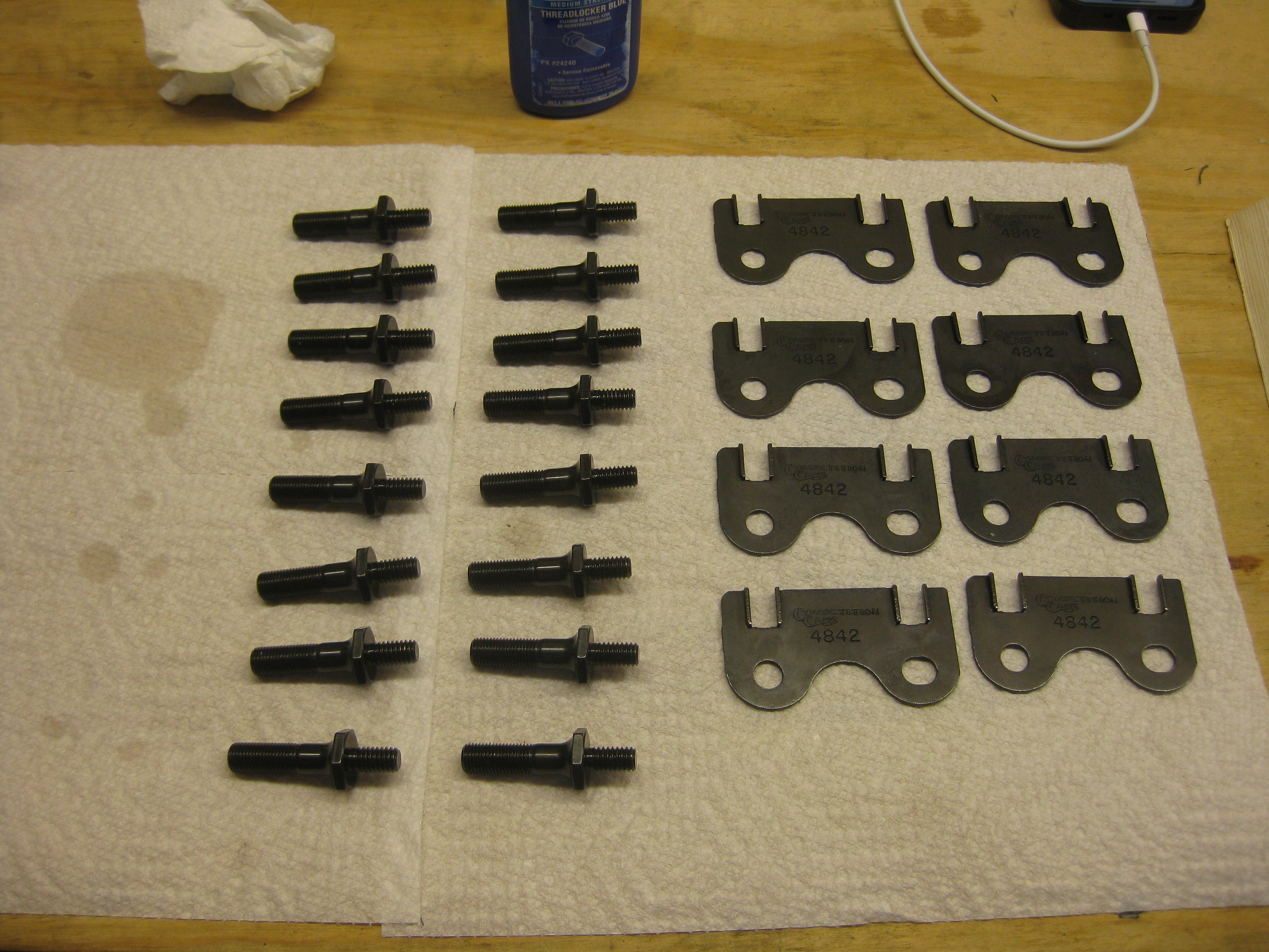

ARP screw in studs & Comp Cams guide plates are installed.

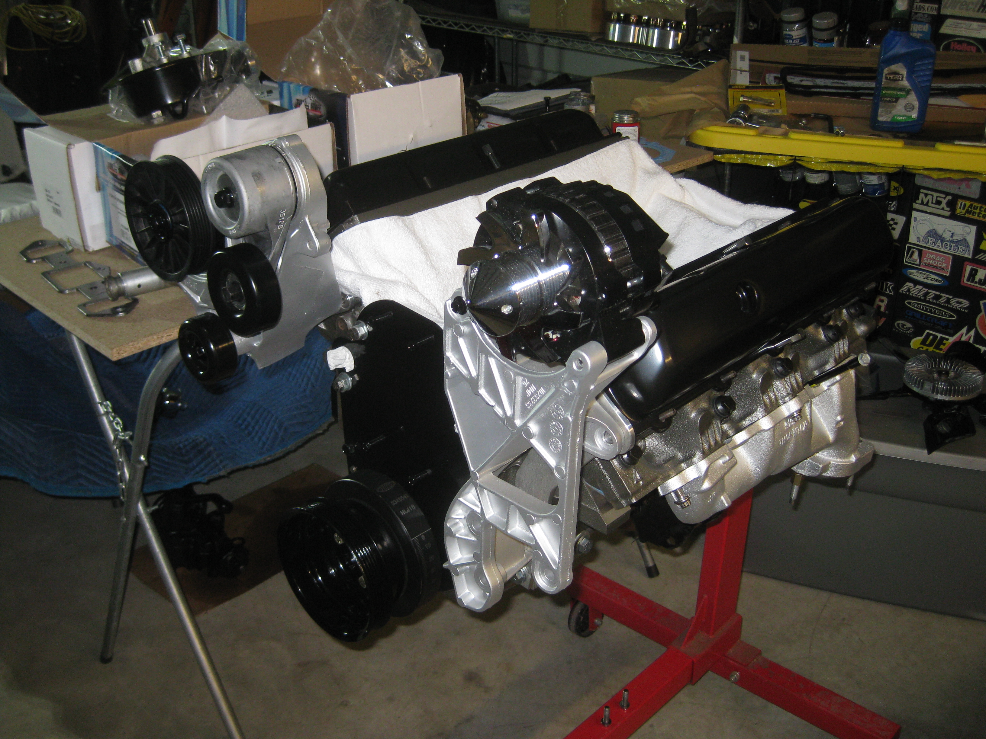

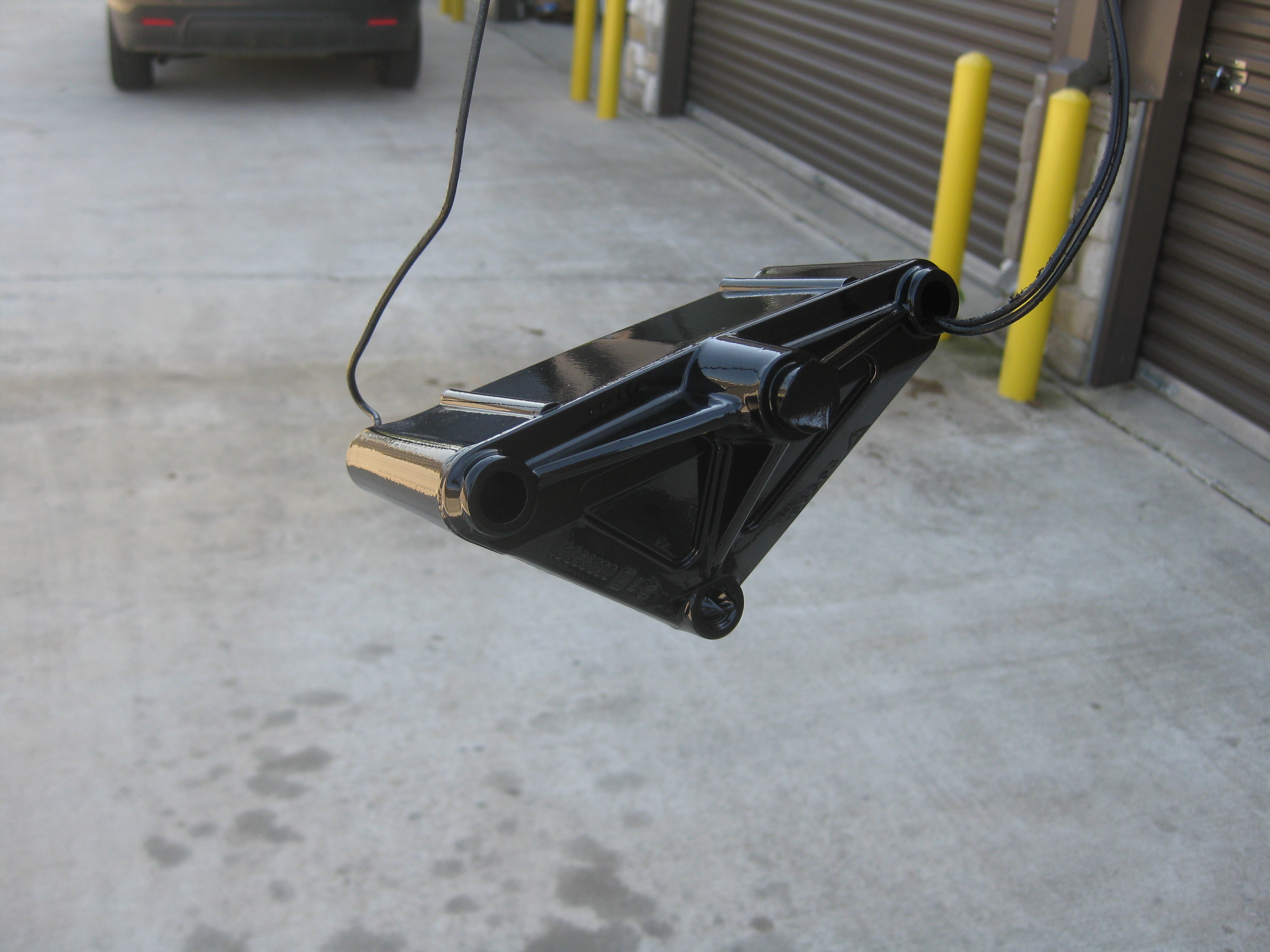

The serpentine adapter plates ( 1992 Chevy Truck ) are back from the coating shop. I got a new Gates Idler Pulley, and Belt Tensioner. The exhaust manifolds are installed. New motor mounts are installed. I got a new dipstick tube from Inline Tube.

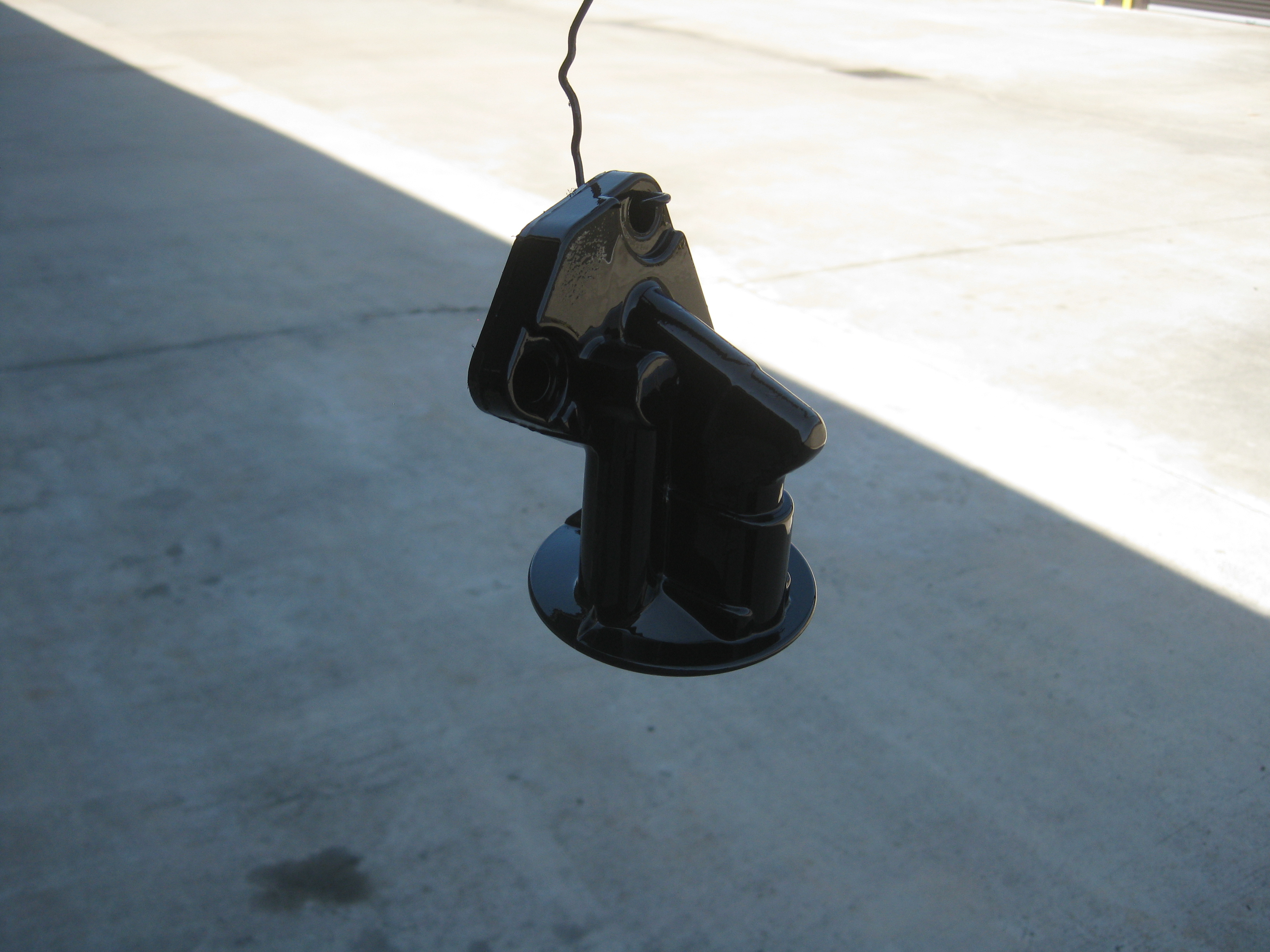

Oil filter adapter & A/C delete are painted and installed. I will have A/C, but this will get the motor running, cam broke in, and leak checked. Then I will worry about A/C.
Pulley removed for paint. This bolts in place of the A/C compressor.
