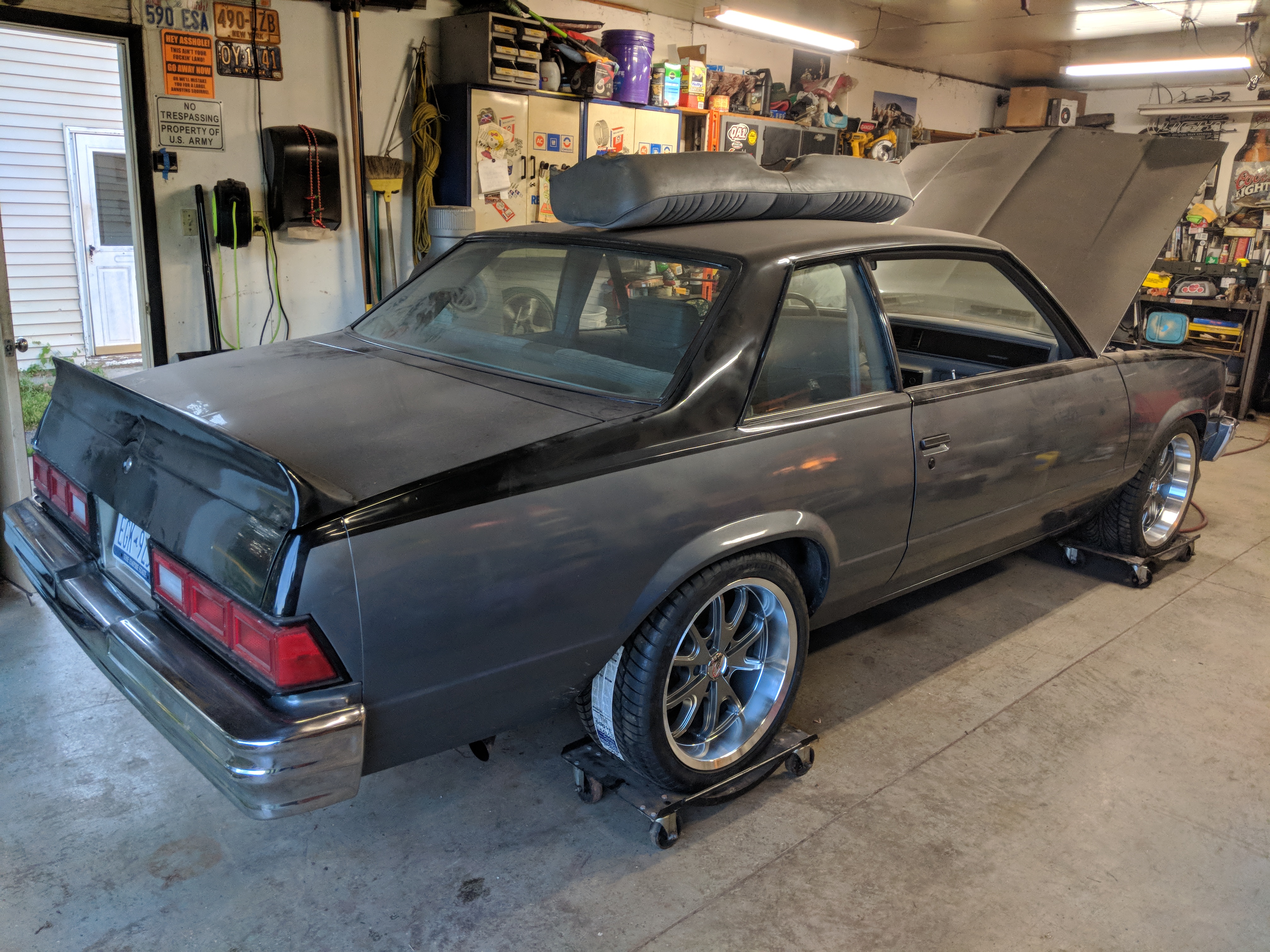

Along with Driven, the Malibu looks killer with the stance and I think those wheels set it off!!!
