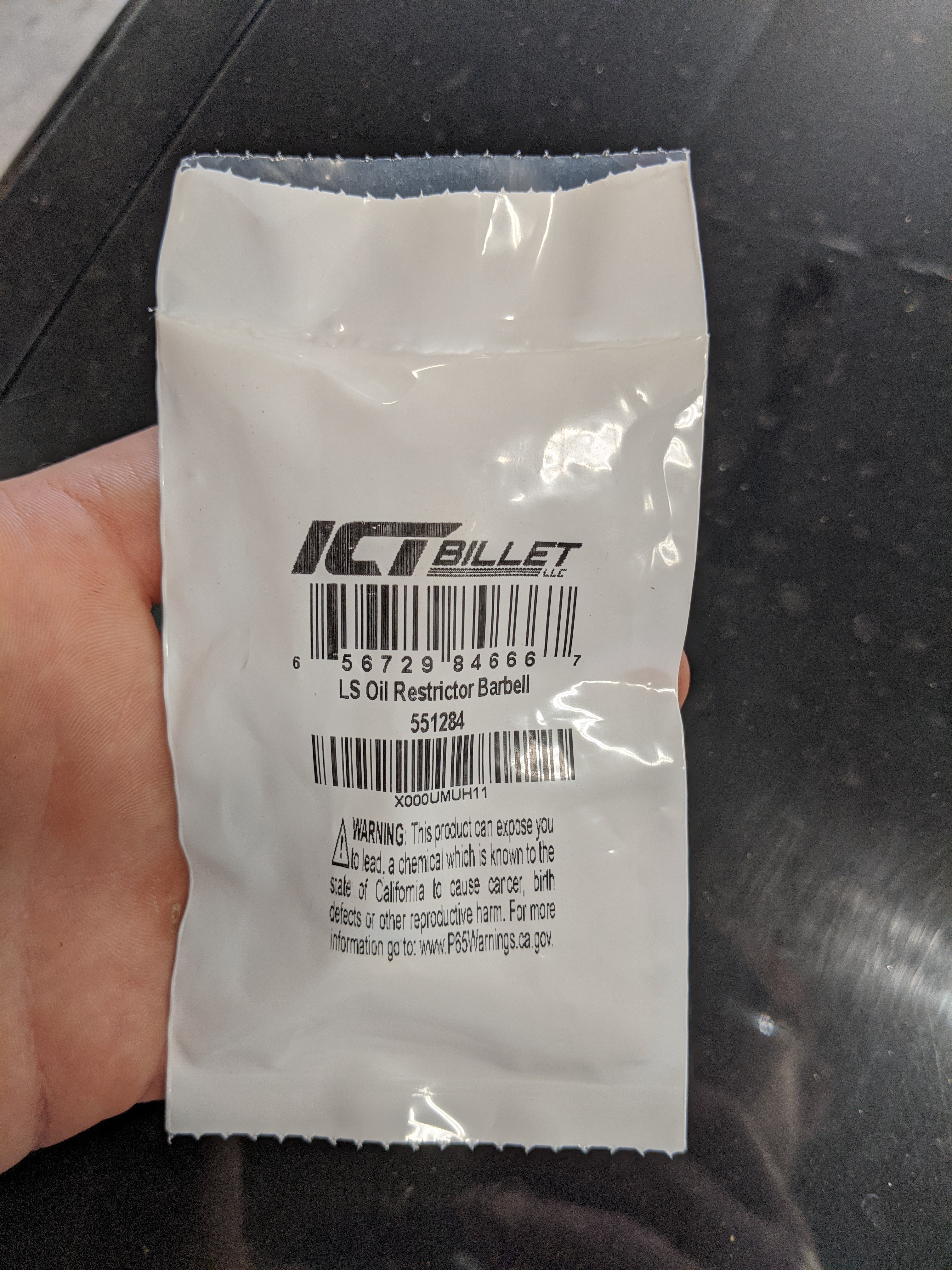

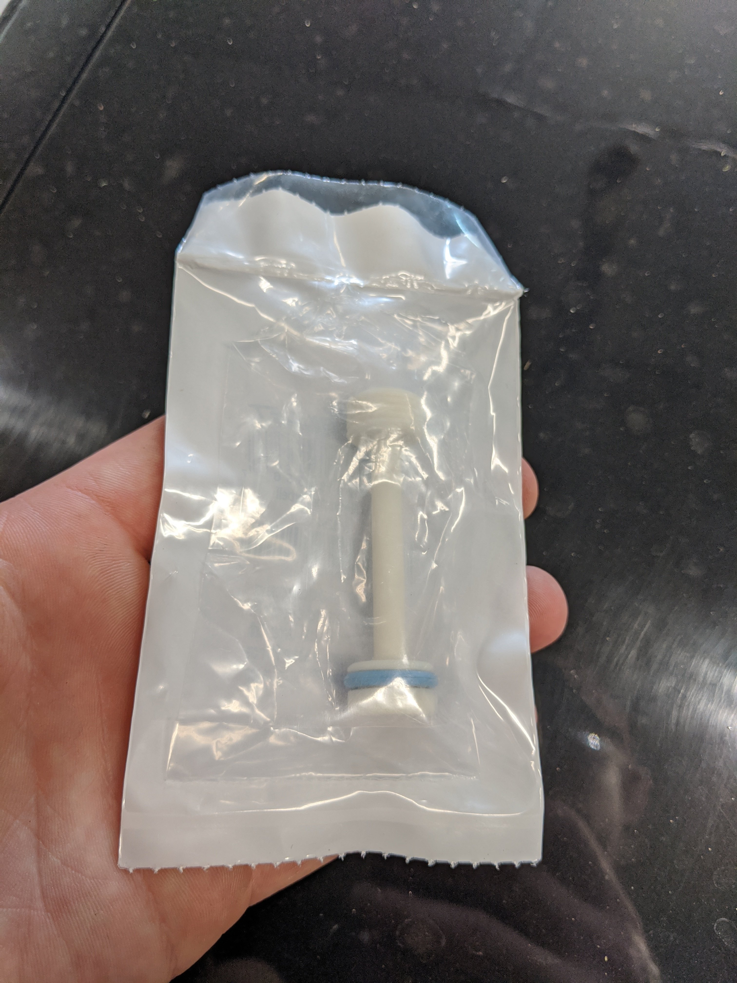

Was cruising forums and found where people mention to make sure to check the oil barbell in LS motors. Huh? Never heard of her. Figured out where it was finally, then ordered one off Amazon from ICT Billet. Figure it won't hurt and for $12, how can you go wrong?
