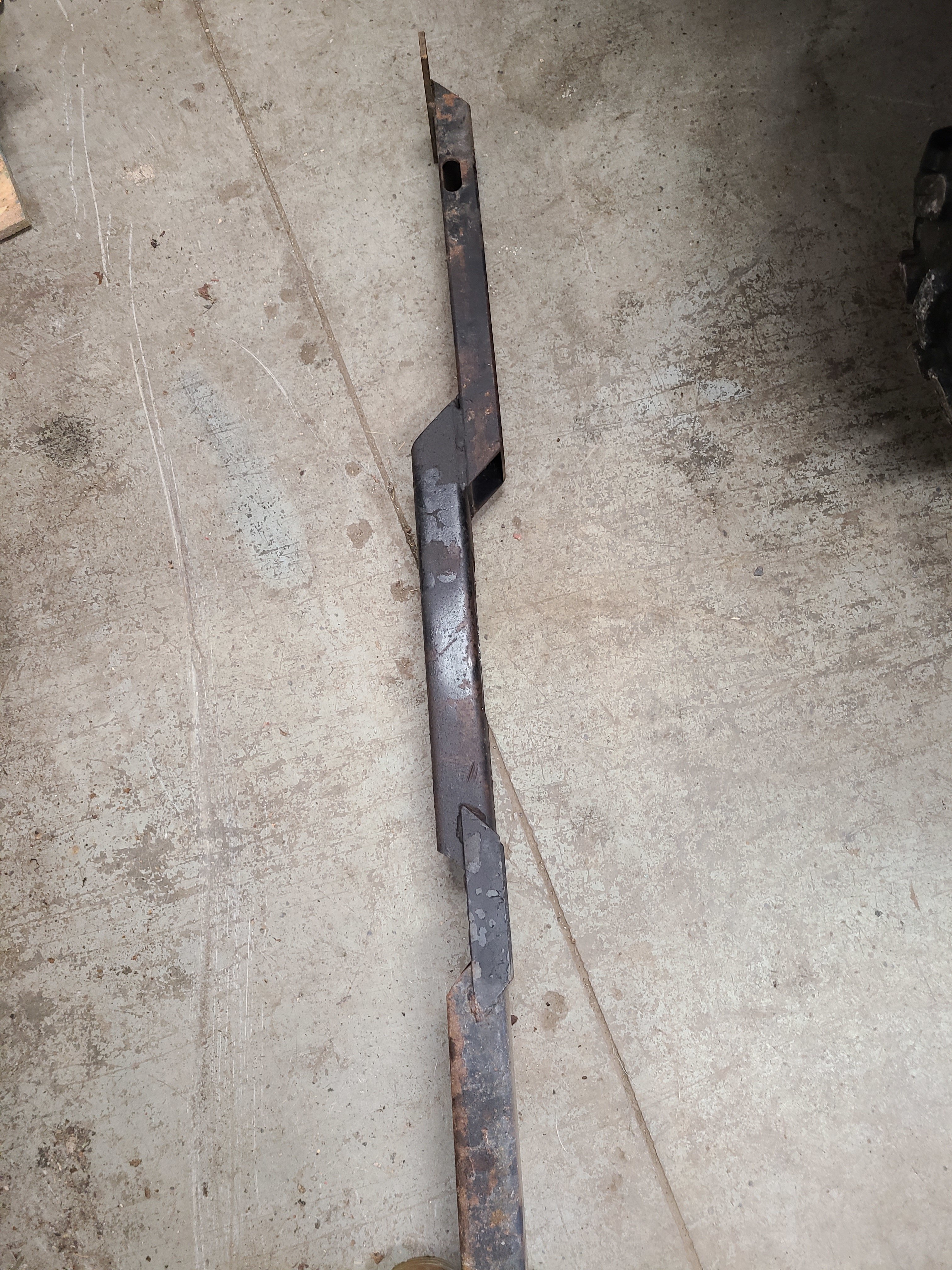

In other news I got my old Muncie M21 out along with the MTS crossmember. Those of you that have been in the G body game long enough might remember them. They specialized in Cadillac 472 and 500 swap parts. They also were one of the first to offer a double hump crossmember. To say it's heavy duty is an understatement. LOL
You can see the fabricated spacer that moves the shifter out away from the tailshaft. That allows you to use straight threaded rod and rod ends on the linkage. Amazingly tight shifter feel.

Ahh, now I remember who it was that I got my original double hump crossmember from. Nice piece but not really crazy about how they set them up to mount to the frame. Still have it out in the garage.

Once upon a time I had one of those xmembers... no clue for the life of me where it's gotten to these days, done recall seeing it when we packed up the shop and barn I to containers for storage.
