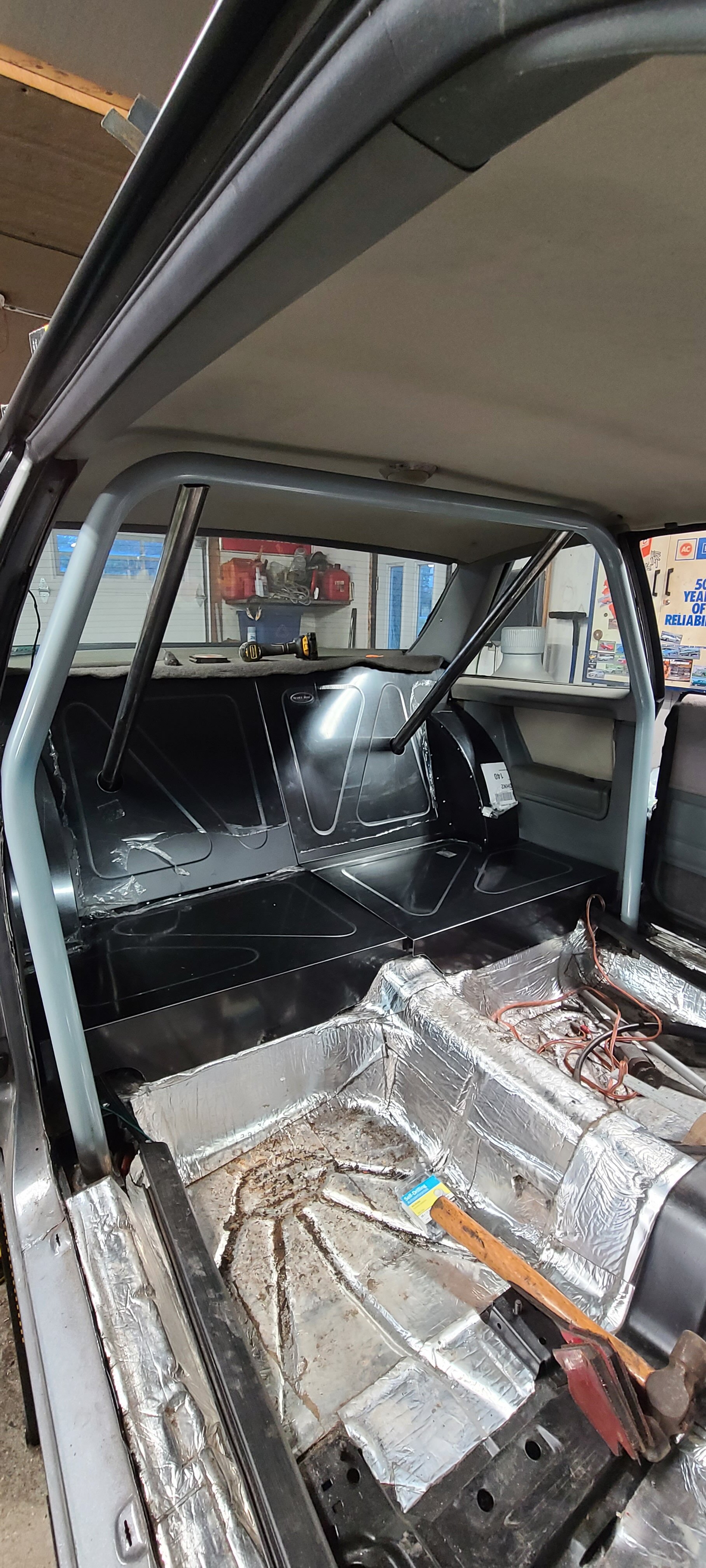

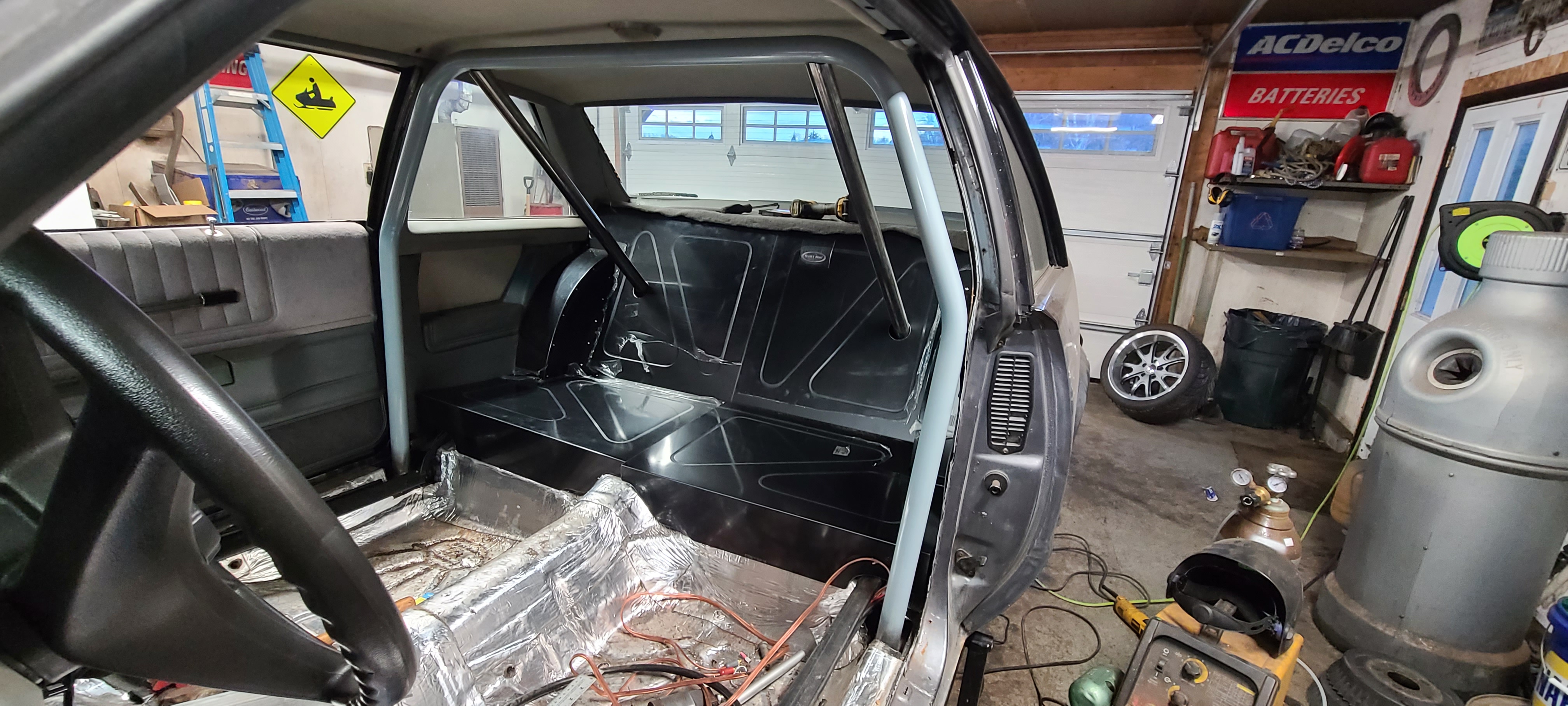

I had looked around for a rear seat delete kit, and found the one available from Scott Rod Fab. Looks great but wanted something sooner. They are currently 3 months out. Since I have all sorts of metalworking equipment available at my work, I was just going to order a sheet of aluminum and make it myself. Long story short, no one had a sheet locally, shipping and palletizing fee made it not economical to get one. So I contacted Scott Rod and they happened to have a kit in stock and could ship the same day.
Took several hours of trimming and fitting, but fits pretty damn good. Better to go slow and make make small cuts, than one big one and regret it when it's too much... I still have to weld the down bars in place. Want to make some escutcheon washers to cover the holes where the bars go thru. Of course I drilled them off just a bit and my OCD can't handle seeing the down bars off center in the holes. Main hoop is welded in though.

The roll cage and rear seat delete is looking very clean. Nice work.

Love those closeout panels!
Thank you!
