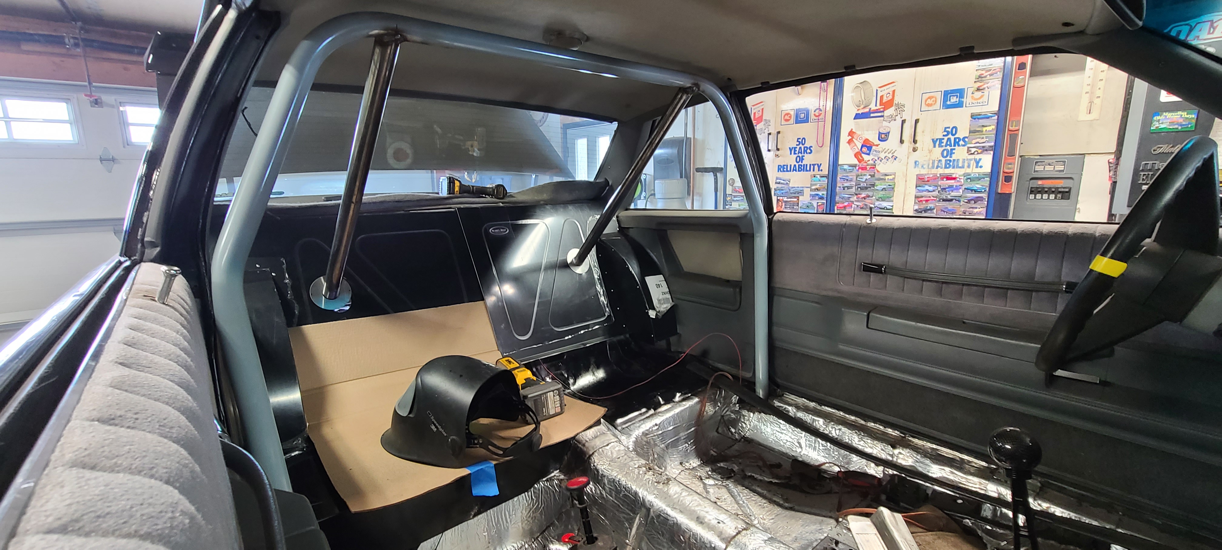

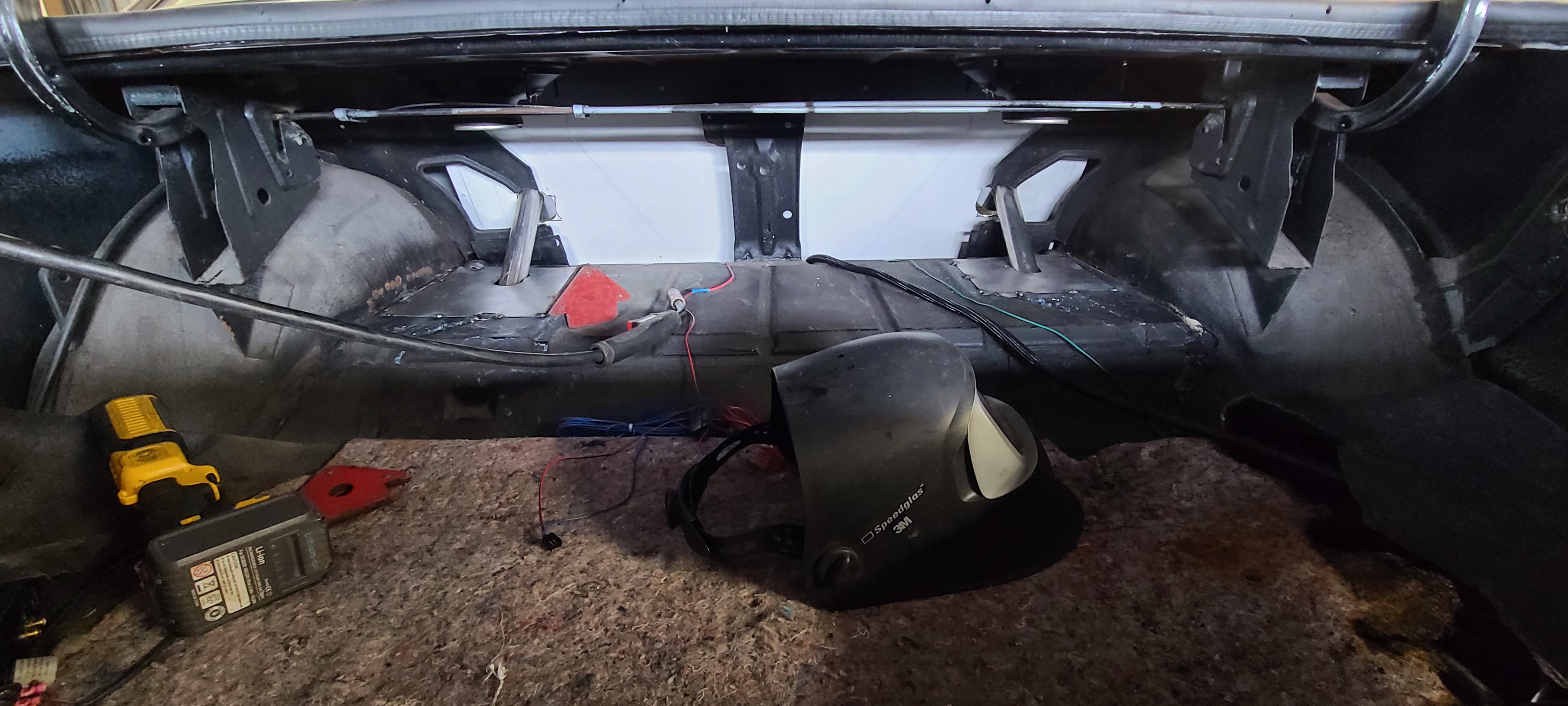

Finally
Fully welded in. Now I can focus on finishing the pieces to fill in around the body where the main hoop goes thru, and patch the floor where the old shifter hole was. I'll need to install one of the seats to get the proper height for the cross bar, then I can notch that and weld it in. Then I can reassemble the interior...

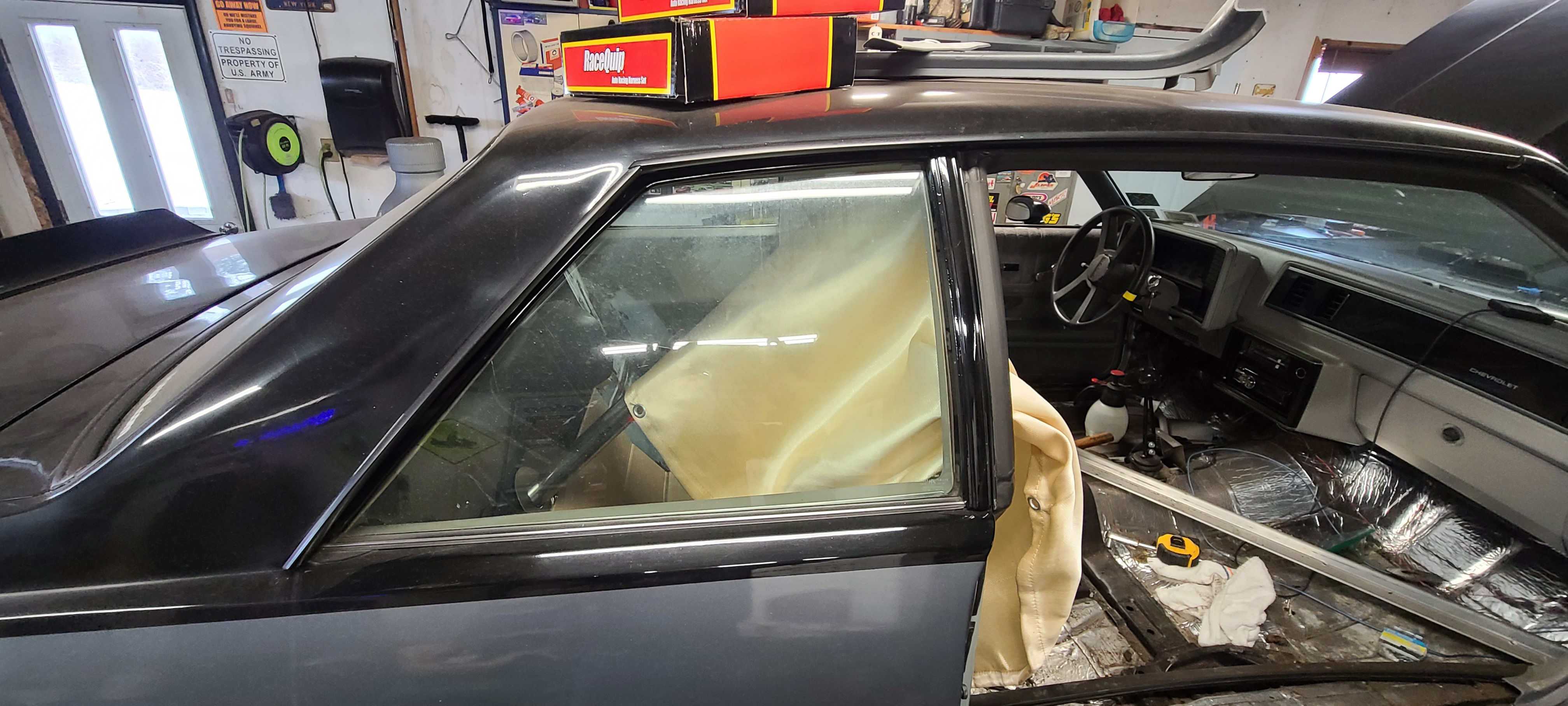

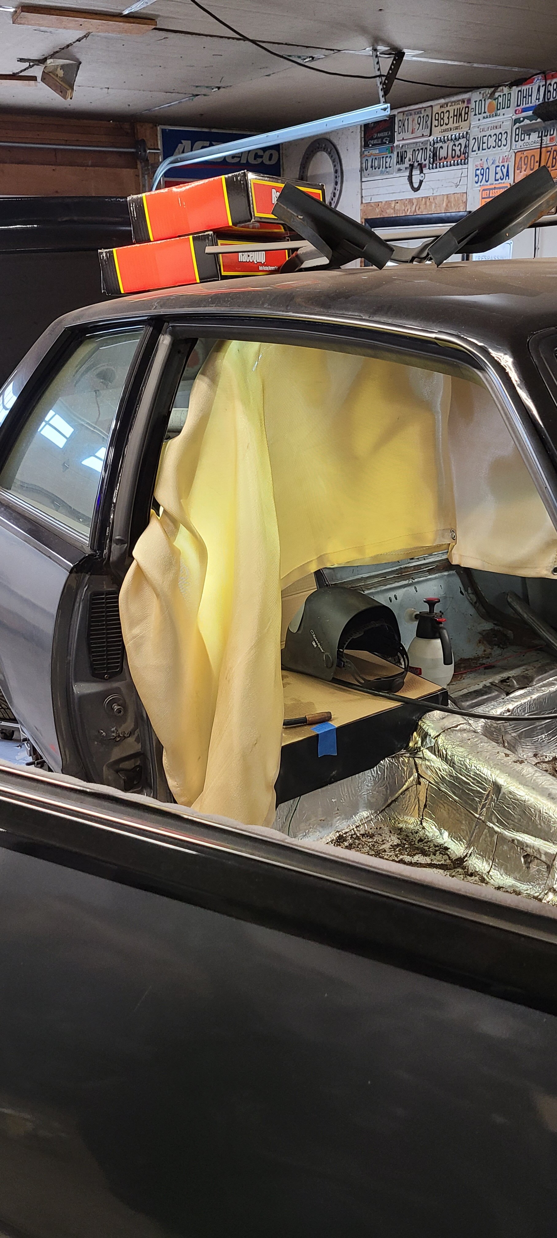

Oh and 64nailhead the Harbor Freight welding blanket works great 👍

Awesome progress. You do nice work sir!
Thank you! Took me much longer than I anticipated, trying to get five things all lined up, while simultaneously holding them can be tricky LOL I marked the main hoop, and the plate above the spring with the location of the down bar. But it had to pass thru the back seat delete kit, and thru the sheet metal patch in the trunk above the spring getting each one individually wasn't too bad. But this morning when I thought I was good to go to start welding everything in, realized they were both off just a touch. Plus I had to hold them out of the way to weld the rear of the down bar. Not going to lie, I was a little overwhelmed for about 30 minutes.
