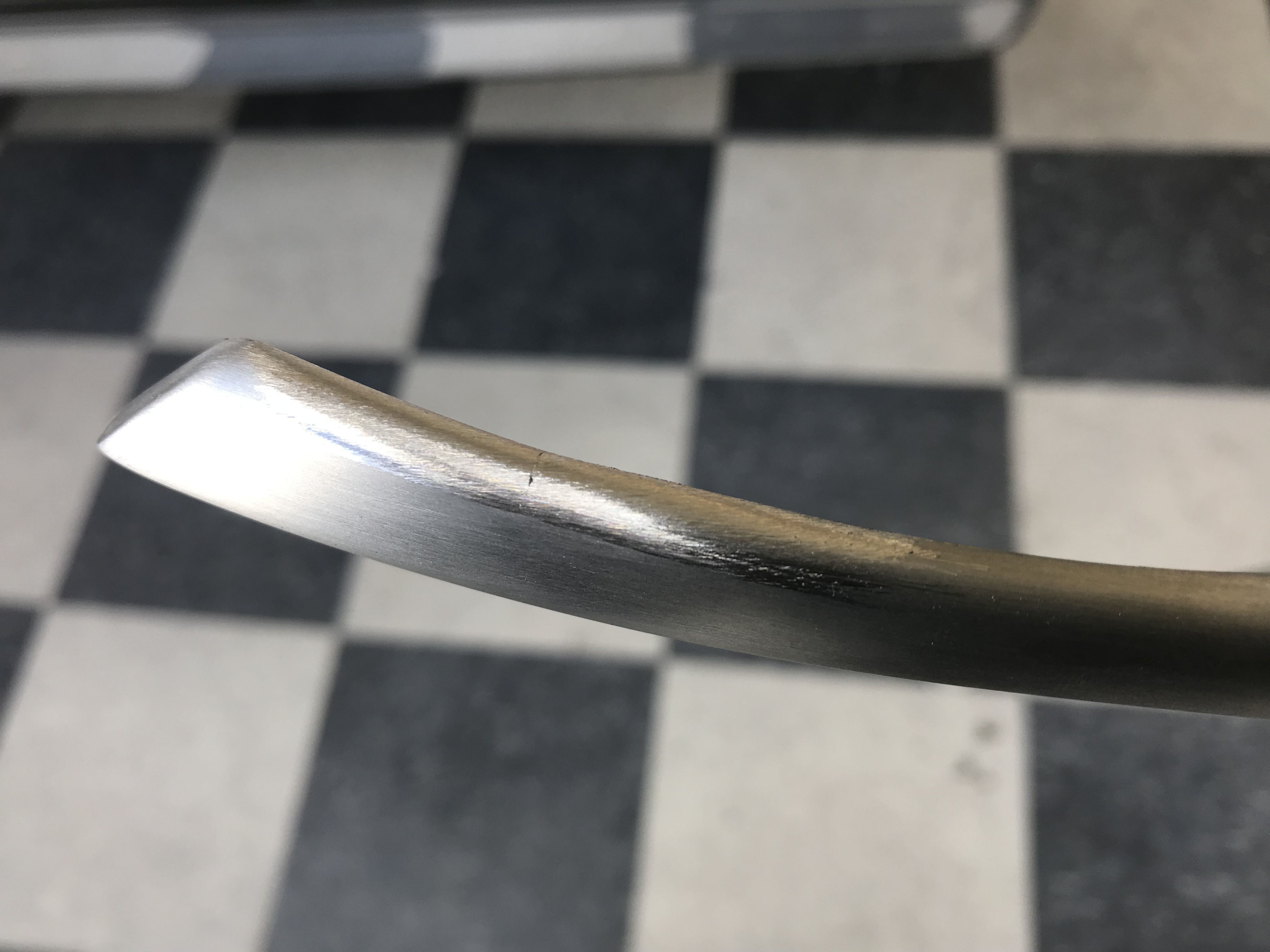

Let’s start with the ugly first. Turns out, to my surprise and probably everyone else’s, the trim mouldings on our cars are NOT aluminum as I thought. When the welder went to repair the driver’s side belt moulding, he found that he couldn’t even strike an arc. He tried several times and even got his boss involved, but to no avail.
Here’s where he tried on the sacrificial piece I gave him, it wouldn’t weld, it just burned and cracked immediately:

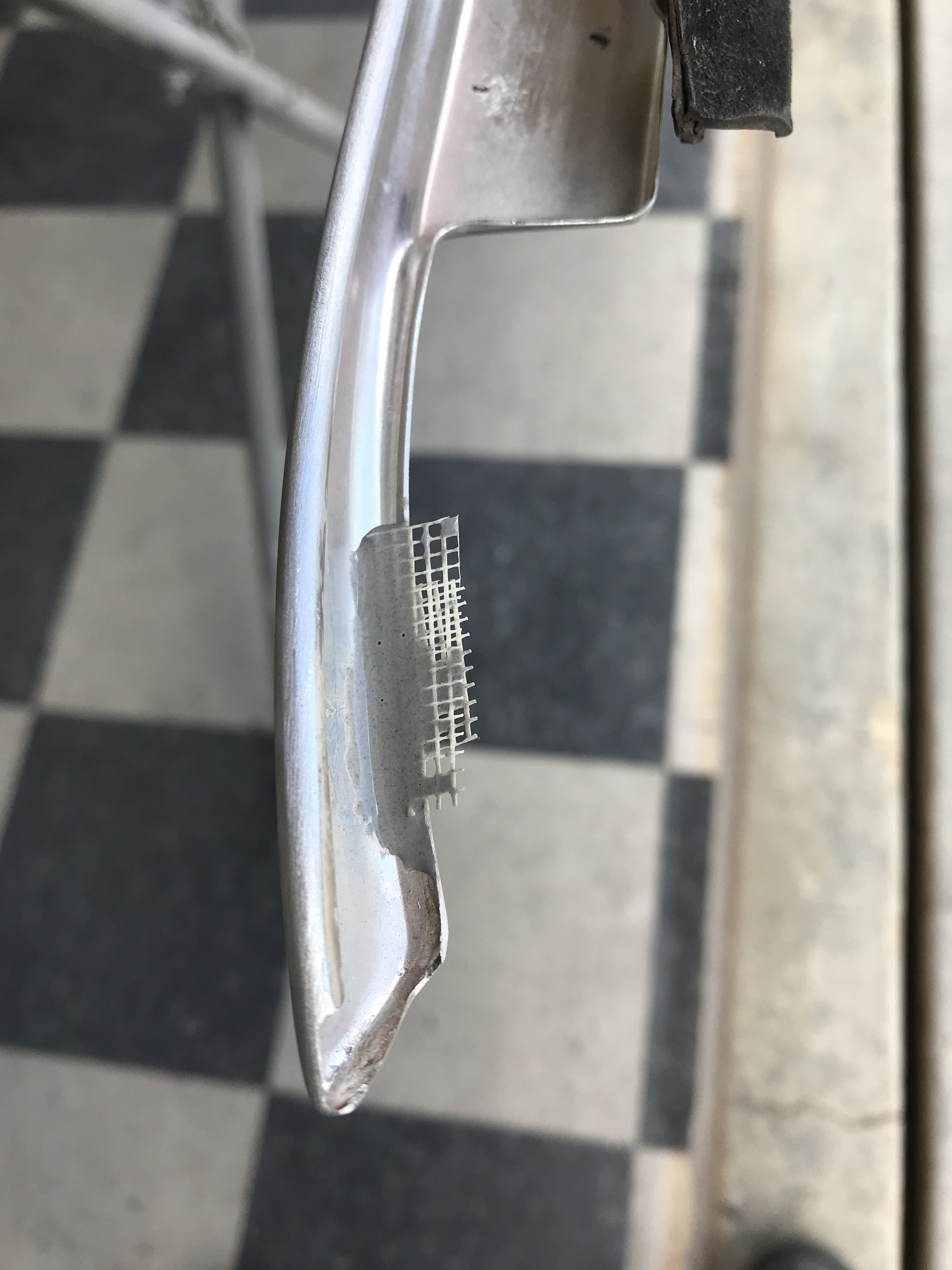

What we came up with was to use some good ‘ol JB Weld on the backside, along with some fibreglass reinforcing mesh for strength.
First, I cut off the attaching tab that I’m pretty sure was compounding the problem. It’s visible as the blurry thing in the foreground in this underside picture:
With the tab outta the way, I was able to better realign the two halves of the crack, and straighten out the edges. I ran a fine file over the faces and got it looking pretty good:
With that done, I very lightly ground the backside to provide some tooth for the repair to stick to:
The rest of the repair went exactly as you’d think, I just mixed up a small amount and applied it along with two strips of reinforcing mesh, one shorter one underneath, and one longer one over top:

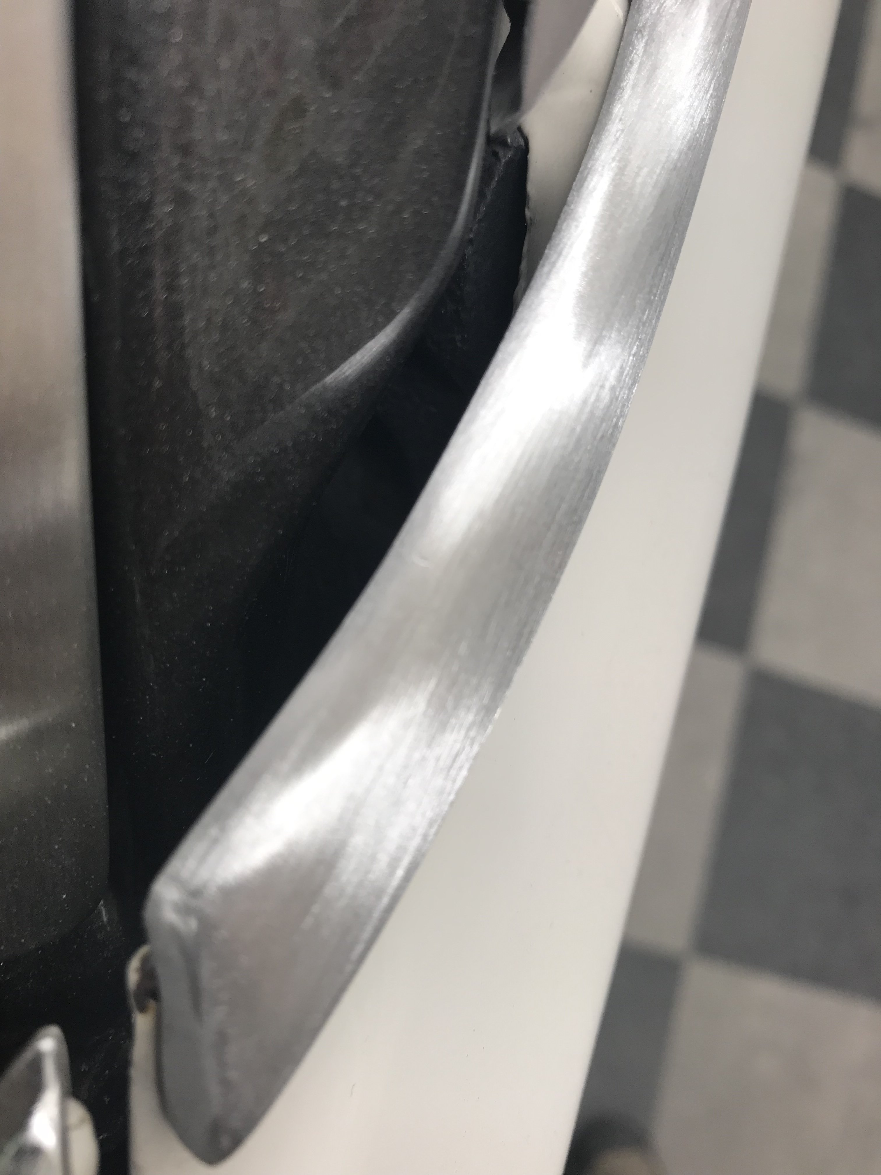

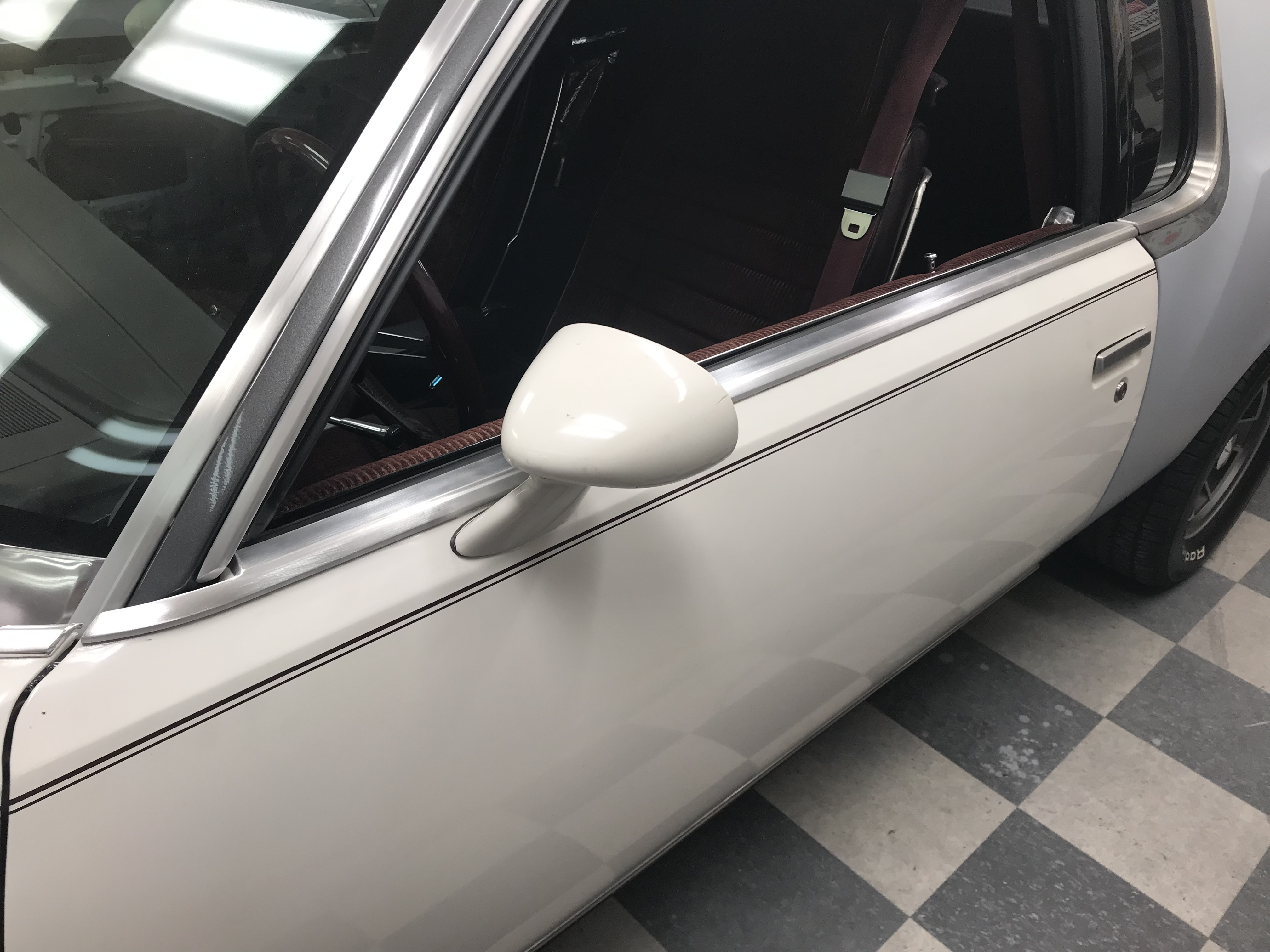

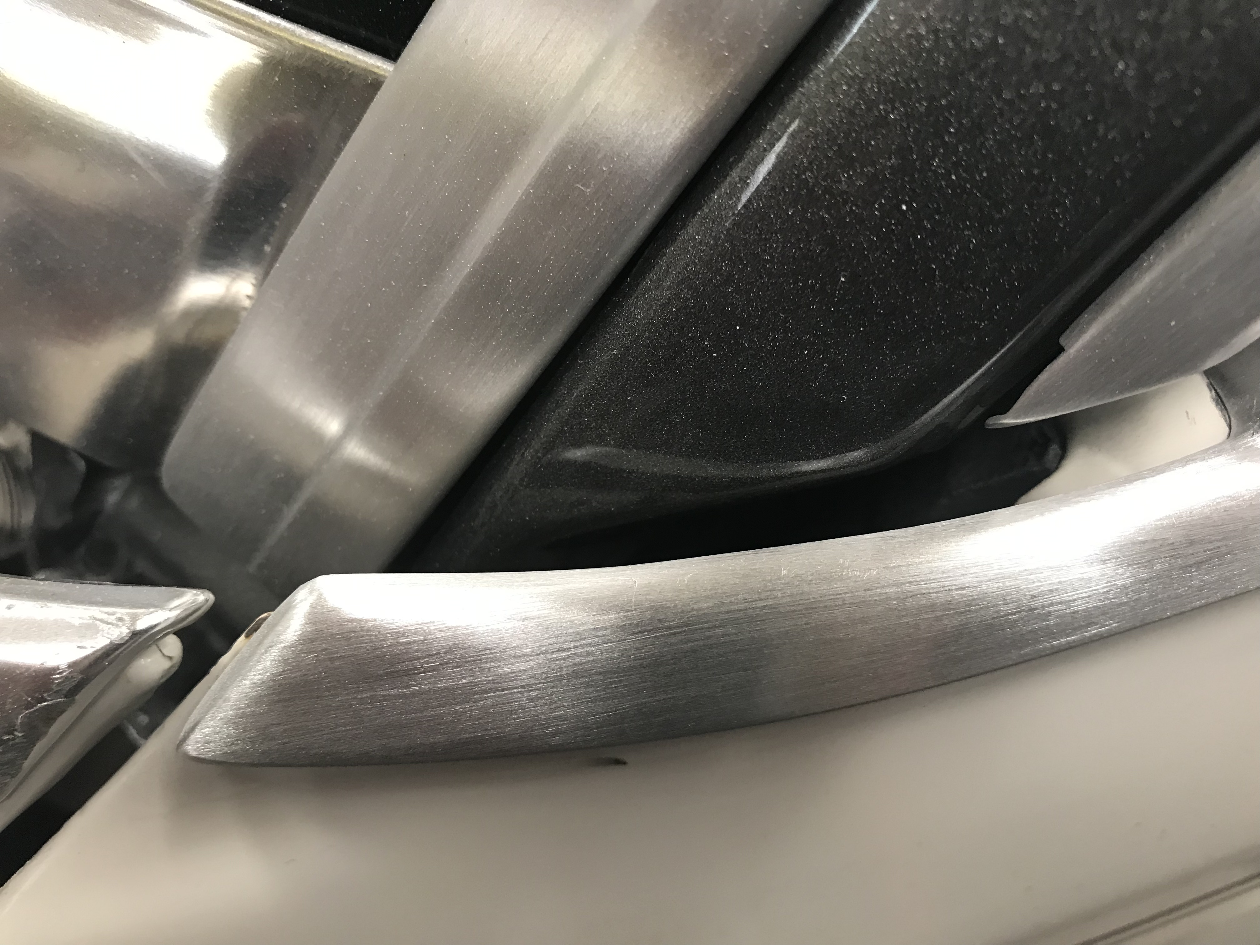

After letting it cure overnight, today I trimmed off the excess and filed the edge down again. It’s invisible from the outside. I then lightly sanded the outer face again, and test fit it on the car. Houston, I believe we have a winner.
Here it is mocked back up on the car after the repair:
Structurally, it seems very strong, and the deletion of the nearby tab doesn’t seem to have affected it at all.
Cosmetically, the crack is back to being nearly invisible again, it’s more like the hairline crack I started with. It’s still visible in certain conditions and angles, but I honestly think 99+ percent of folks out there aren’t ever going to notice it.
What do you guys think? For a nearly free repair, I’ll take it.

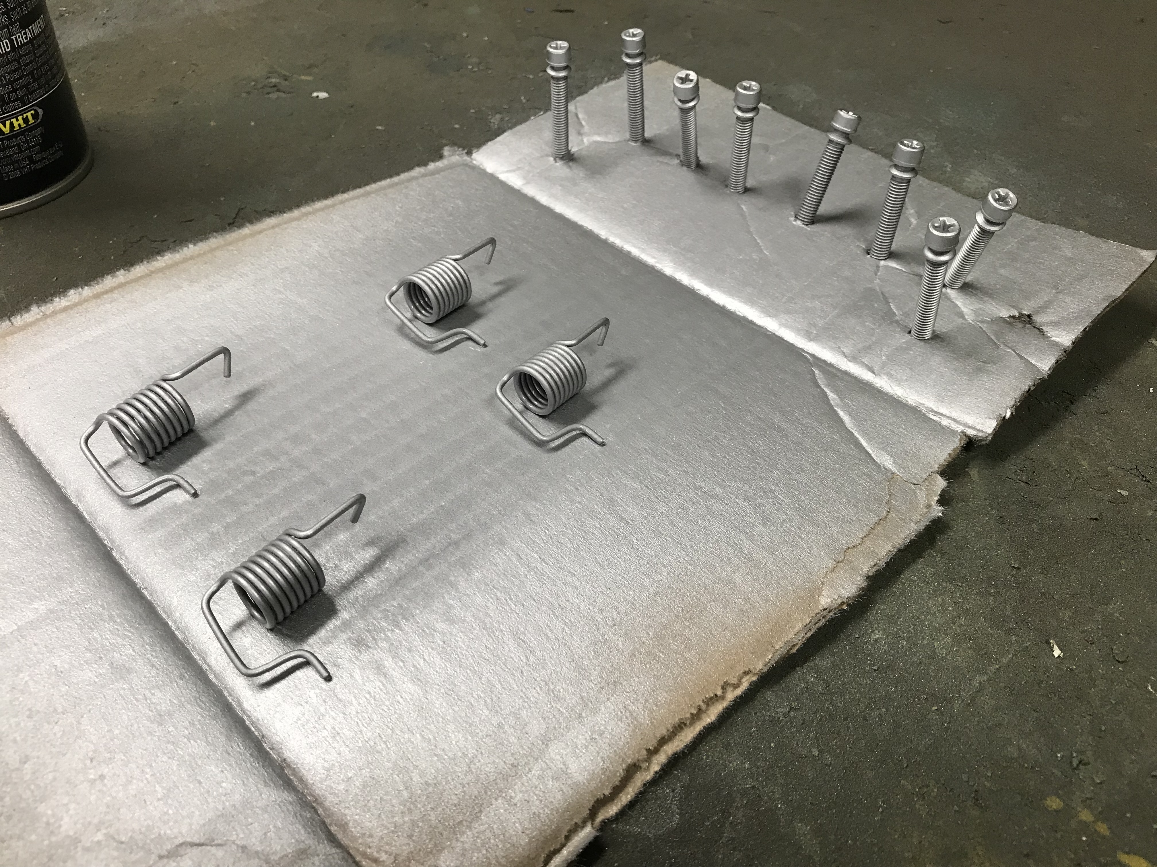

It’s sure nice having access to the right tools for the job. Speaking of which, I’d be a fool not to make good use of the quarter size paint booth we’ve got while I was there, so all the freshly blasted parts got shot immediately afterwards.
Buckets and most hardware went satin black, aiming screws and springs went flat aluminum:

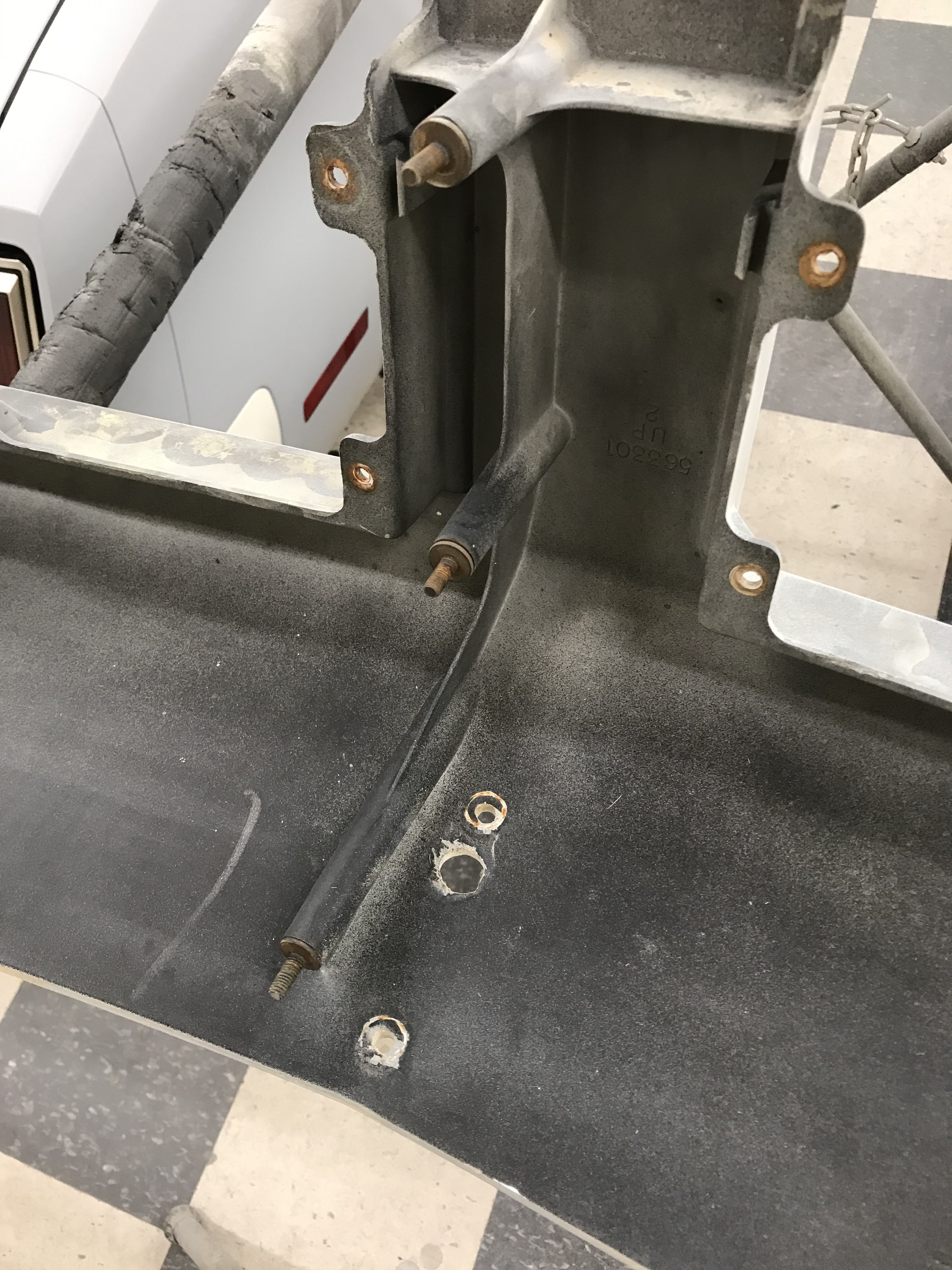

Also this week, I got to work on deleting the holes for the hood ornament in the header panel now that it’s stripped.
The underside before I started...
...then remove the old paint and bevel the holes:

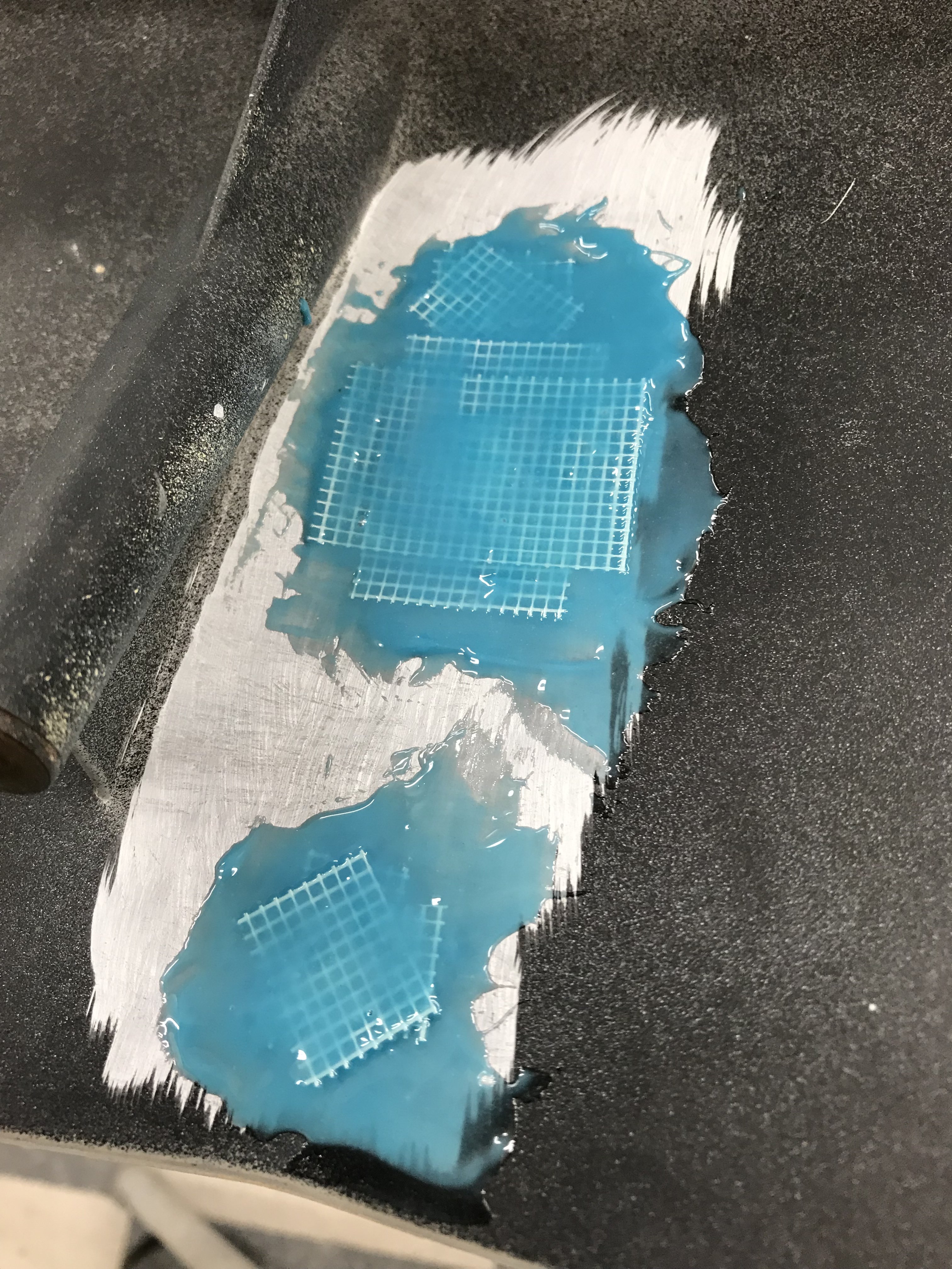

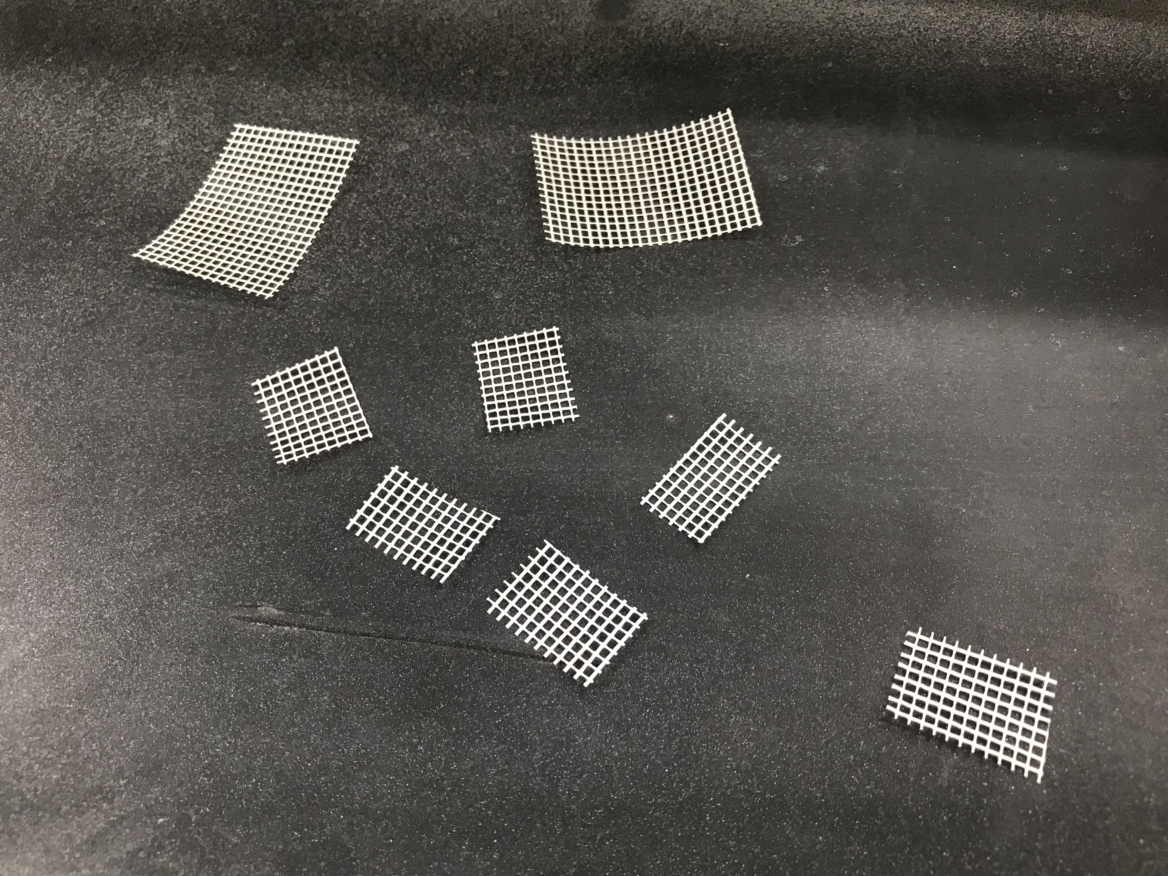

Roll out the fibreglass reinforcing mesh...
...and cut a bunch of small pieces to fill in the holes:
Gluing them in with some 3M Rigid Parts Repair...
...then made sure they were saturated and submerged in the compound with a light skim coat over top:

First off, great repair. The brushed look makes it damn near invisible (and that's with me knowing where to look). To the rando looky loo it's mint.
