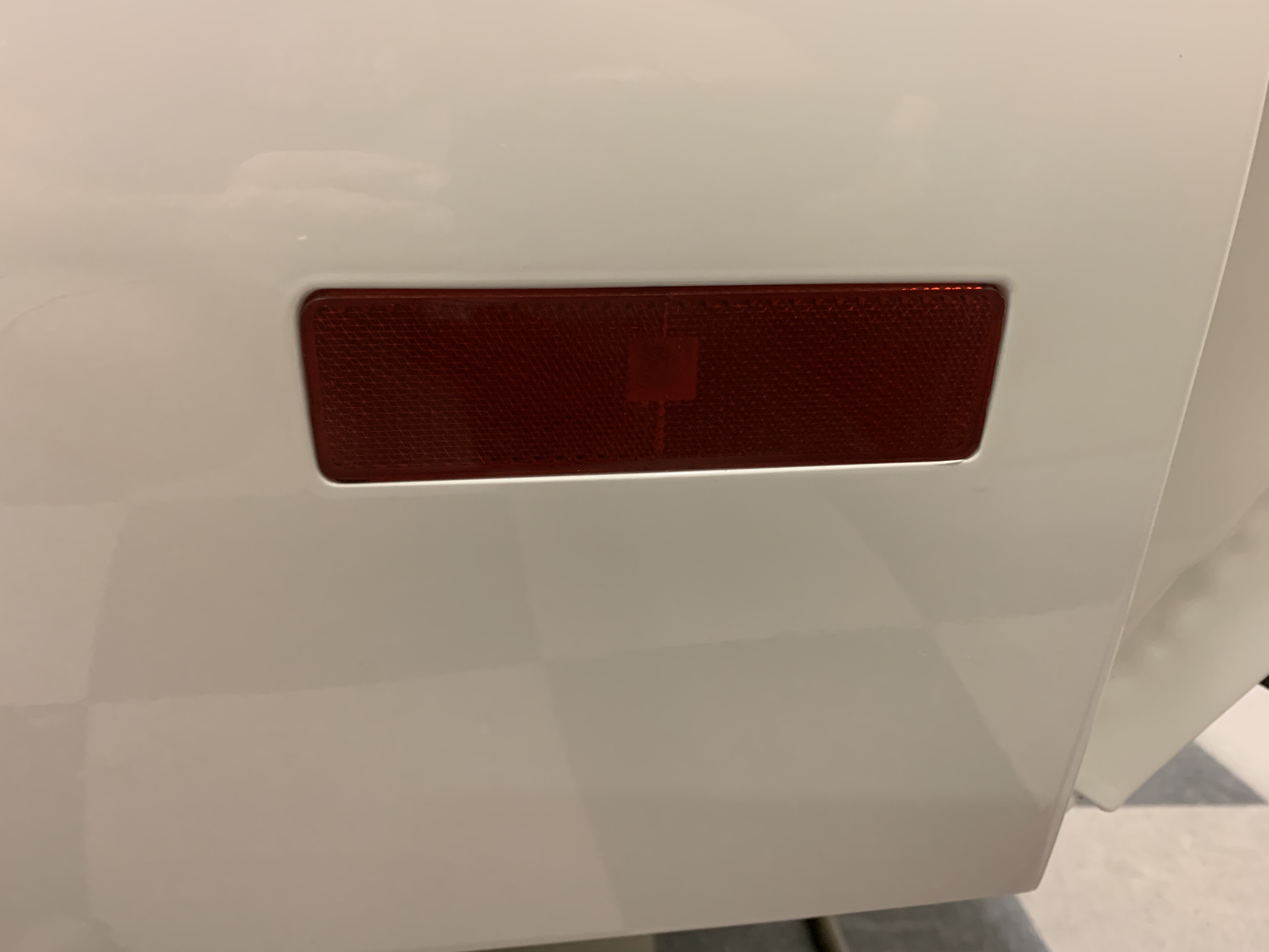

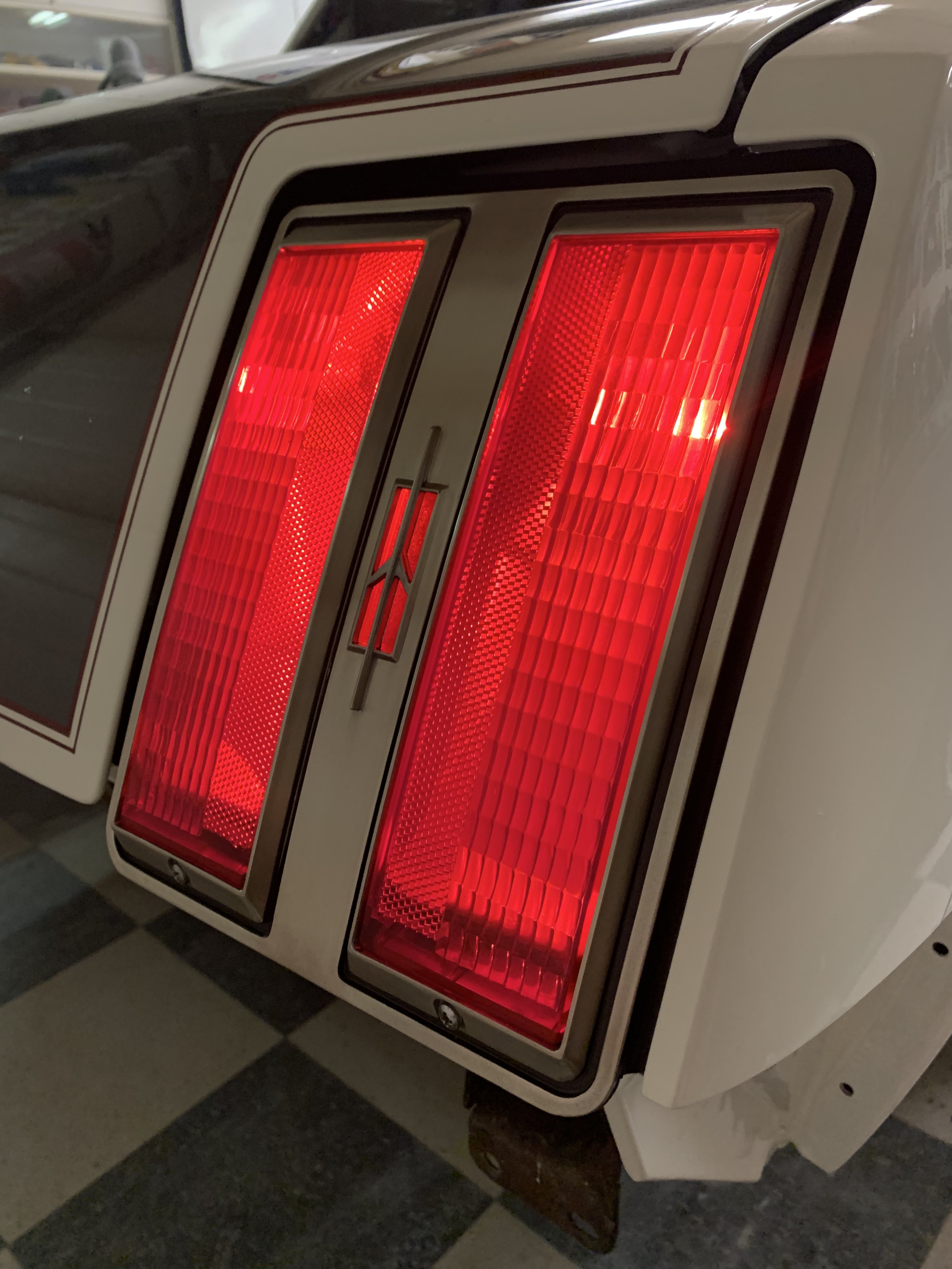

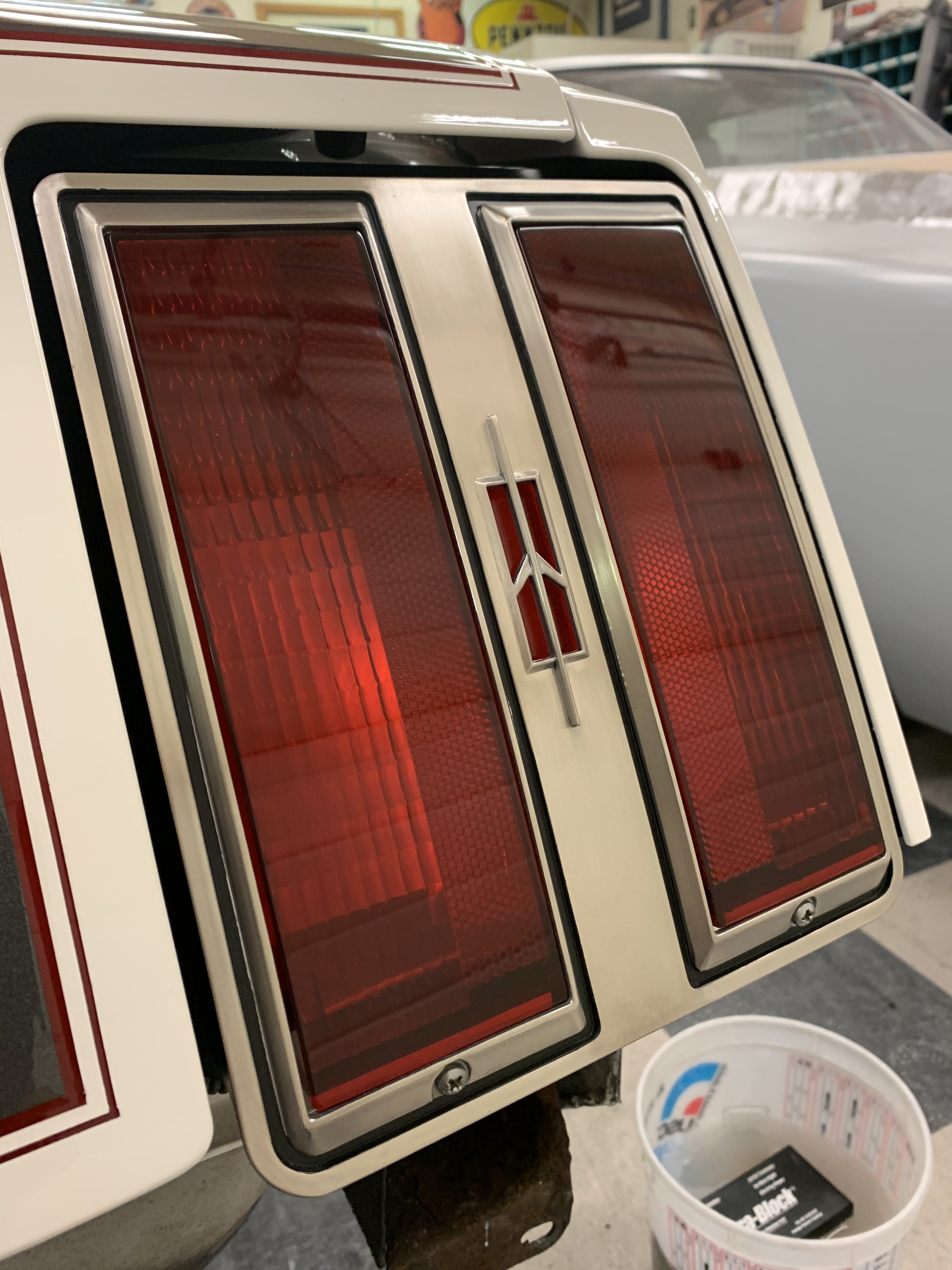

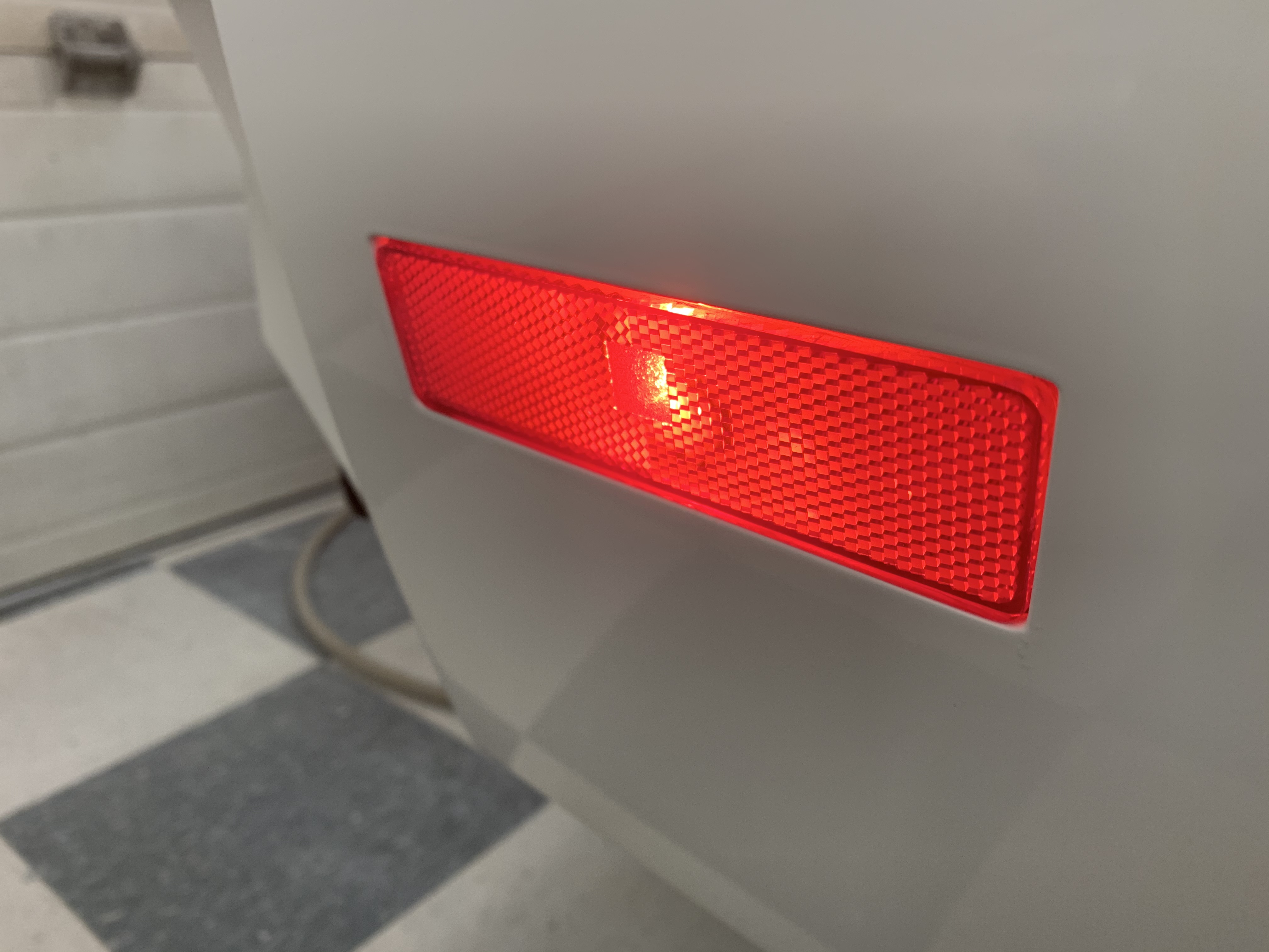

I’m off on a week’s holiday all this week and have started doing some reassembly on stuff that won’t interfere with wet sanding and polishing the car, I thought I’d throw up a few teaser pics of how it’s going and looking in the meantime:
I don’t know exactly when I’ll start cut and buffing the clearcoat just yet because it’s still so fresh and soft, it’ll likely need a couple weeks to fully harden up before I wanna attempt it.
Many more pics to come as it gradually gets put back together more and more, so stay tuned...
