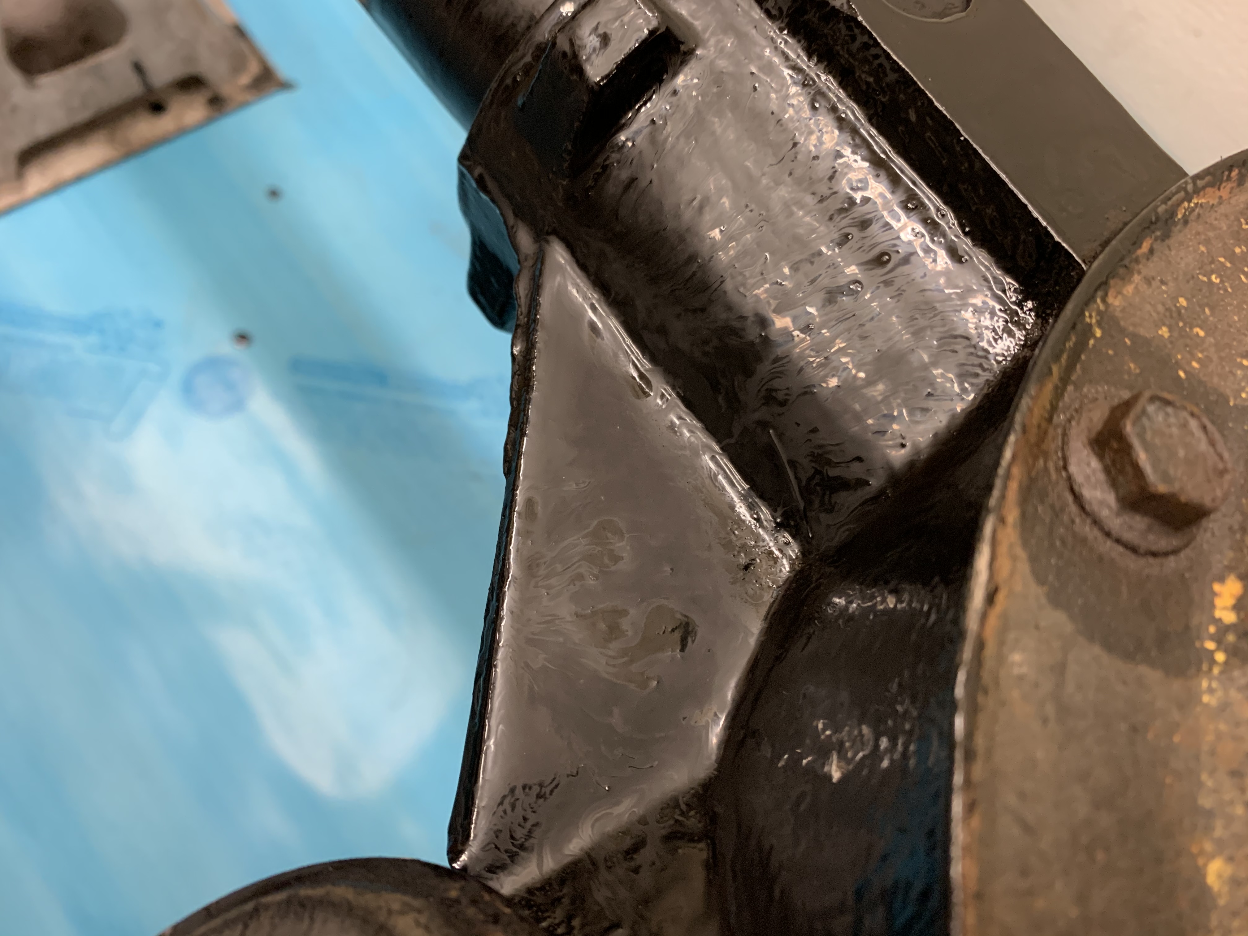

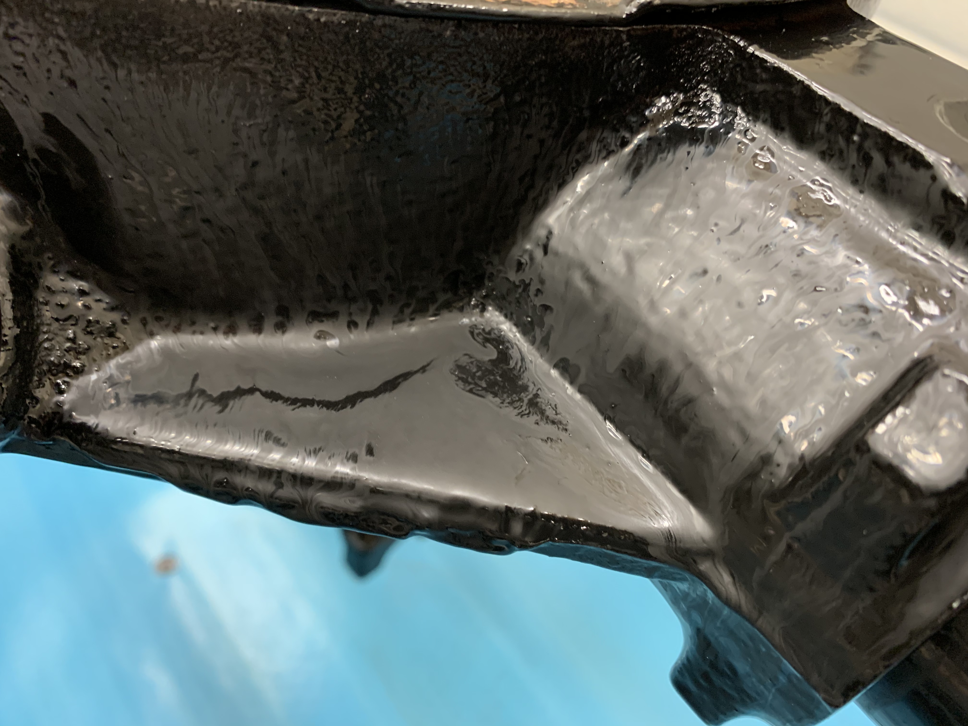

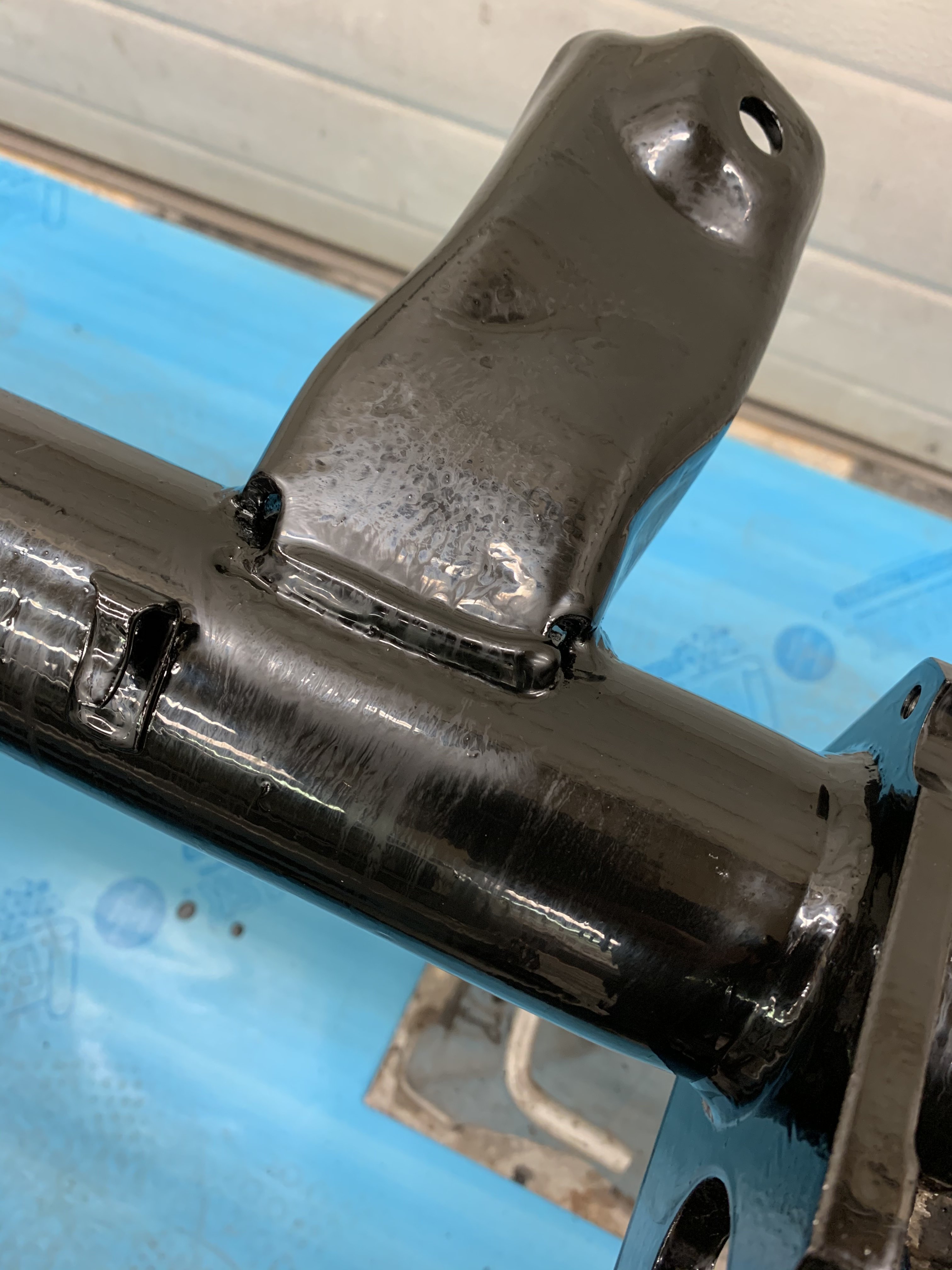

It is Quinn. I had a bad reaction between the first and second coats for some strange reason, almost like it was too humid even though it was in the climate controlled garage. It went all blotchy on me with some areas flat looking and others staying glossy.
Obviously I wasn’t about to settle or accept this, so I went with Plan B. POR recommends topcoating over it anyways because it’s not UV fast, so while it was still curing I hit it with 2 medium light coats of VHT semi-gloss black Chassis and Roll bar paint. This way it still gives the excellent protection that POR is known for, but also has the finish I was after WITH UV protection.
Win win win really.
I get that "second coat" reaction with the glossy POR-15 all the time. Semi-gloss only from now on.
