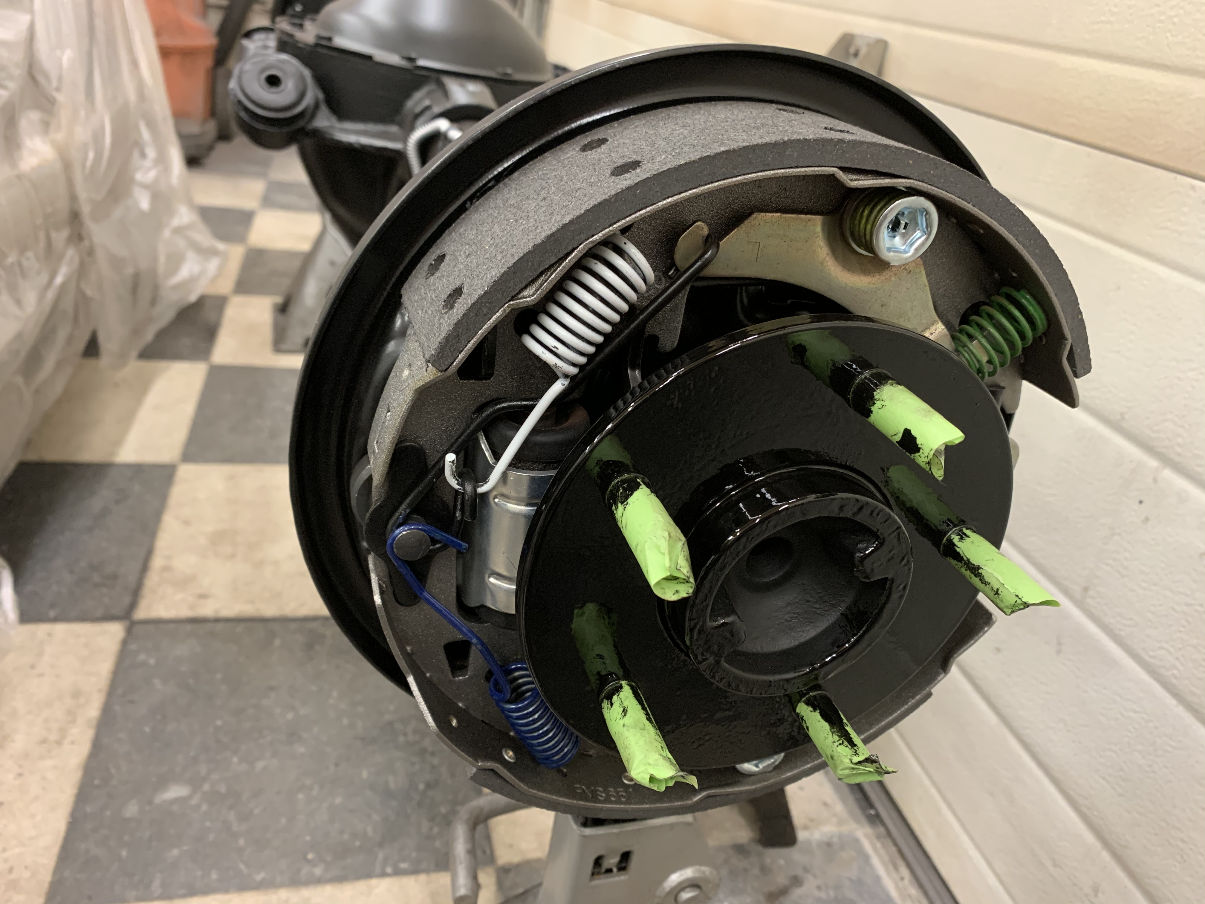

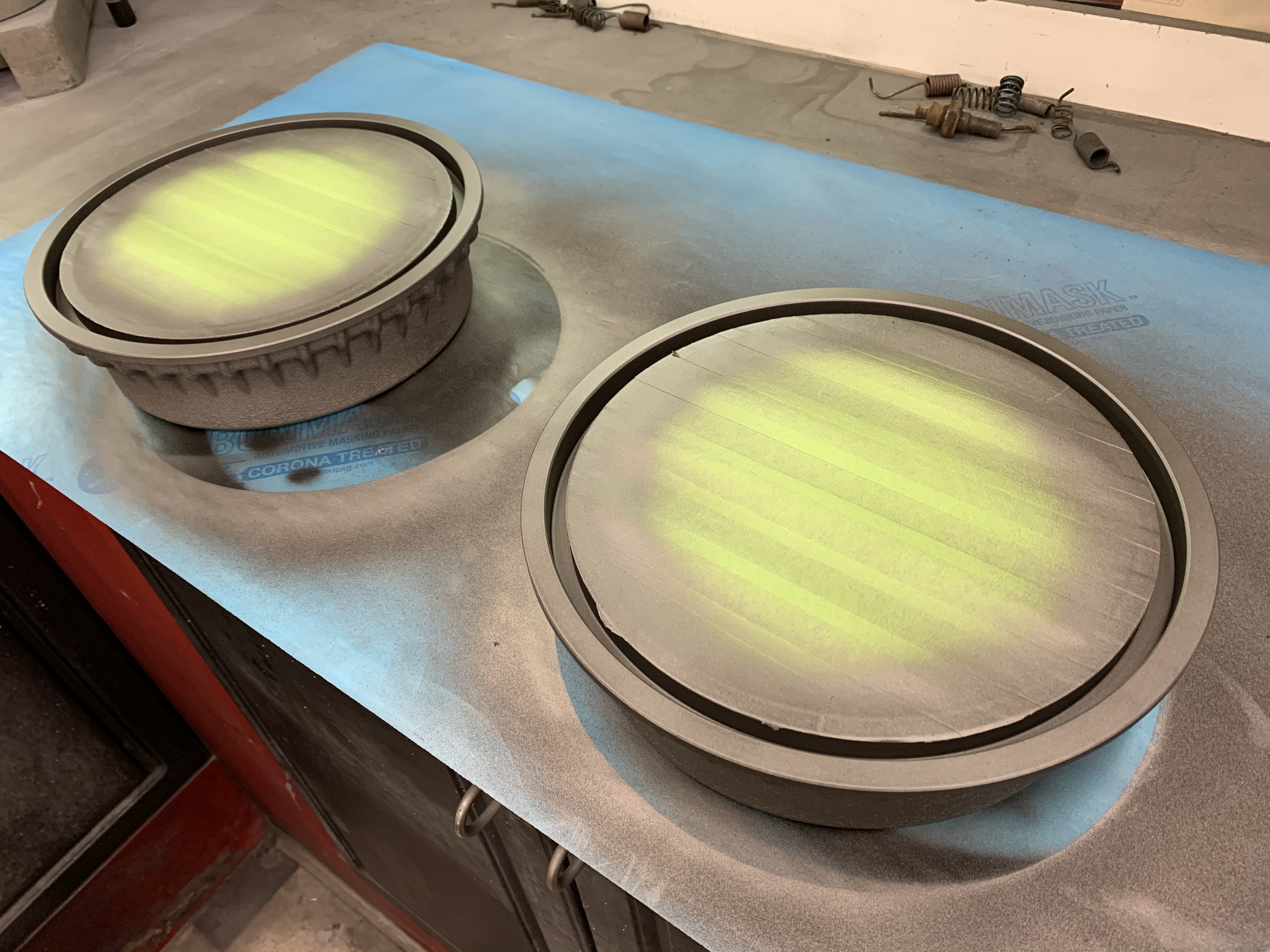

Wrapping up the last couple details now.

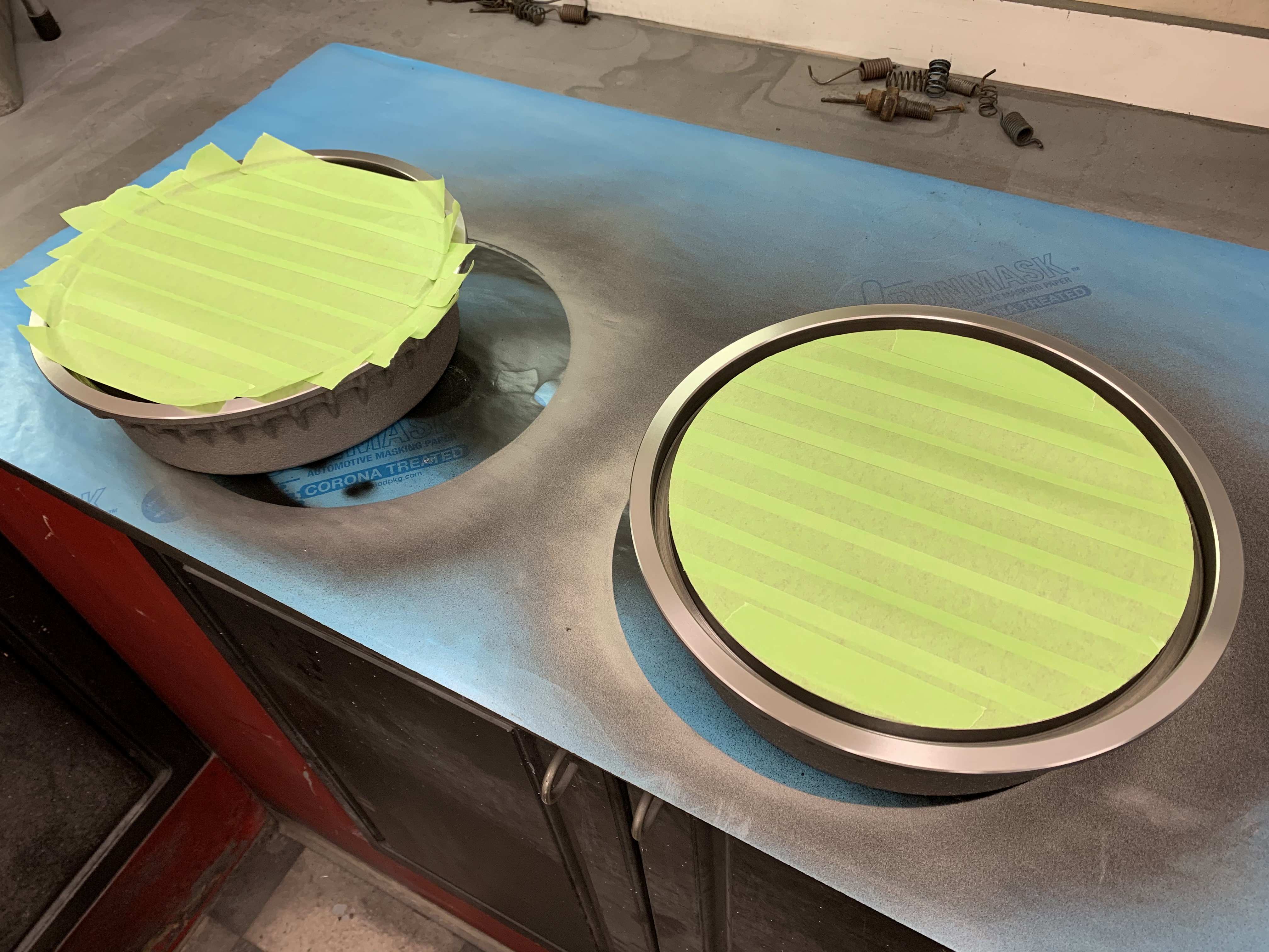

Fun with masking tape...
...then got the backsides protected.

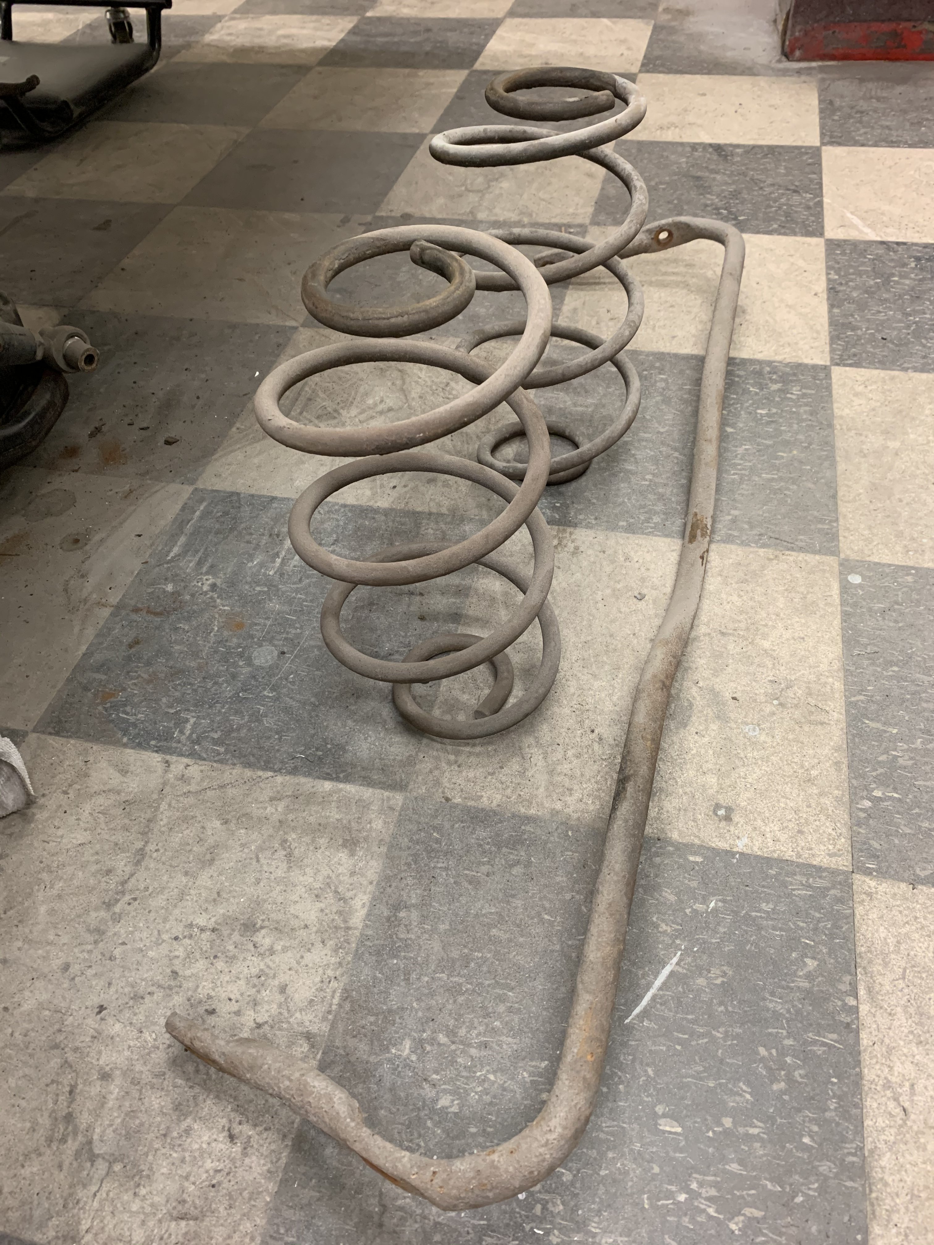

Nasty old springs and factory sway bar out:

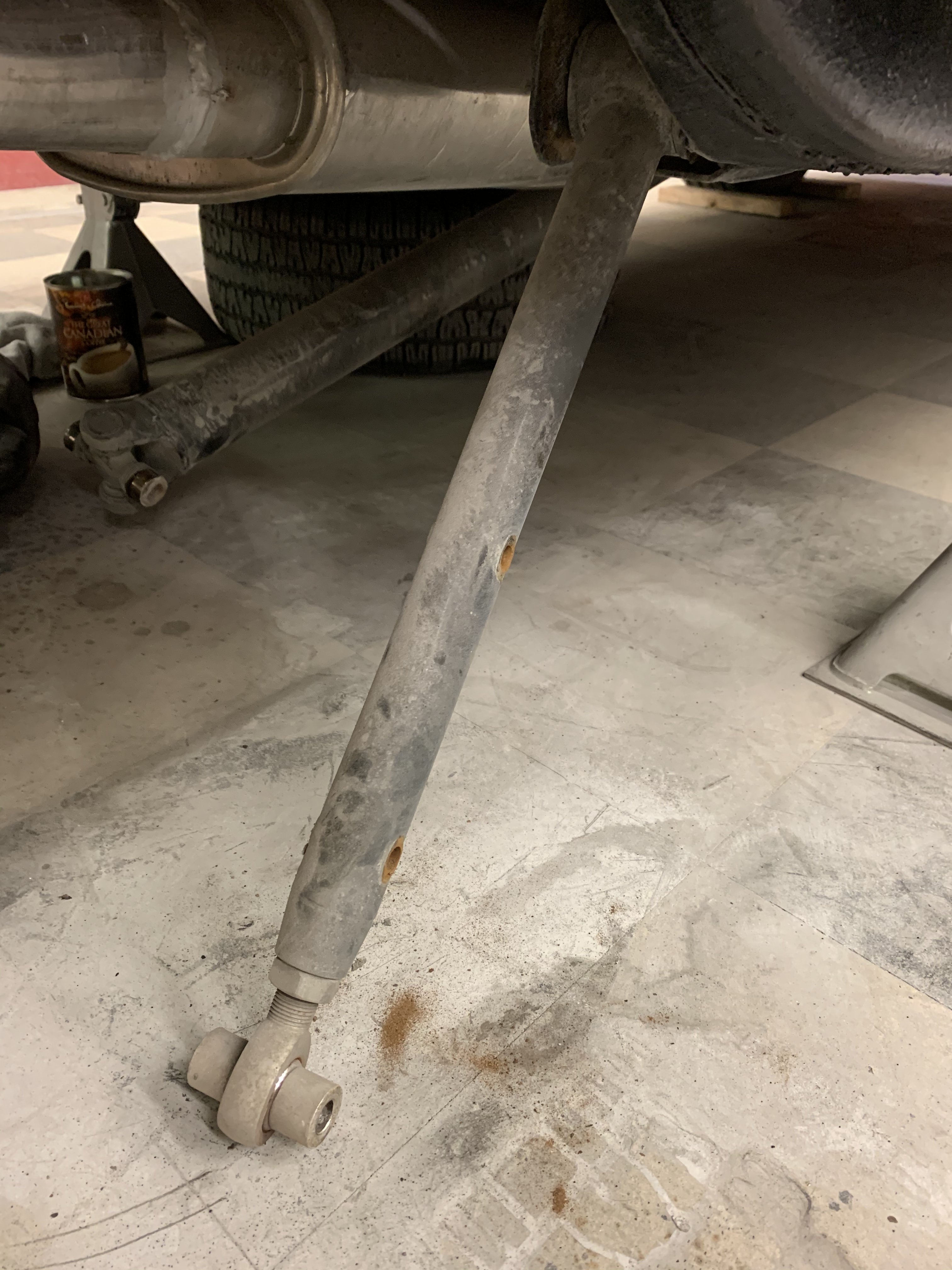

Streetbu was inquiring about the control arms, here’s the lowers. Uppers are 100% stock still.
Yeah they’re dirty AF, because I drive it. I’ll clean them up obviously before I reinstall the diff.

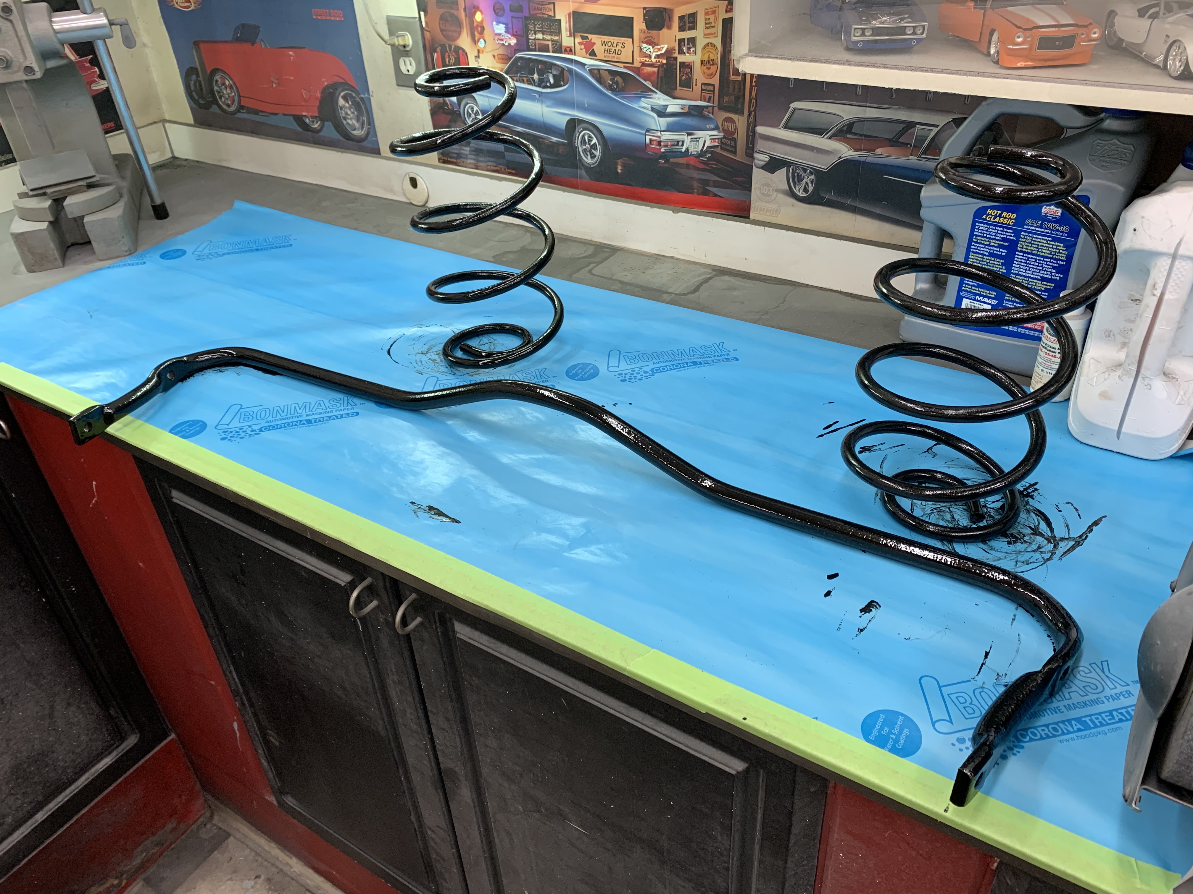

Spent some time cleaning up the springs and sway bar, MotorheadMike wasn’t the only one having fun playing with POR15 today.
Just for the record, springs are not exactly the easiest thing to paint!
Rust can suck a fat one.
