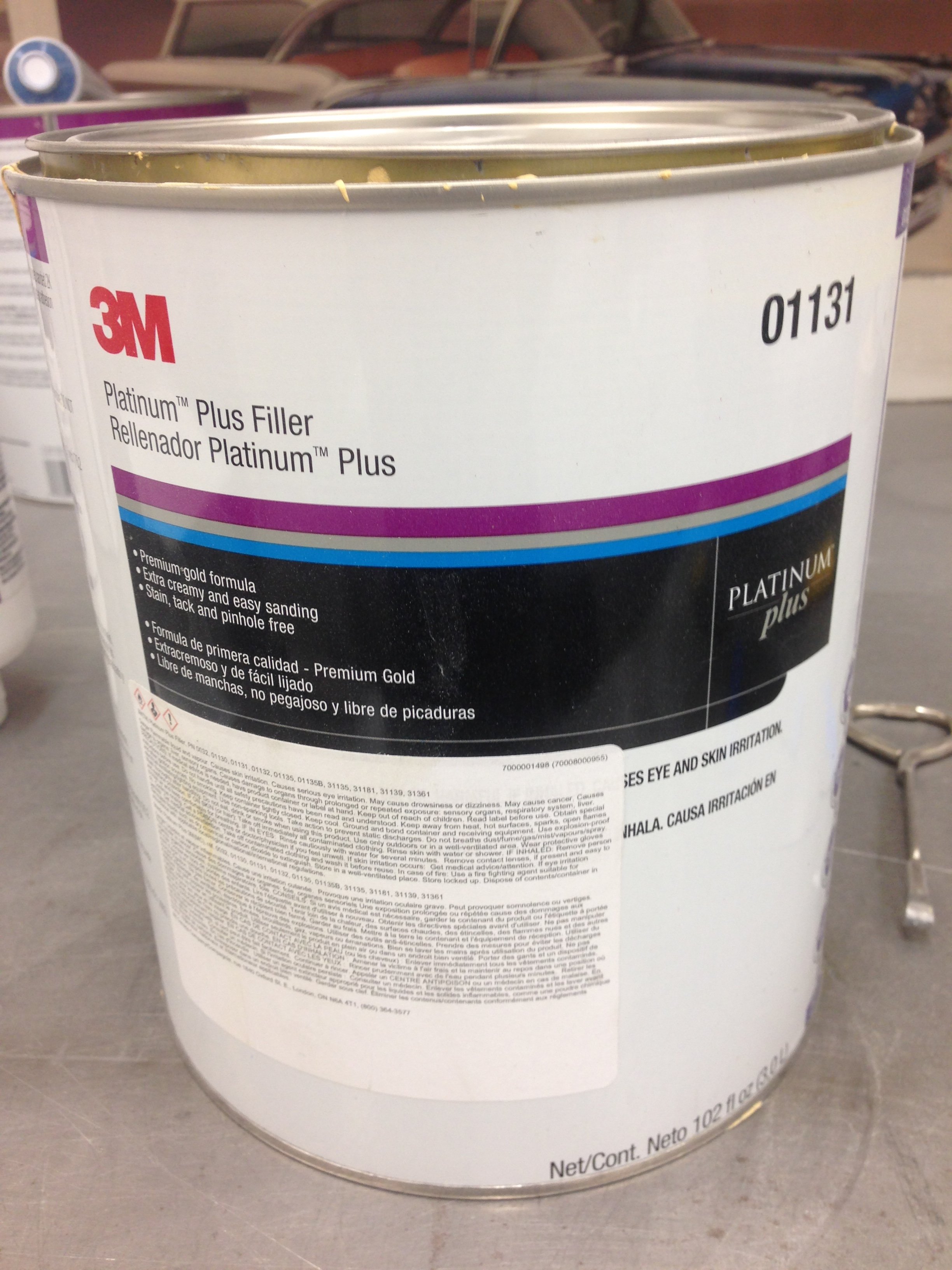

As for the products I'm using, so far it's 3M Platinum Plus body filler...

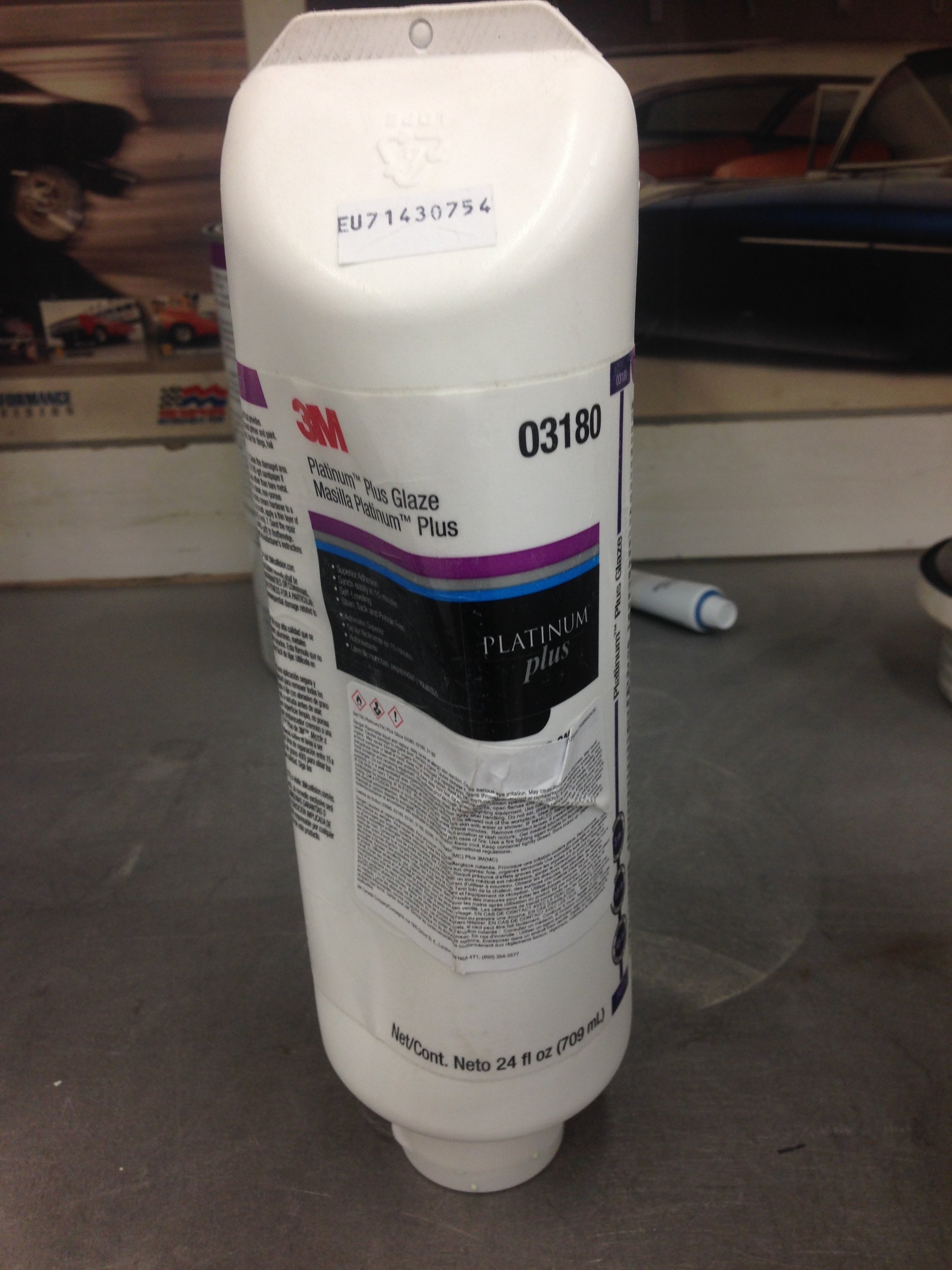

...and 3M Platinum Plus finishing glaze:

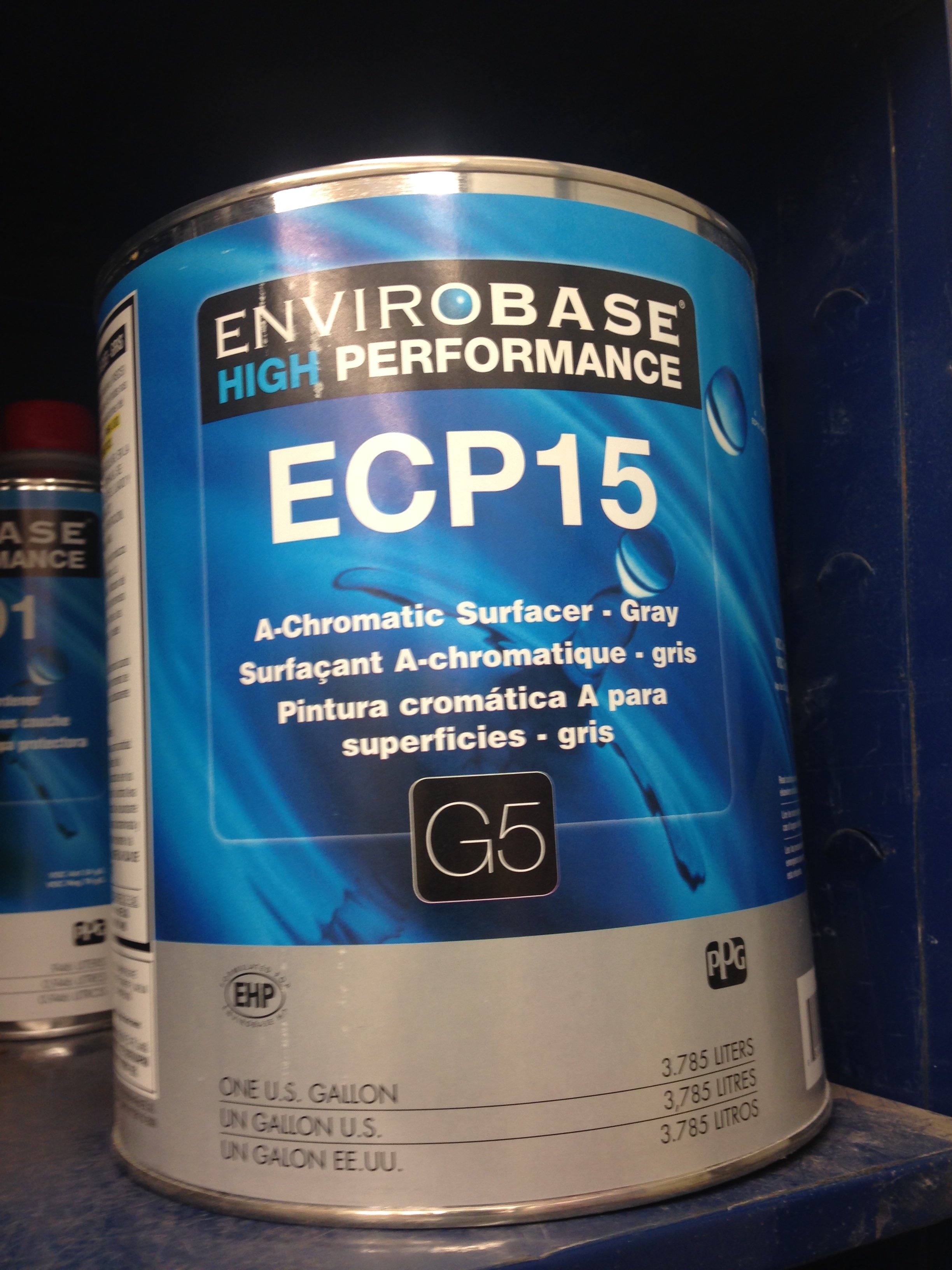

I'm a fan and firm believer in PPG products, I've used their stuff almost exclusively in the past. I usually use either their Global high build primer surfacer (for solvent based paints), or their EnviroBase stuff for waterborne:

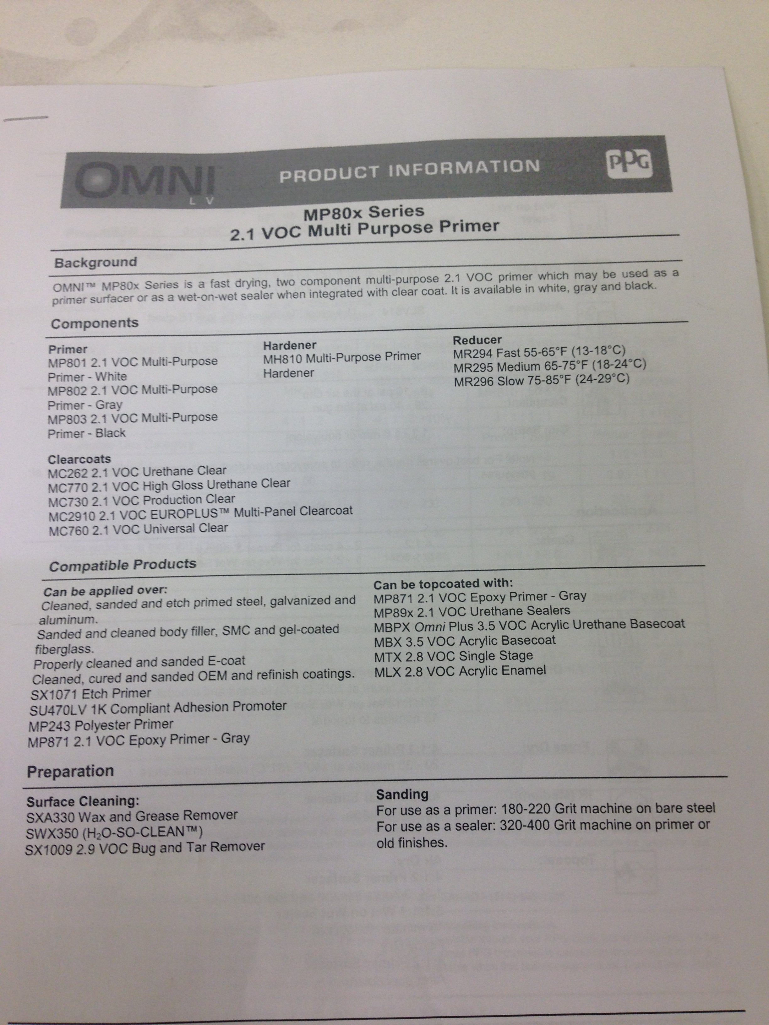

But this time I'm going to try something new. I've used Omni paints before in the past, both single stage and base-clear, but never their primers. This time I'm going to try their version of high build. It's called MP80x, and it can be used as either a primer-surfacer or a sealer depending on mixed ratio. Should still be good quality, but at a little better price point.
Here's the P sheet on it:
I'll be reporting on how I like it, it's ease of sanding, filling properties, etc once I use it. Hopefully it's as high quality as the rest of PPG's stuff.

I've used all those products I'm in a PPG shop now and we tried the Omni with mixed reviews it worked for me but I think I'm spoiled from using PPG K38 it's just so user-friendly to me the Omni seemed thin and shrunk up a bit so we had to put them in the sun or bake them for an extended period of time.thats why we went back to K38
Thanks for the info Eric.
I expect some shrinkage to the Omni primer, but as long as it's not excessive I can deal with that.
As for K38, that stuff is no longer available here, and hasn't been for some time now due to stricter VOC regulations in my area. It appears the car was primed with the "yellow death" back when it was repainted, and from what I've seen so far, I'm not impressed. Mind you, it has more to do with the person that applied and prepped it than with the product itself.
