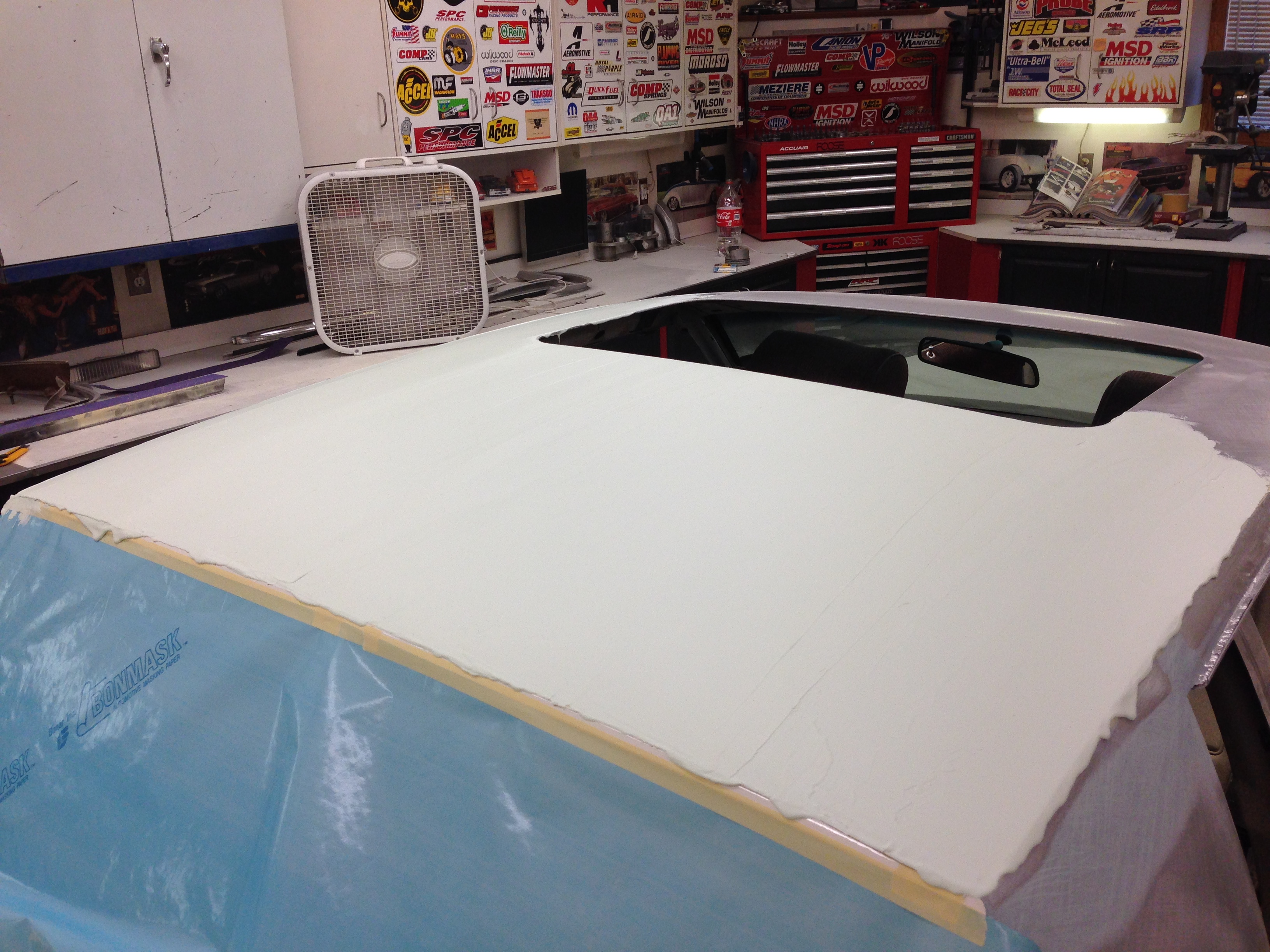

This was the first full application of filler on the roof:
And yes, I know what you're thinking.
"Damn D, that's a LOT of filler!!"
And you'd be right. But before y'all start flaming me for having a "bondo bucket", or other such terms, this is the correct way to do a large flat panel.
A common mistake that many novices make is trying to fill many small areas and sand each one individually. This doesn't work, this just creates waves in the final product. You have to skim the ENTIRE area, then block it all out as one. The filler will stay in the low areas, and will get removed from the high ones.
As bad as it looks to have that much filler spread across the roof, keep in mind 90% of it gets sanded off and ends up on the floor. In fact I've become very proficient at turning large quantities of expensive product into worthless dust!
Lol

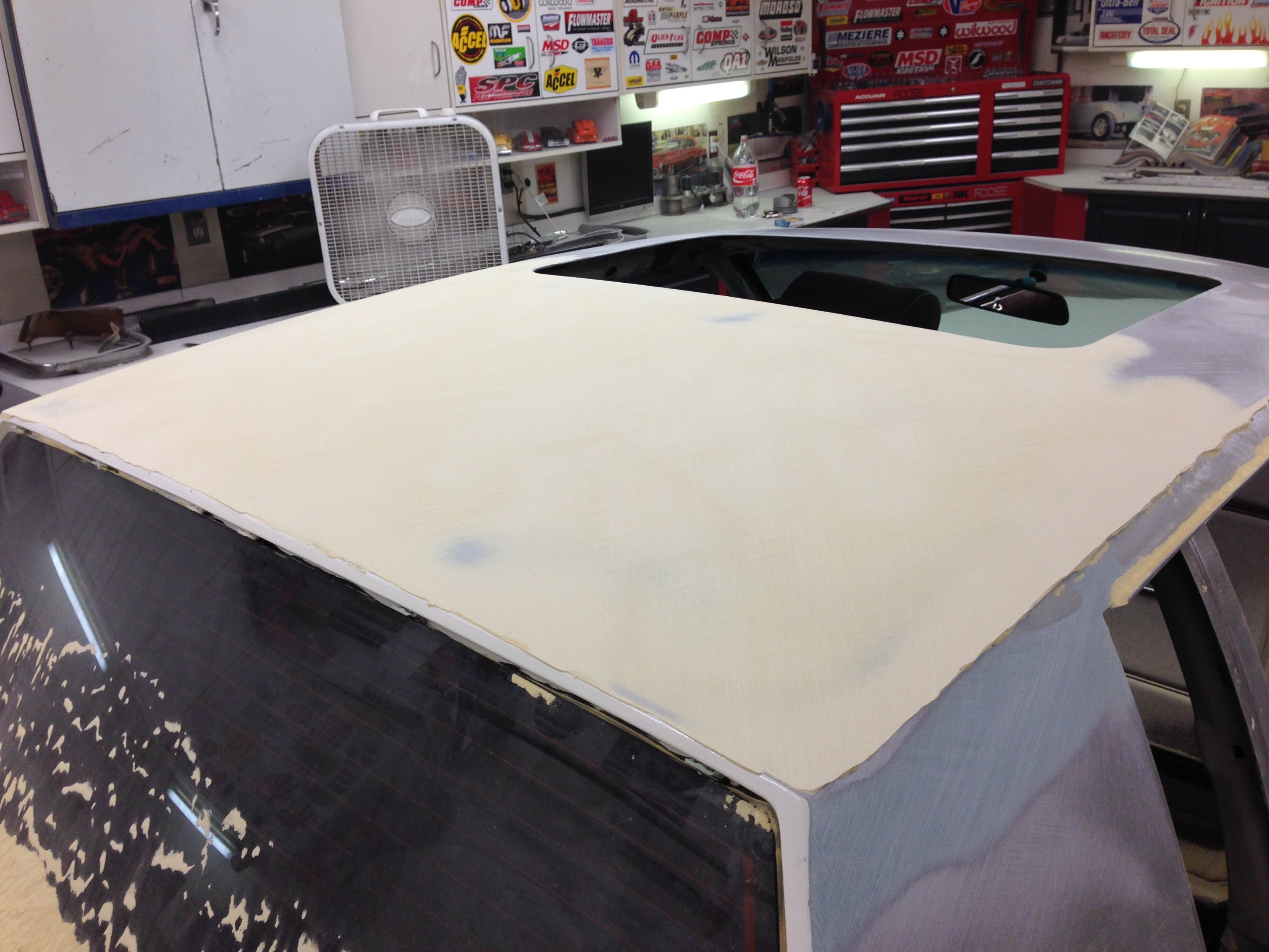

These were after the above application was finish sanded in 40 grit:
As you can see, it creates quite the mess!
After that step, the area was blocked out in 80 grit to remove the 40 grit scratches, but this left the area slightly low.

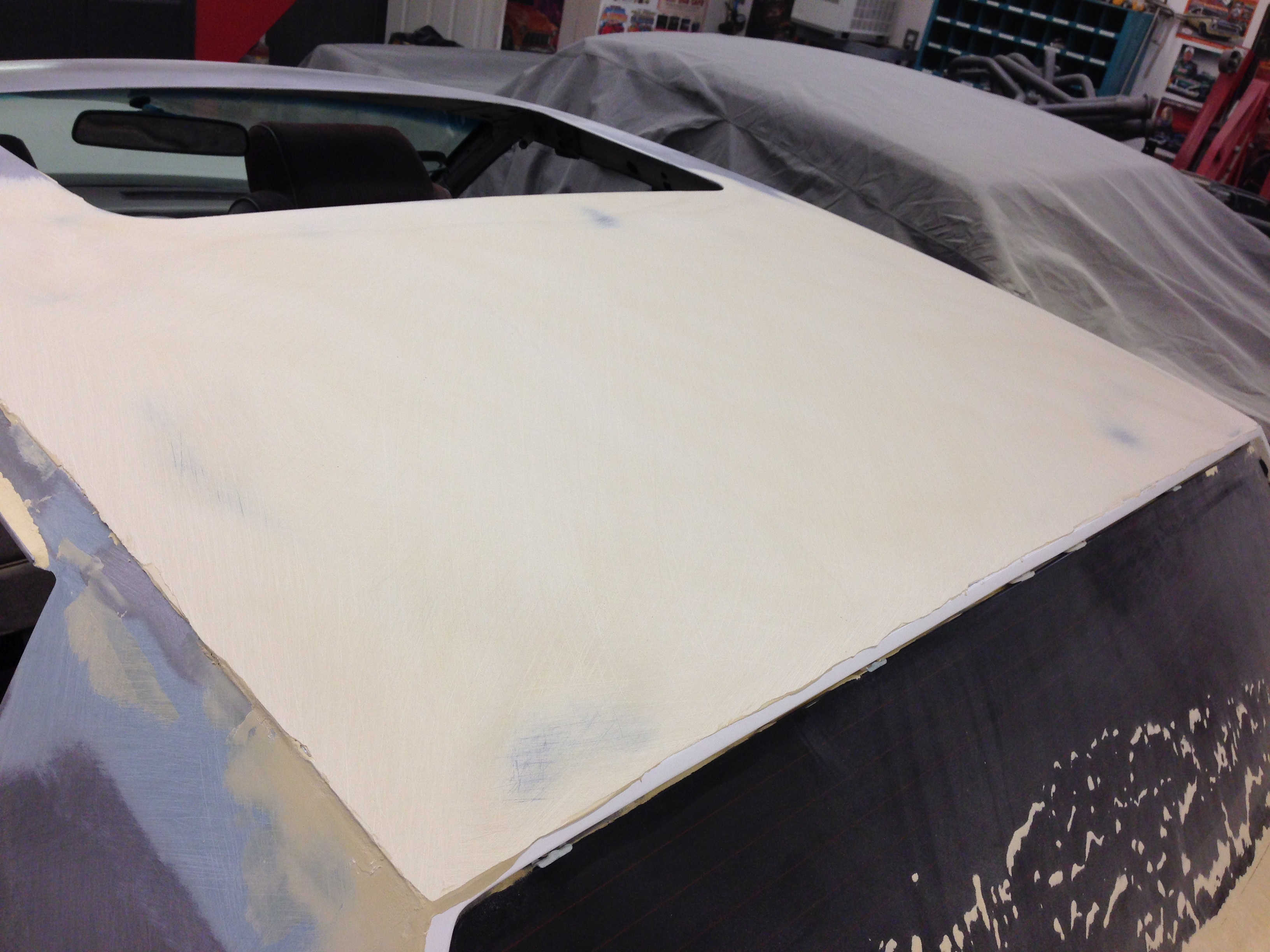

Time for an application of glazing putty. The putty serves several purposes, it fills any pinholes in the underlying filler, adds a thin skim coat, and provides a finer, smoother easier sanding surface prior to primer.
Again, ya gotta skim the whole area:
The masking paper covering the back window is to keep any drips or spillage from getting into the window channel areas and off the window itself. The putty is quite a bit more runny than the filler, so I didn't want to take any chances.

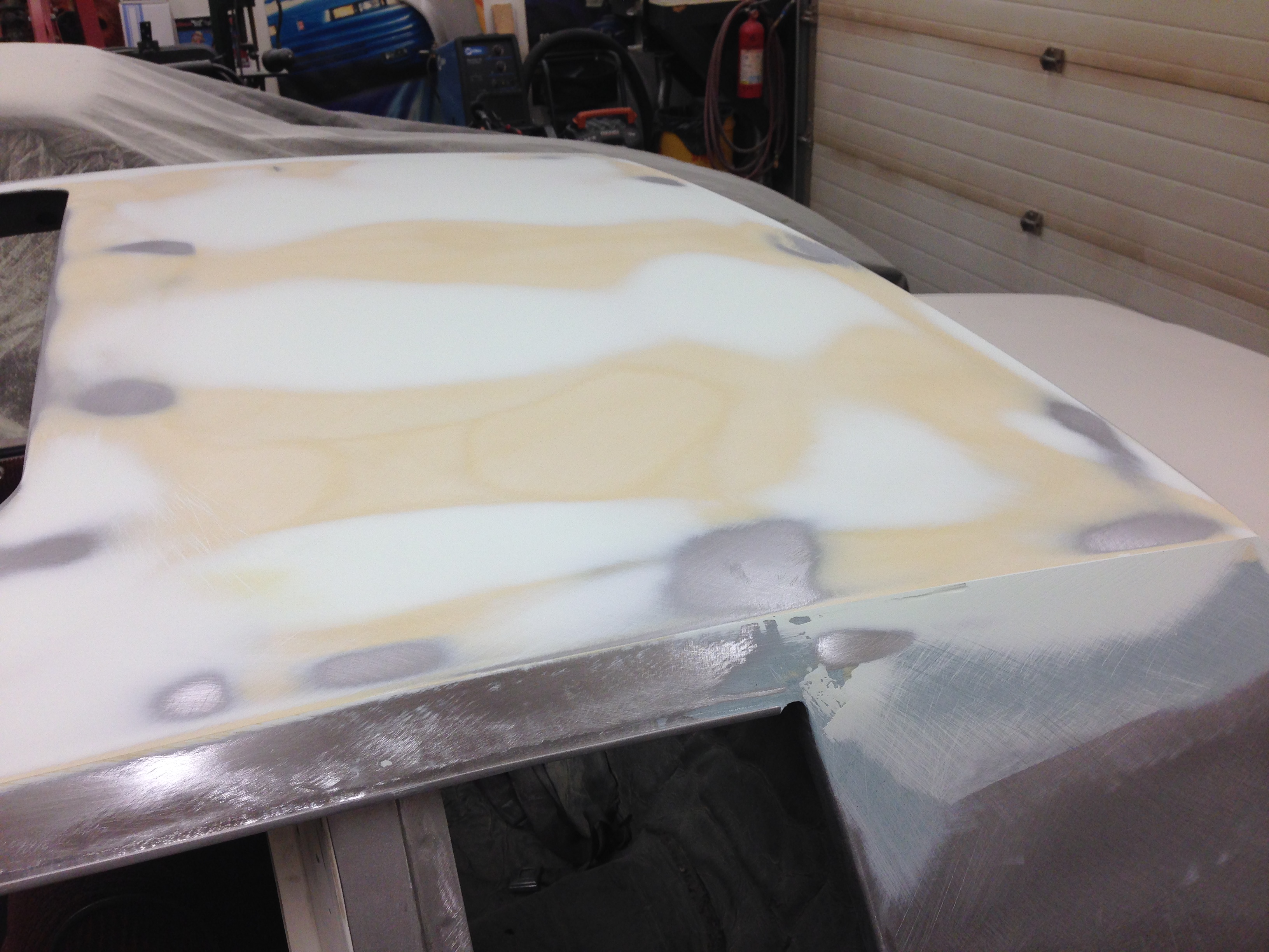

This is the back part of the roof now completely blocked out and flat, finished in 120 grit.
It still looks thick, but as you can tell by the bare metal areas, it's actually pretty thin. I can't sand any more off, or I'll get into low areas and will create waves. It took 4 days just to get to this point.

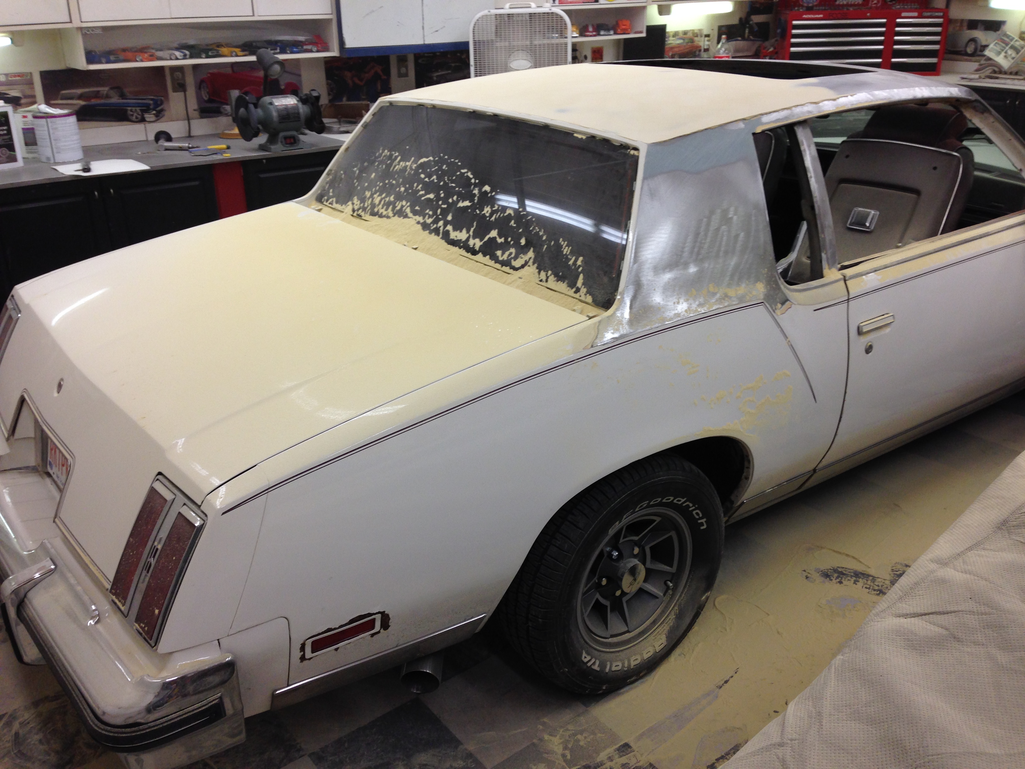

Tonight I finished up the sail panel and "B" pillar bodywork, again just light skims of putty where I had welded up holes and had some deeper grinding marks.
This is how the car looks currently:
It ain't pretty by any stretch, but unfortunately it's a necessary evil. I am however happy to report that everything I have block sanded is nice and flat and true. It all feels really good to the hand at this point. The plan is to have the entire roof, "B" pillars, and both quarter panels bodyworked and done before I mask and prime. It should be a bit easier to manage by doing sections at a time that way.
The driver's side filler work is next, starting tomorrow night.
