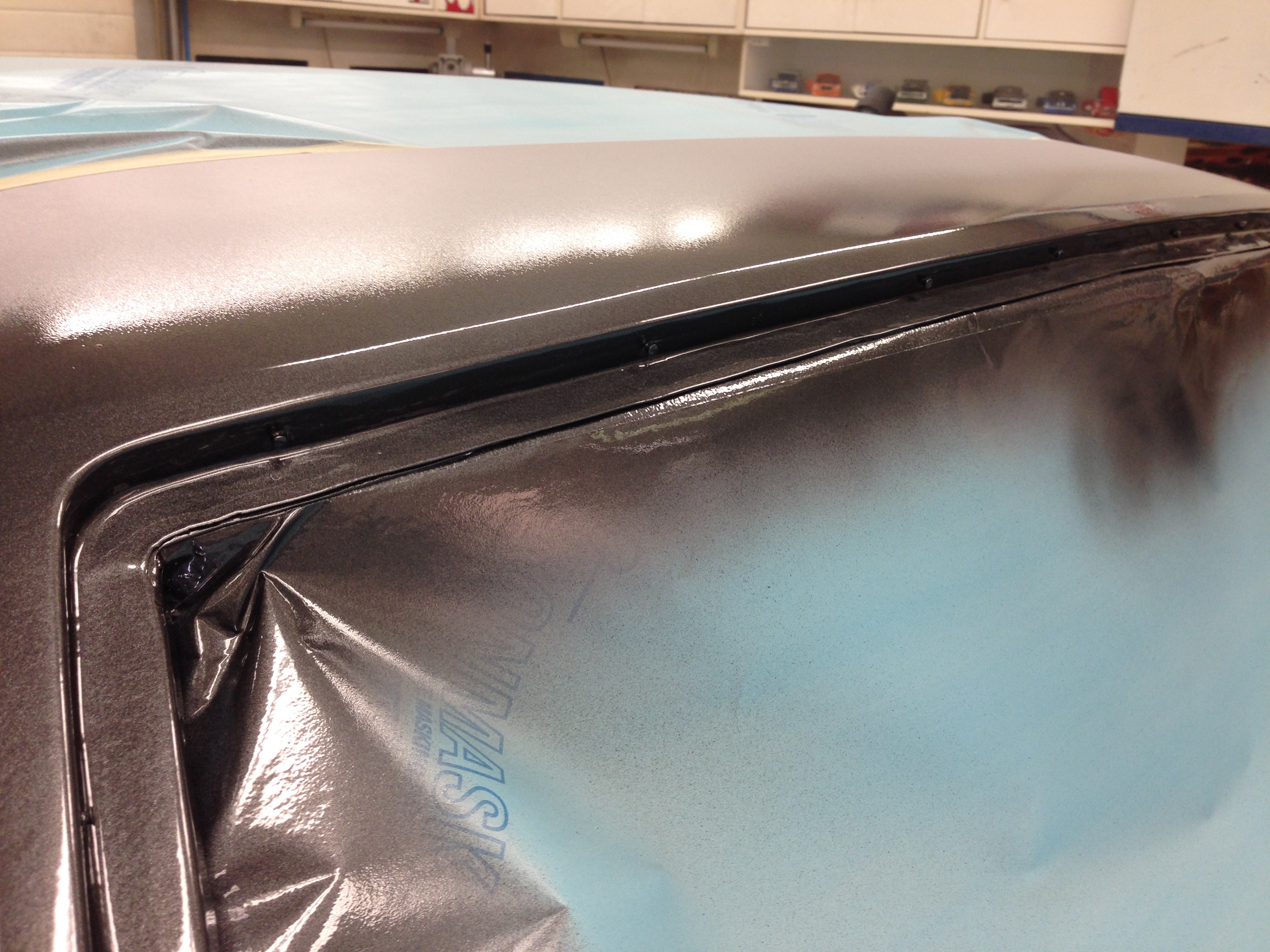

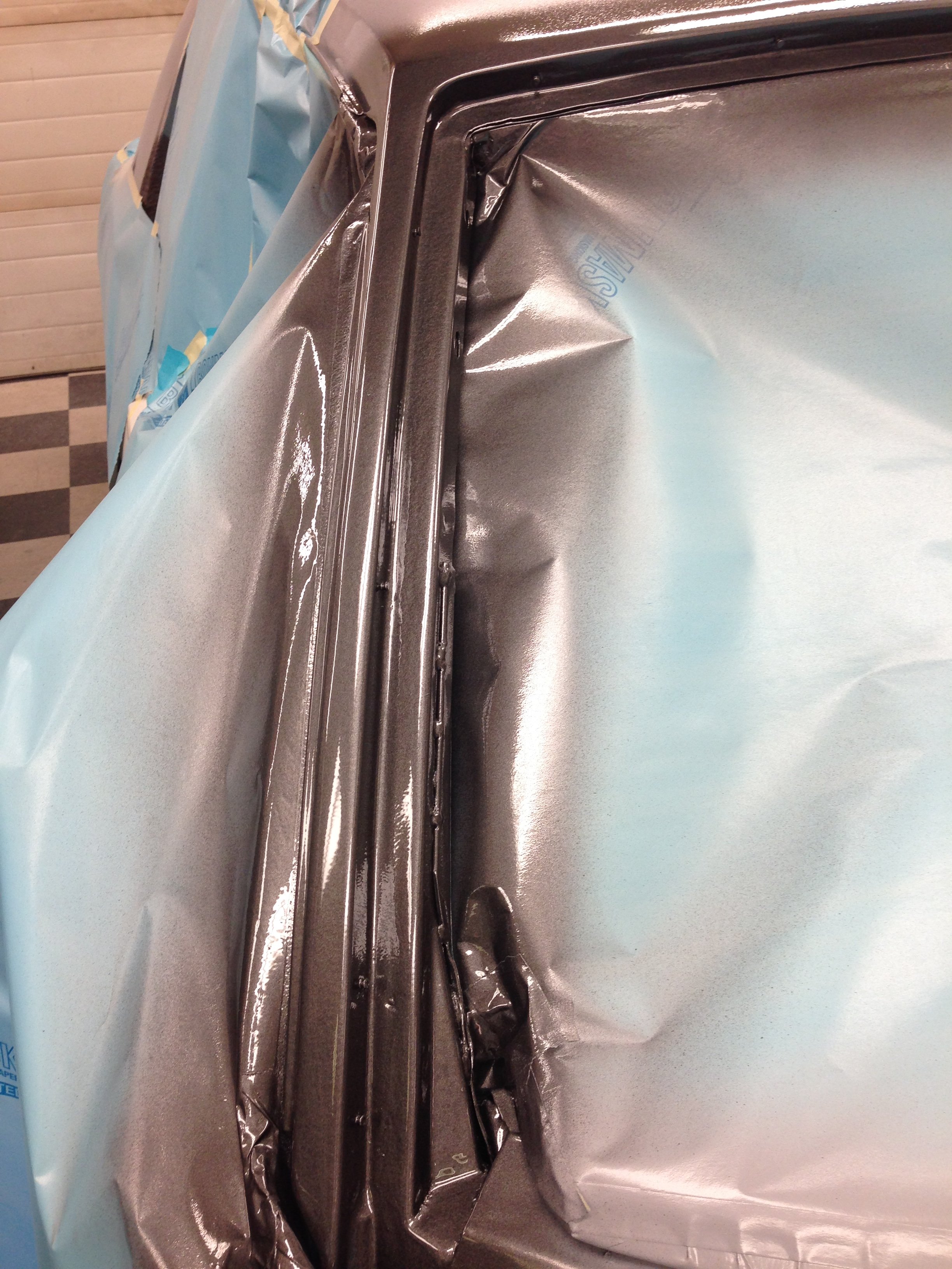

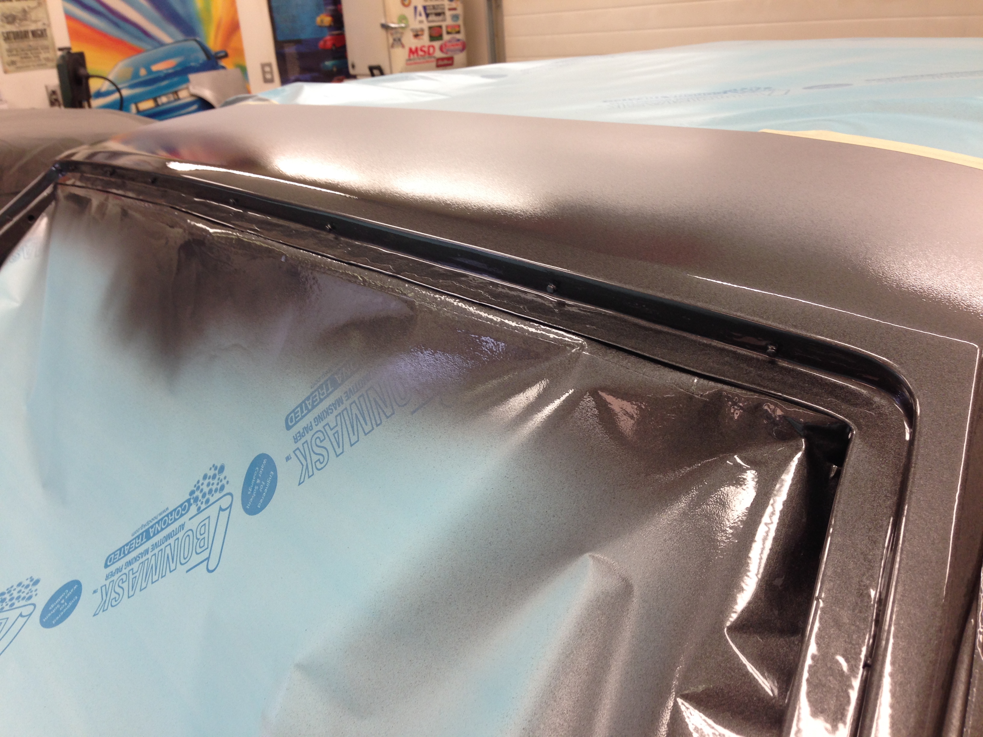

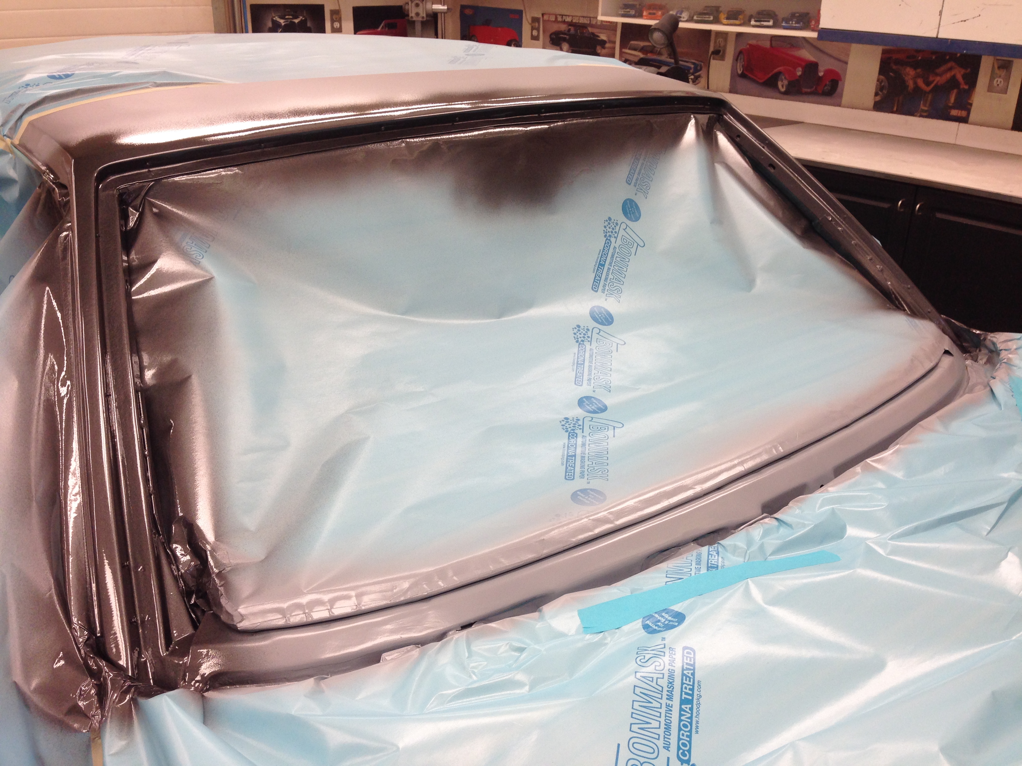

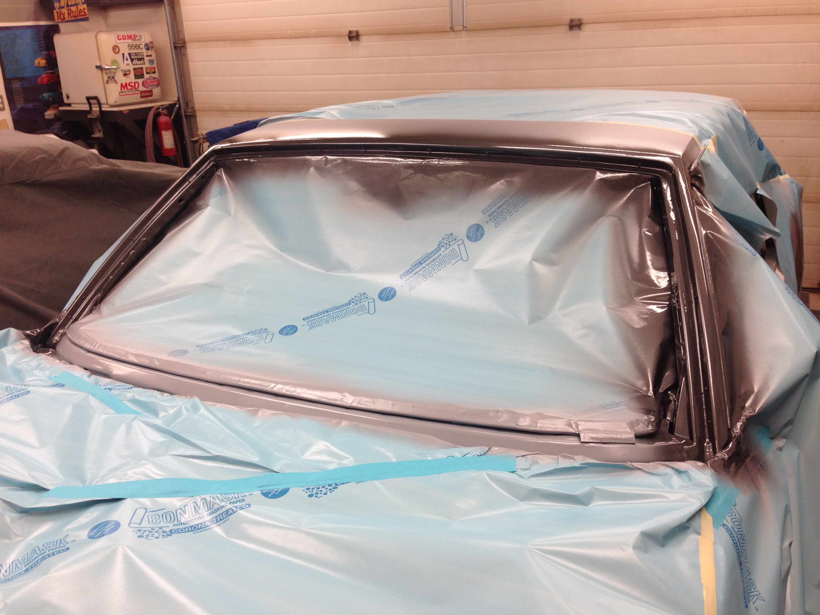

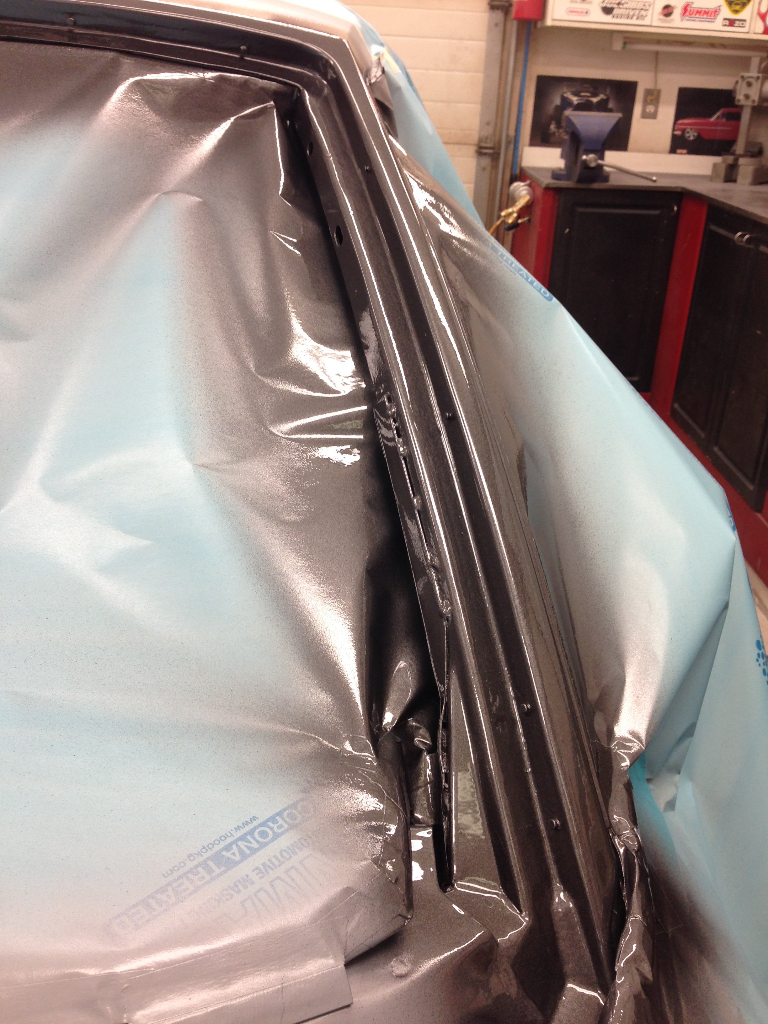

With the back covered, I turned my attention to the front. The upper three sides received 3 coats of color, but I left the bottom portion untouched. This needs to be painted satin black to match the cowl and firewall areas. Unfortunately I can't do it until tomorrow, the fresh paint needs at least 12 hours to cure before it's safe to tape over.

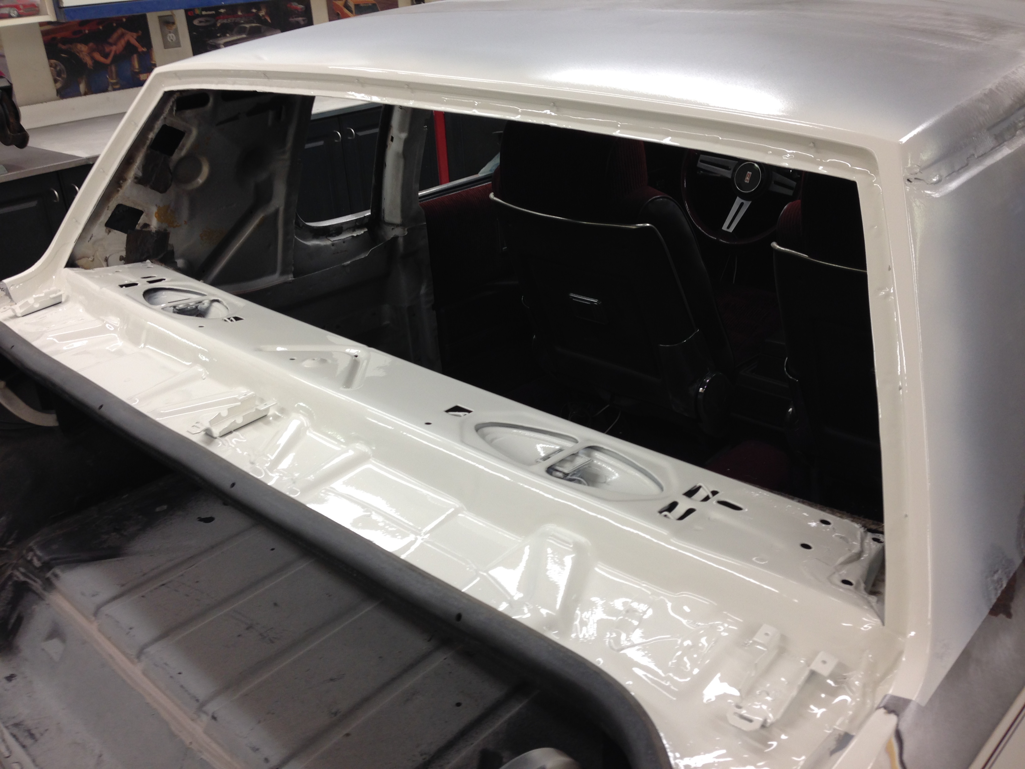

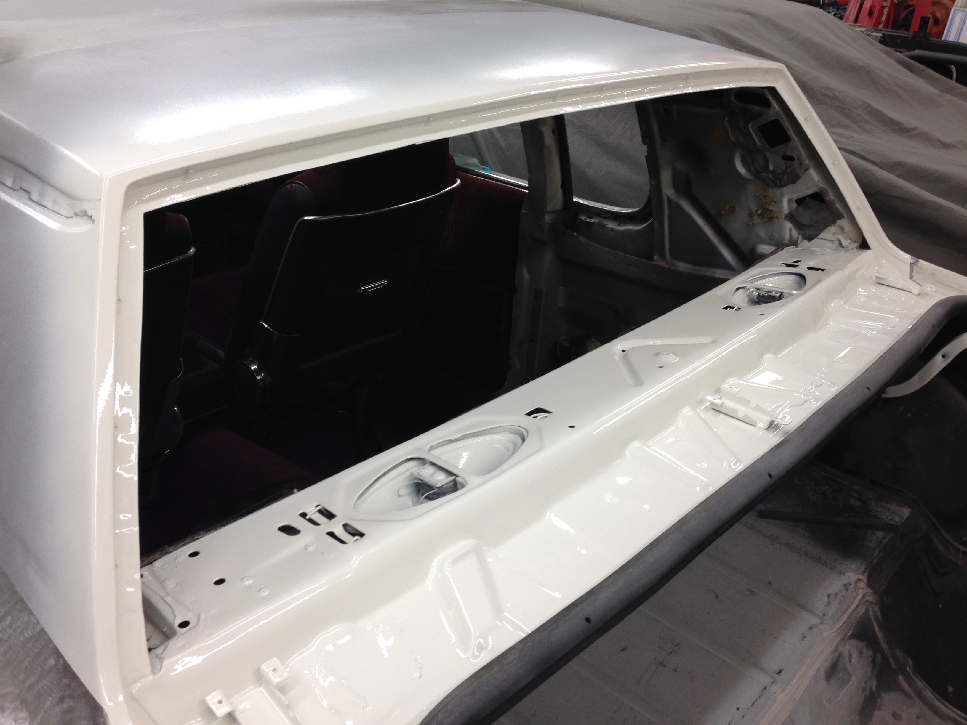

Here's the pics of the back I promised earlier, now unmasked and ready to go:
As soon as I had the first coat of epoxy on, I got on the phone with my glass guys. As some of you may know, this has been the driving force behind getting these areas done. They've been pressuring me a bit to come back and get the new windshield installed.
I was able to make an appointment for this Thursday, they'll come and install the windshield and reinstall the back window at the same time. (I've already had my good friend retint the back window after it was damaged during removal, so it's ready to go too).
Thursday is perfect, it gives the fresh paint some time to cure before the glass goes back in.
After the glass is reinstalled, I can do a small amount of reassembly. The trunklid can go back on, as well as the windshield wipers, stainless moulding, and related parts.
After the black is done at the base of the cowl tomorrow, I'll pull it outside and take some more pics.

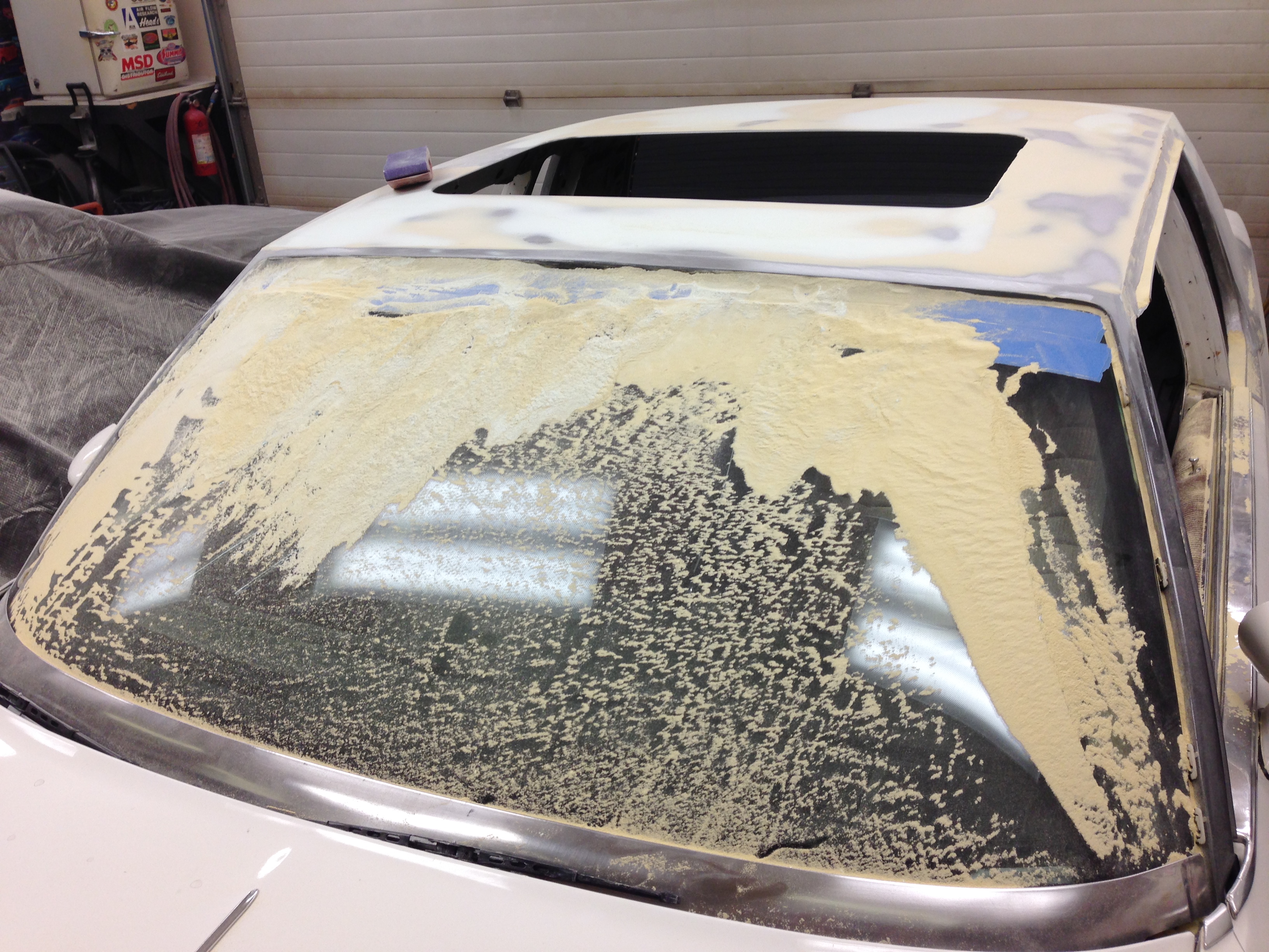

Once the back part of the roof was done, my OCD had its first revolt.
The dust and mess was already so bad, I had a fine layer of it on every single surface in the garage. I was even starting to track it into the house.
So Wednesday evening I pulled the car out and gave it and the garage a thorough blow out and cleaning. My dust pan holds something like 1 gallon, and it was full and overflowing just from the dust on the floor. Blowing the car out outside resulted in a dust storm that looked like something was on fire! Bet my neighbors were real impressed.

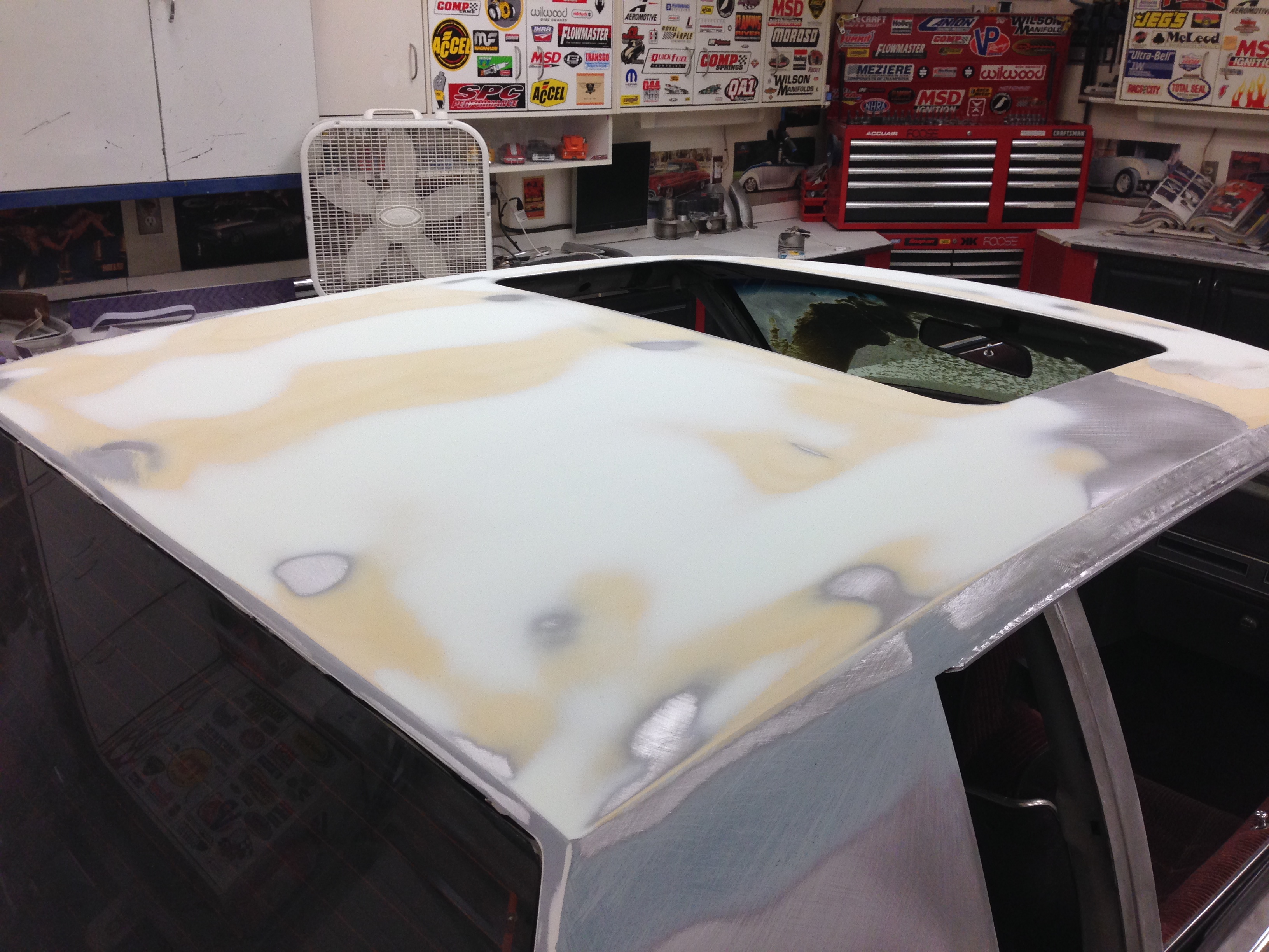

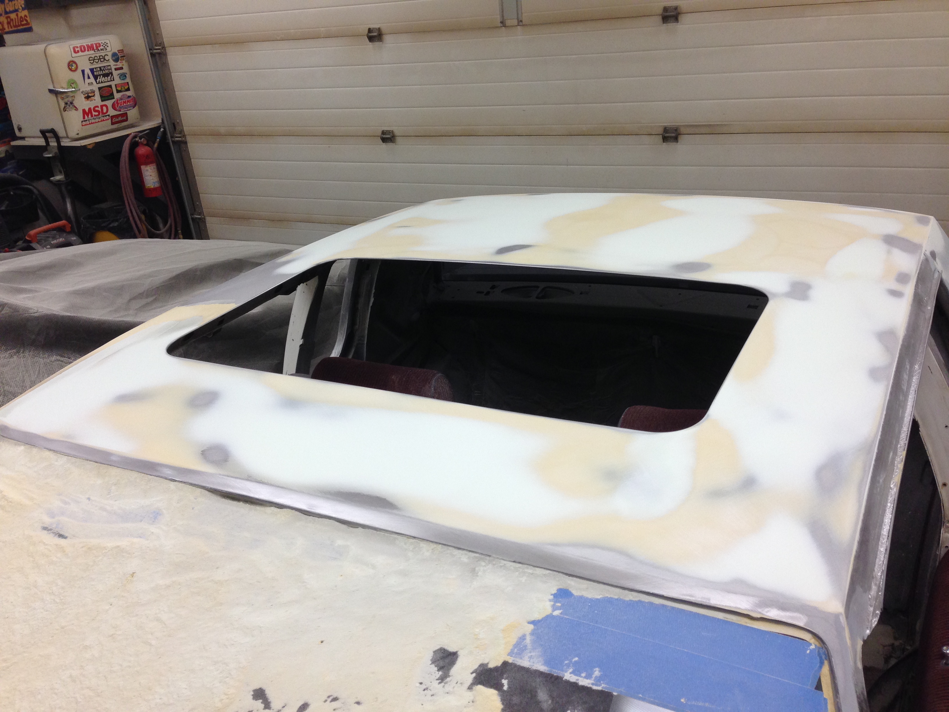

Once I had the shop cleaned back up to an operational state, I started in on the next area of the roof. This was the front section from the windshield to the front of the AstroRoof opening. After more skimming and blocking, the dust resumed.
Thankfully, things started to move along at a little more rapid pace. I got the entire front section done Wednesday night. Much less surface area to deal with.

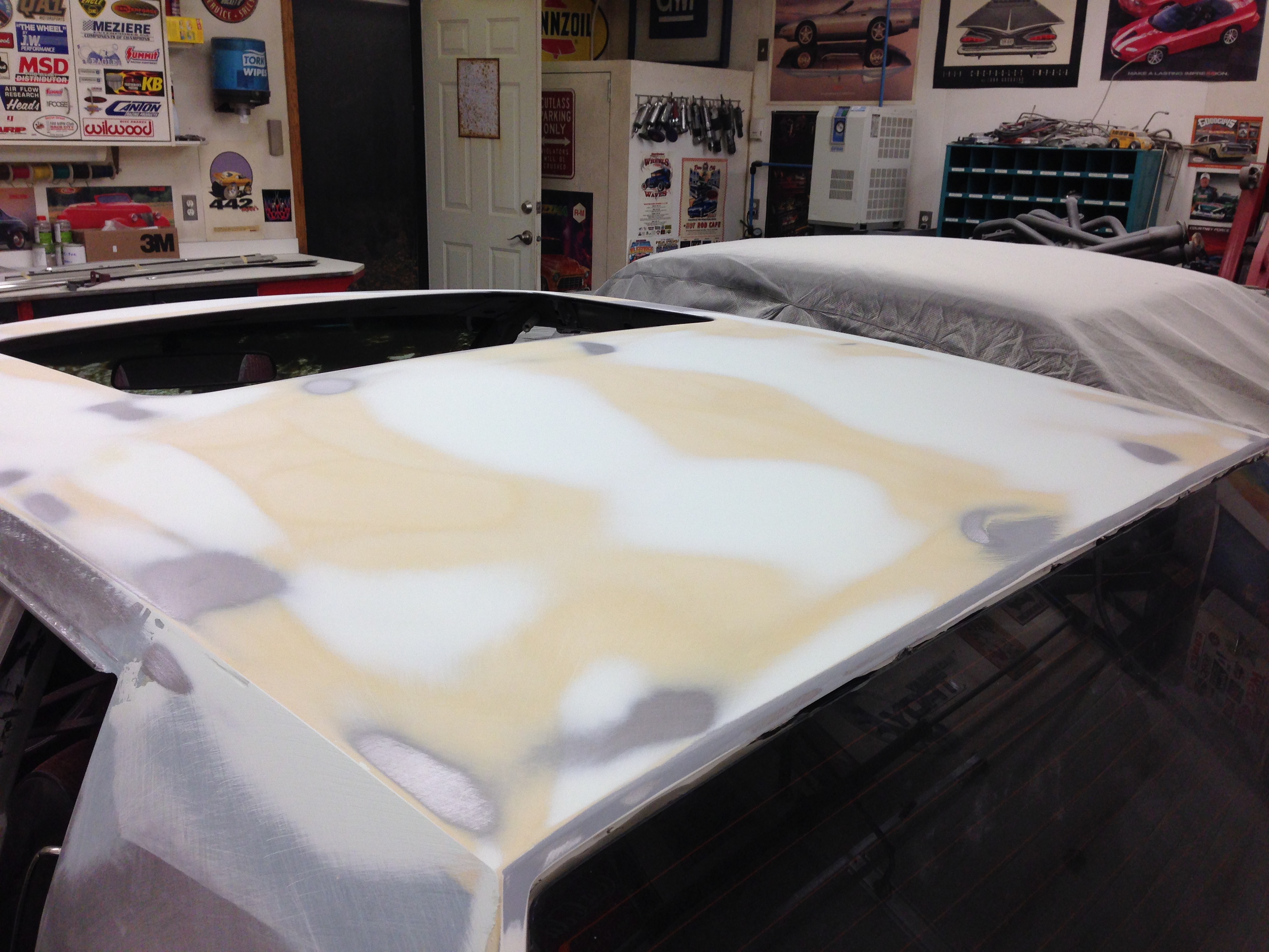

Tonight I resumed work, this time on the driver's side, connecting the two areas. Again, another good night, I managed to complete this area and get it blended into the other two fairly easily.

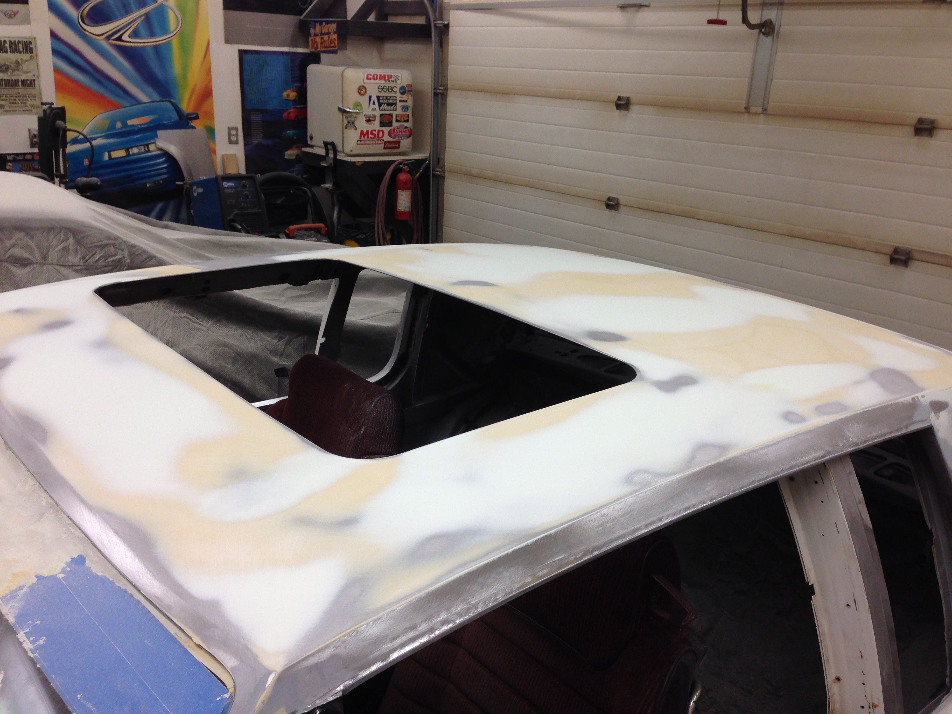

The following pics are a "walk around", taken at different angles so you get a 360 degree view:
The goal was to try to get the filler work on the horizontal part of the roof done by the end of the week. I have obligations tomorrow night, so I didn't quite meet that goal. But I came pretty damn close. If I had one more night, I would've gotten it done.
As it stands now, all that remains is this area on the passenger's side:
Here's one last pic, showing the extent of the mess, a mere one day after my big cleanup!
