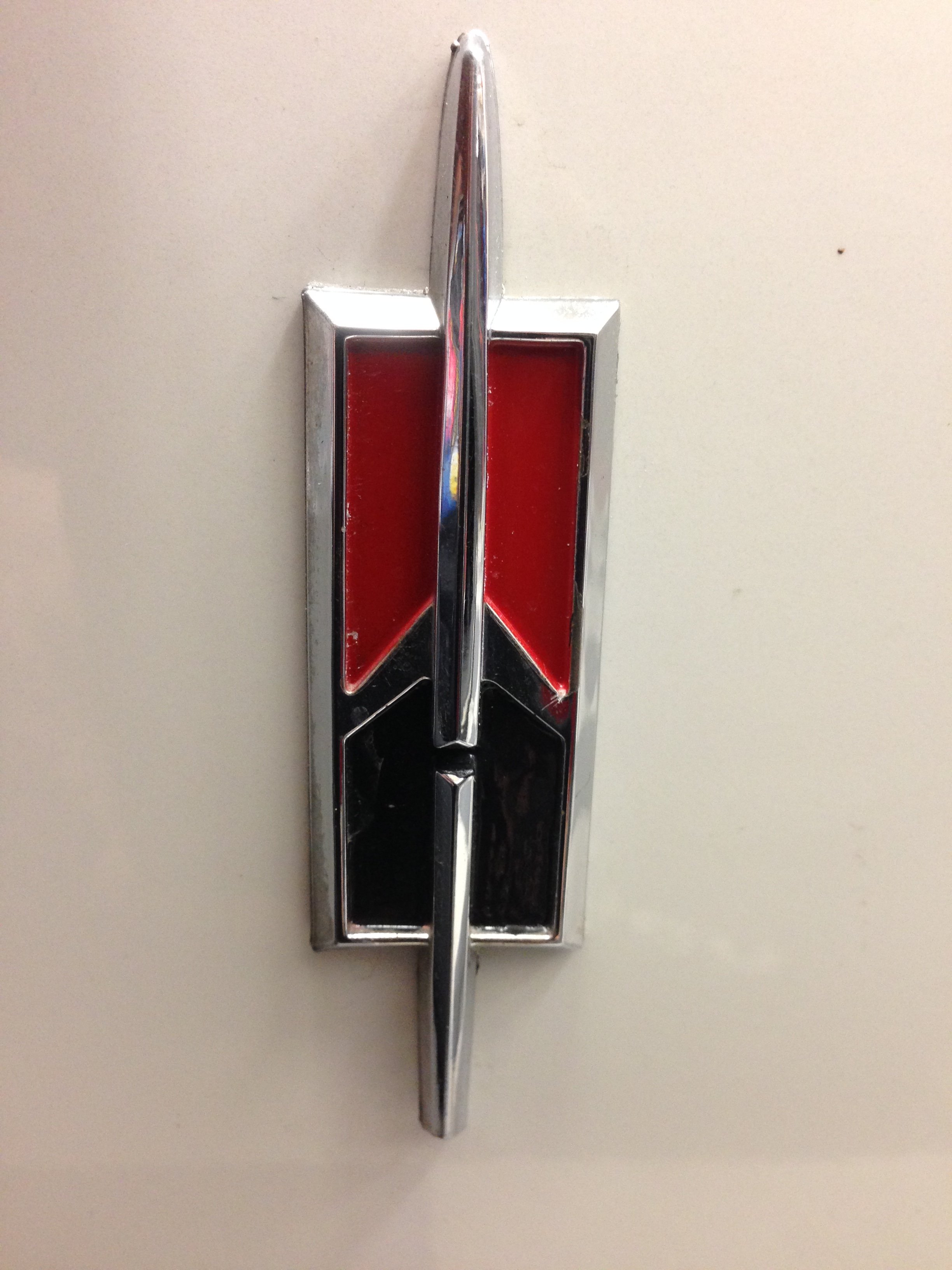

I dug out some Testors gloss black enamel and a fine brush tonight from my model supplies that I haven't touched in about a zillion years. Decided to do a little detail work, and repaint the rocket logos on the center caps. Some lacquer thinner and trusty Q-tips cleaned up the edges where I got a little shaky.
I originally wanted to paint them to match my already "customized" fender badges...
...but with the way the rockets are inset opposite to the fender ones, it wasn't possible. Oh well. I think they turned out pretty well nonetheless.
