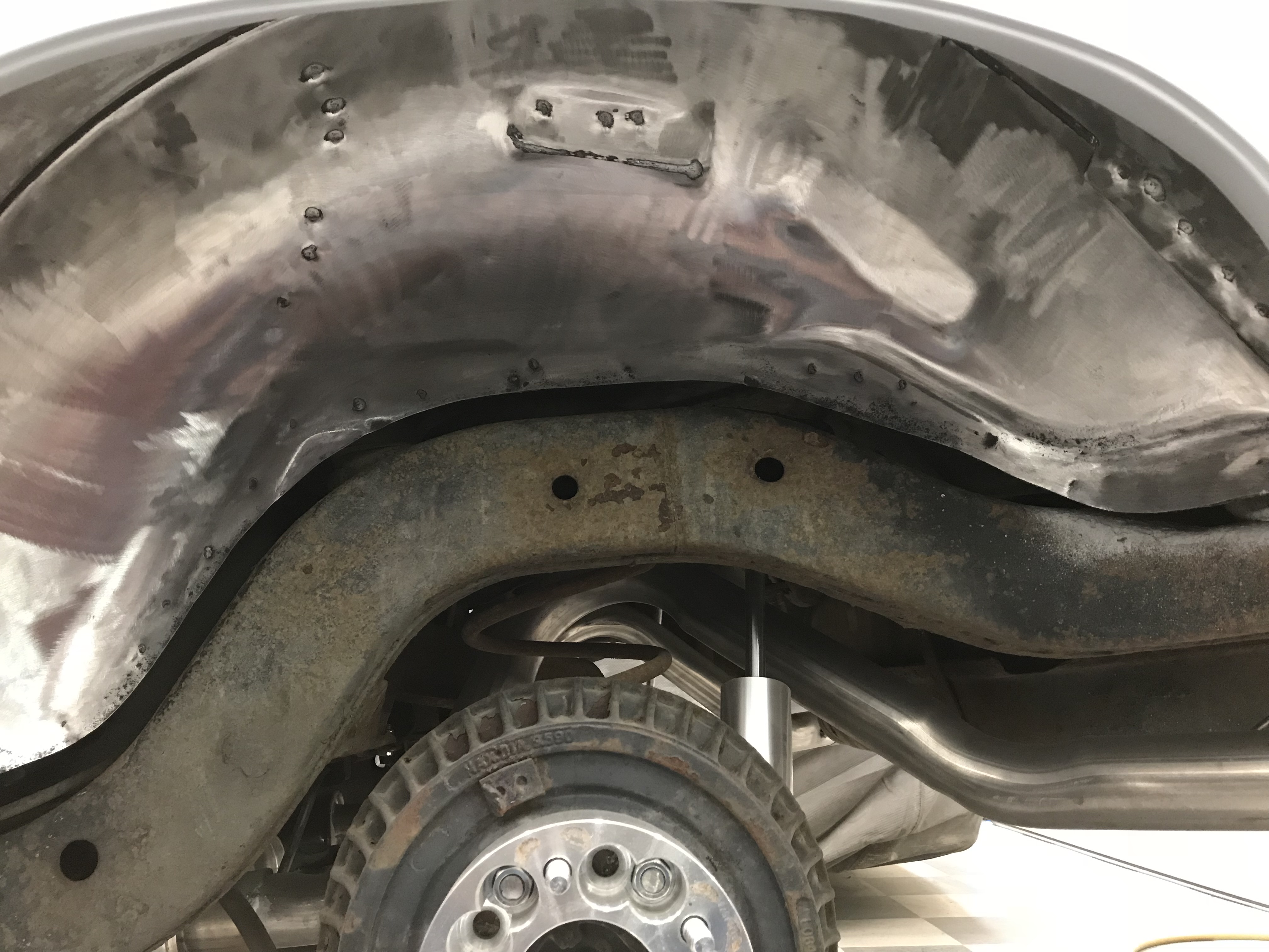

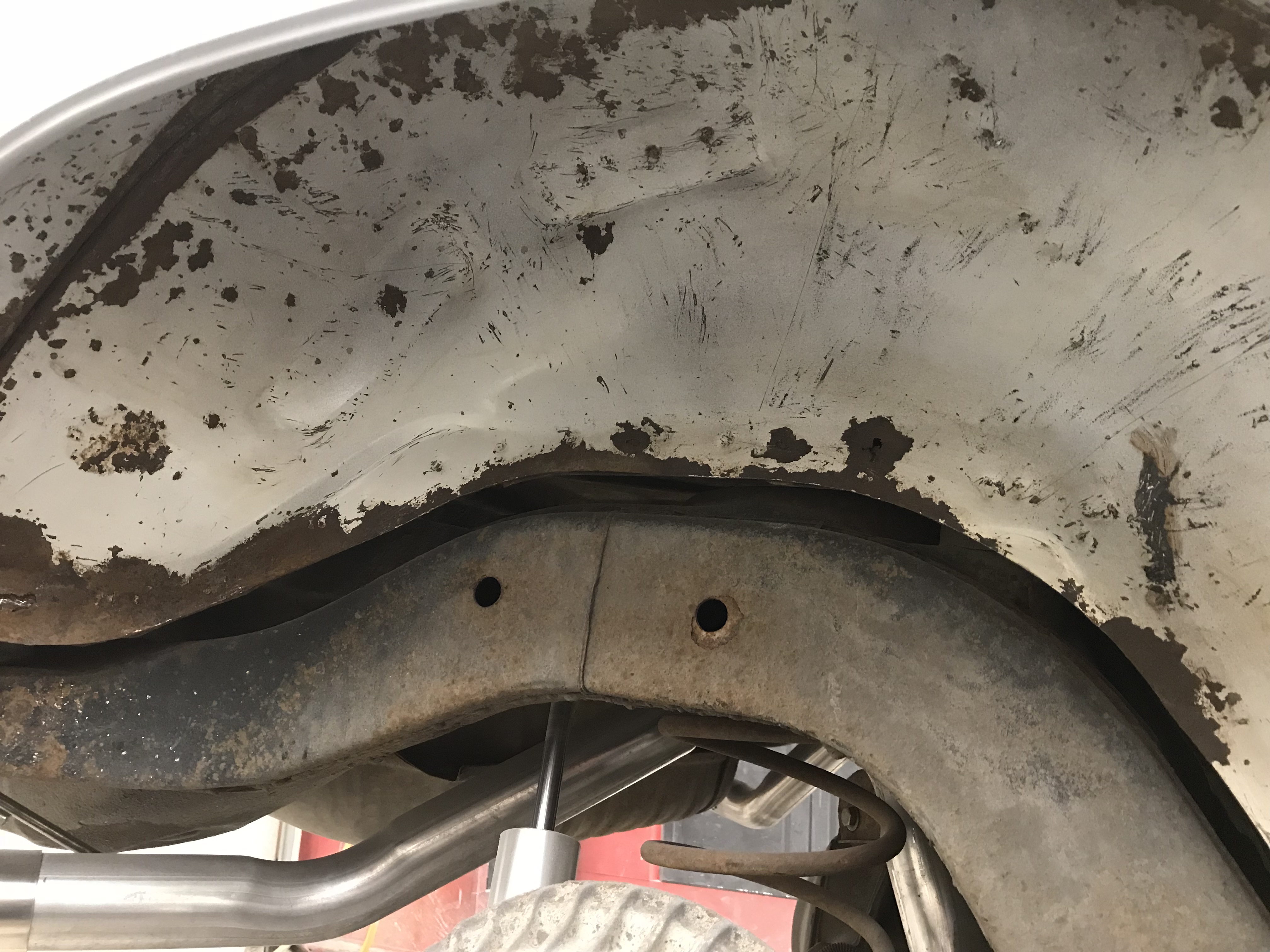

Not a whole lot to report on this week, after seeing Mike struggle so much with welding in a patch on the driver’s side wheel well last weekend, I figured I had better give him a hand with it during the week while he was gone.
I finished off what he had left to do, then made and burned in two more patches that needed to be done on the same side. No pics of that process, it’s not terribly interesting anyways.
In my usual overkill manner, I decided I couldn’t live with the state of the existing paint and condition of the wheel well, so I went after it with the fibre wheel and started stripping the old paint and crap off. I’ve got most of the inner wheelhouse done, just a bit left to do on the outer and the seam between the two.
Once the seam is thoroughly cleaned out, the entire well will receive a couple coats of epoxy and a good scuffing before new seam sealer gets applied. Once that’s done, it’ll be time for the finish coat. At this point in time, I’m thinking of applying a couple coats of spray-in truck bed liner. That stuff is near indestructible and has a finish very similar to the undercoating that was in there before.
Should look good.
These are the pics of how the wheel well looks now, the patches have all been welded in already and dressed down. The remaining rust pitting along the pinch weld flange has also already been addressed, it was treated with some rust converter, and should now be neutralized.
Unfortunately, there is still the passenger’s side left to do...

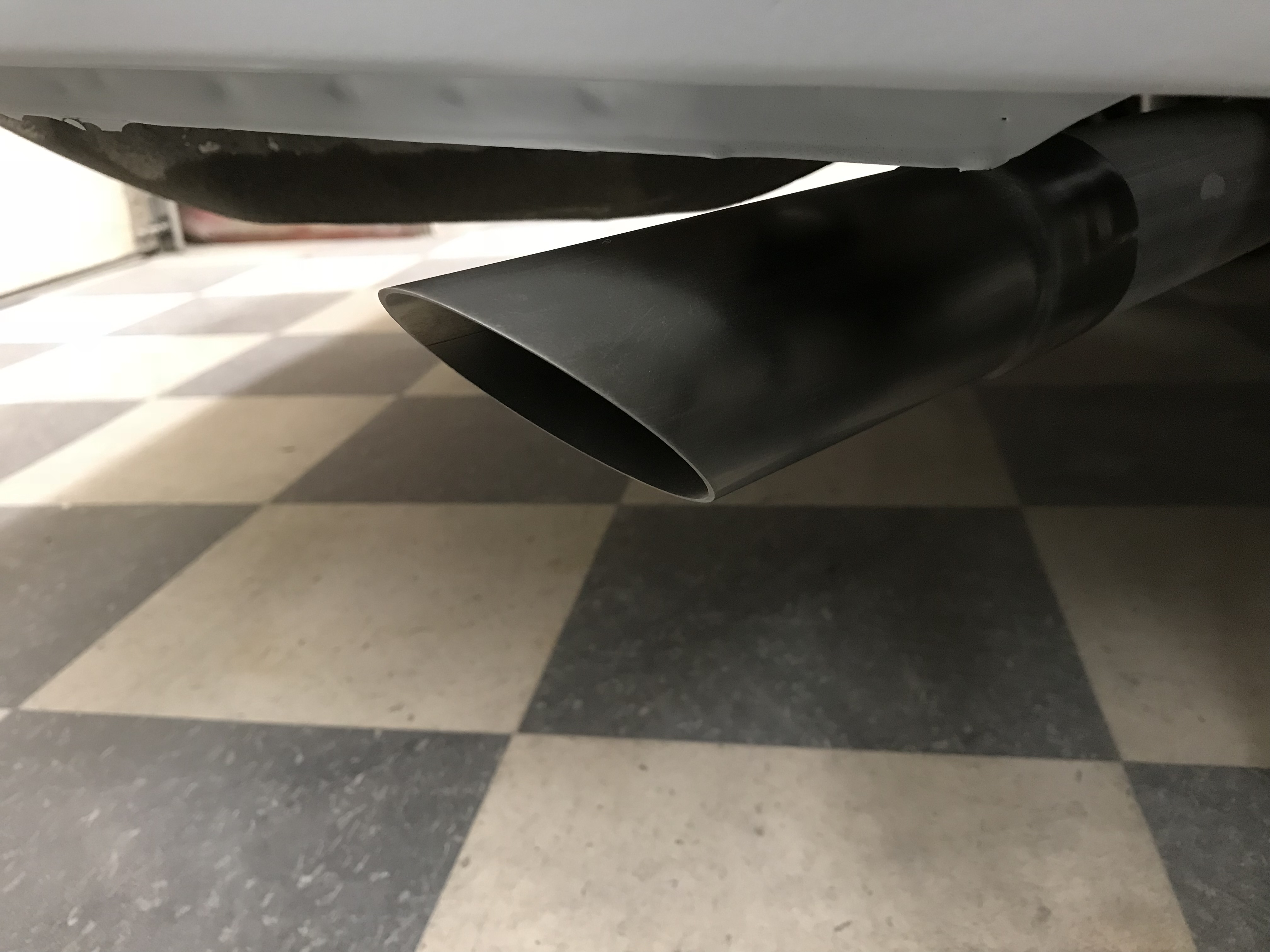

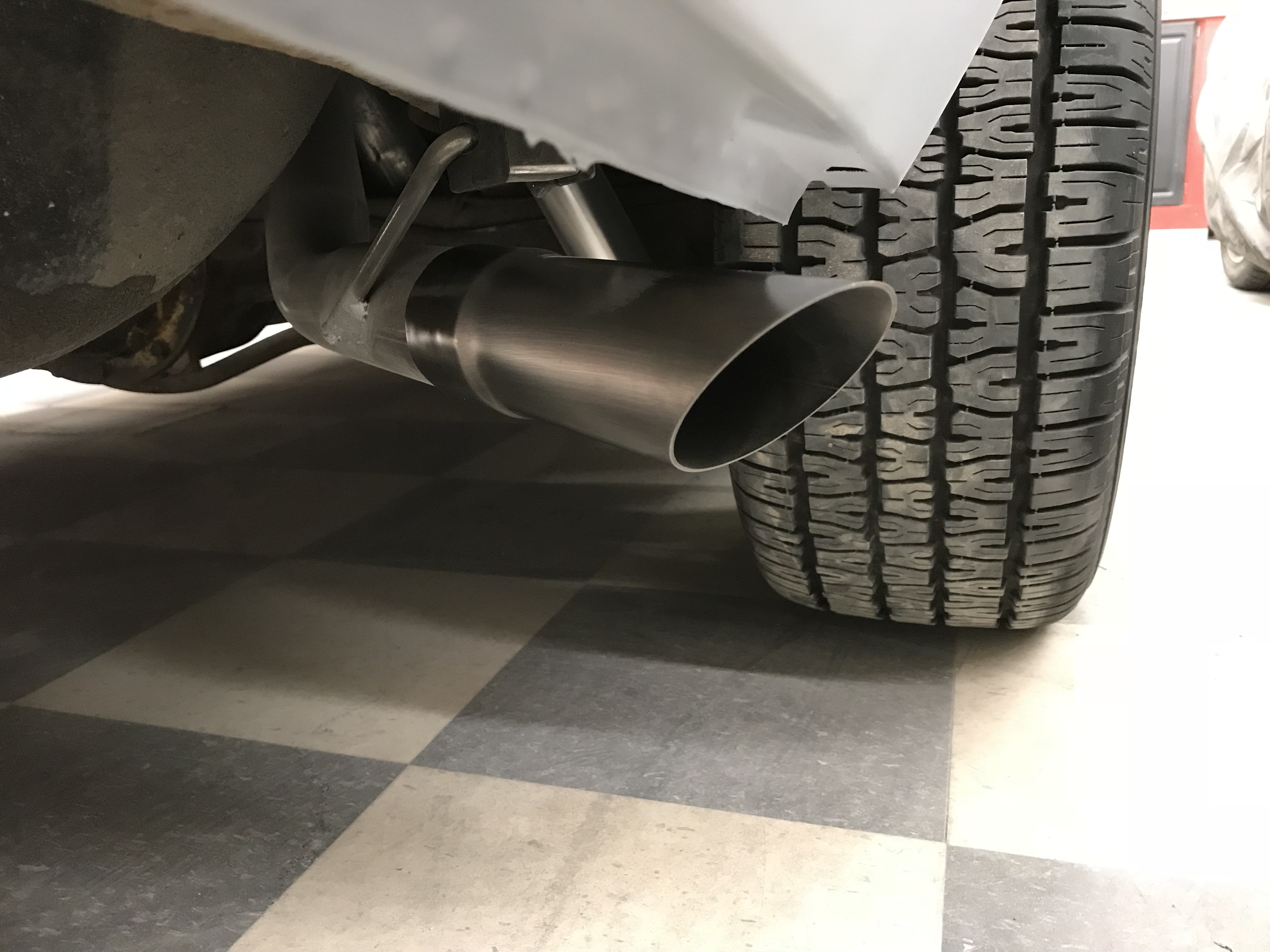

Something that I keep forgetting to mention too, is several months ago I picked up a different set of tailpipe tips. A couple of you had mentioned that the ones I had picked up earlier didn’t exactly suit the car, and in hindsight, you were completely right.
To better suit the style/build/theme, I found some 2 1/2” polished stainless slash cuts, 8” long. It’s tough to see in these pics due to the lighting and angles, but I gave them the brushed treatment to match everything else. They’ll get tack welded on for this year while I’m driving the car, but will have to come off again to properly access the underside of the quarters when the car goes for paint.

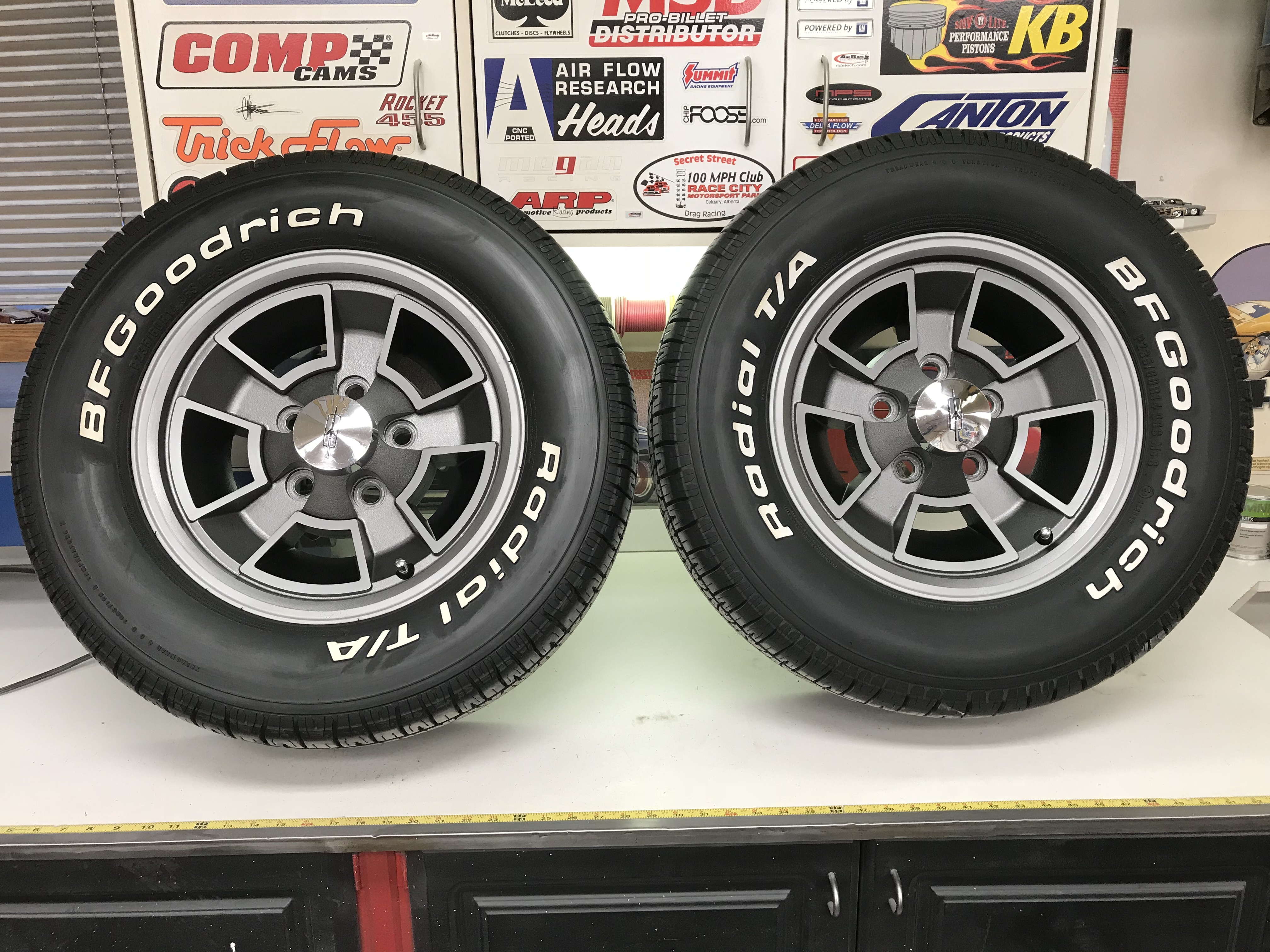

This morning we finally caught a much needed and long overdue break in the weather, so I loaded up the front wheels and new tires I picked up a couple weeks ago, and headed off to get them mounted up.
My four legged buddy Tucker wanted to enjoy the sunshine and warmer temps today as much as I did, so when they were ready, we both jumped in the truck to go back and get them.
“C’MON DAD, let’s GO!!
:rofl:

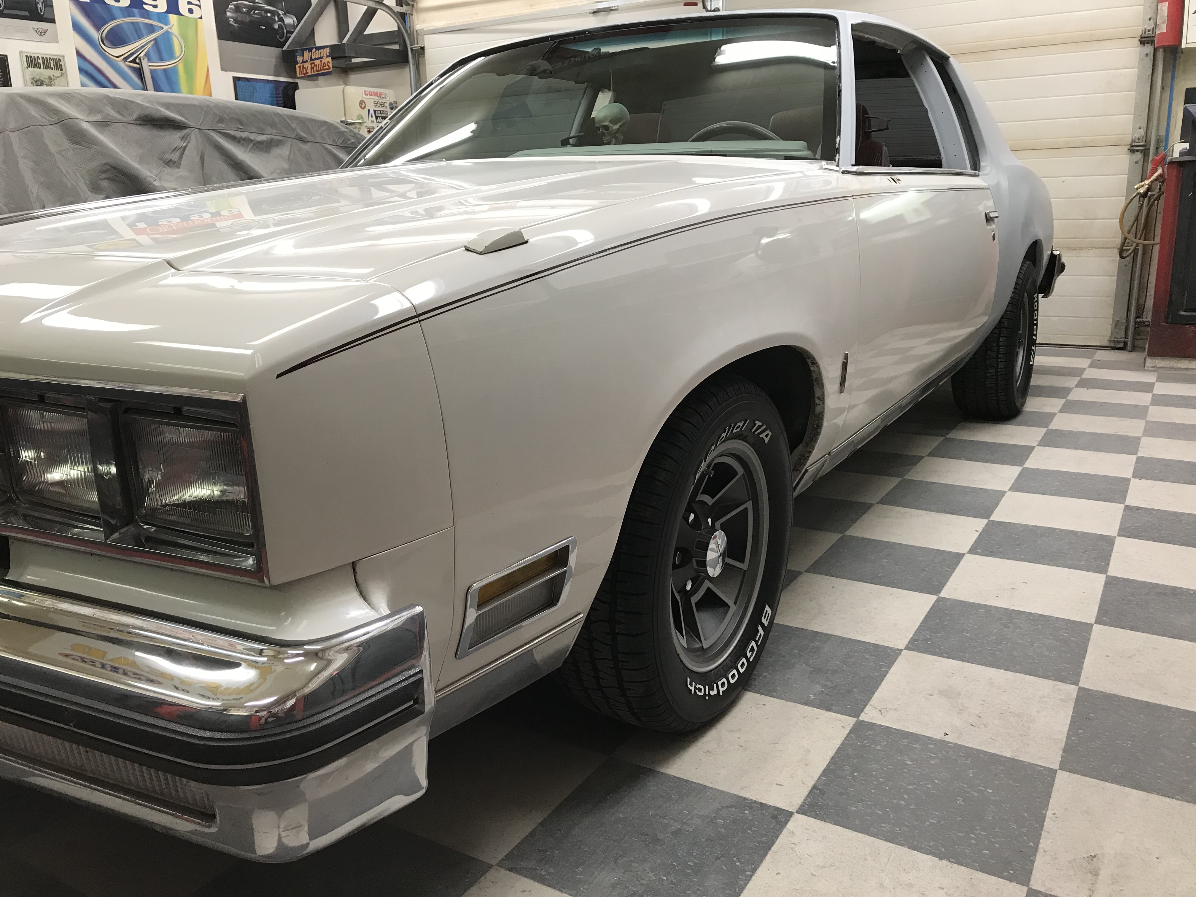

Once back in the garage, I cleaned up the fronts...
... followed by the rears since they were off already anyways and desperately needed it after months of being covered in body filler dust.

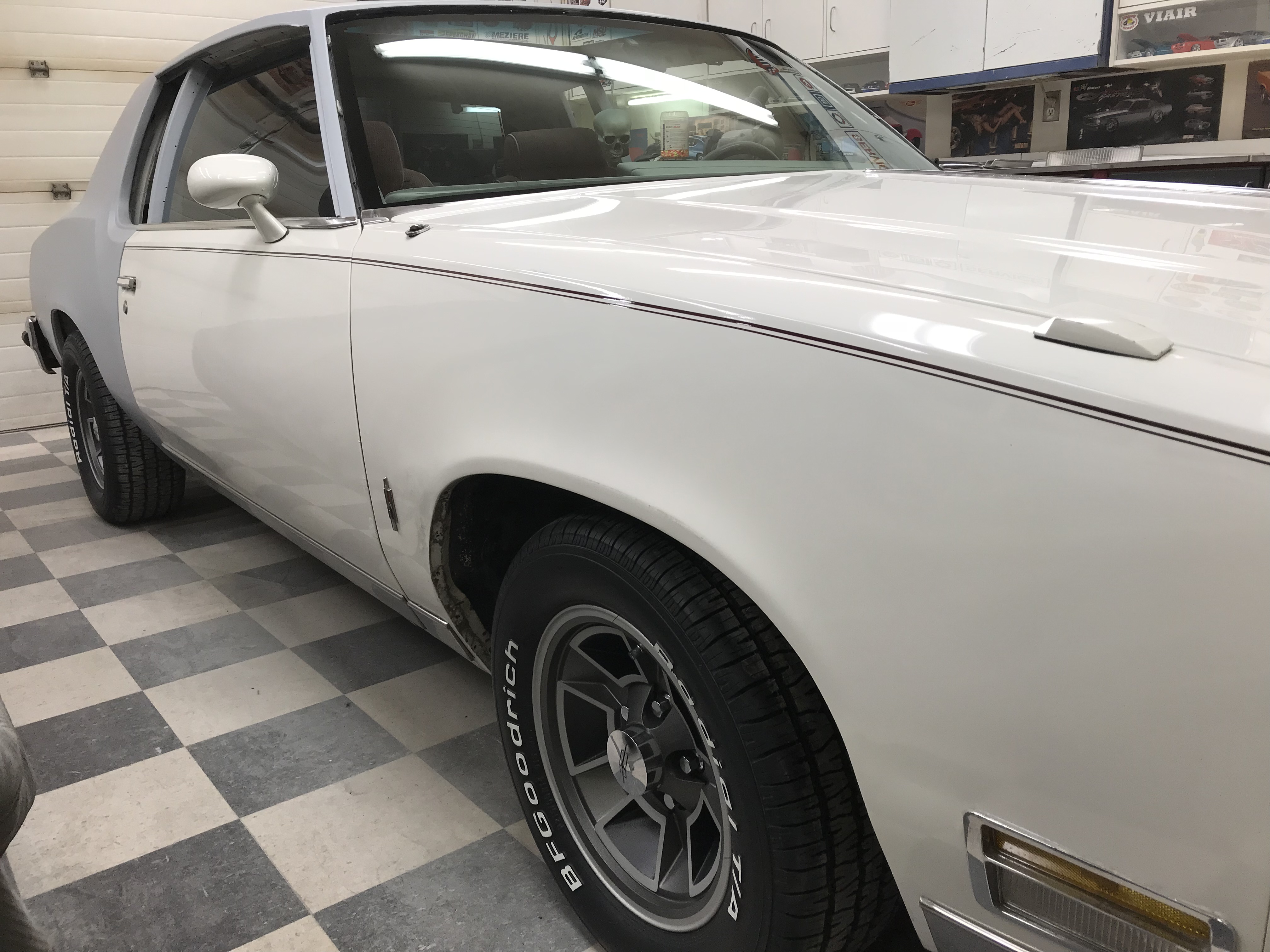

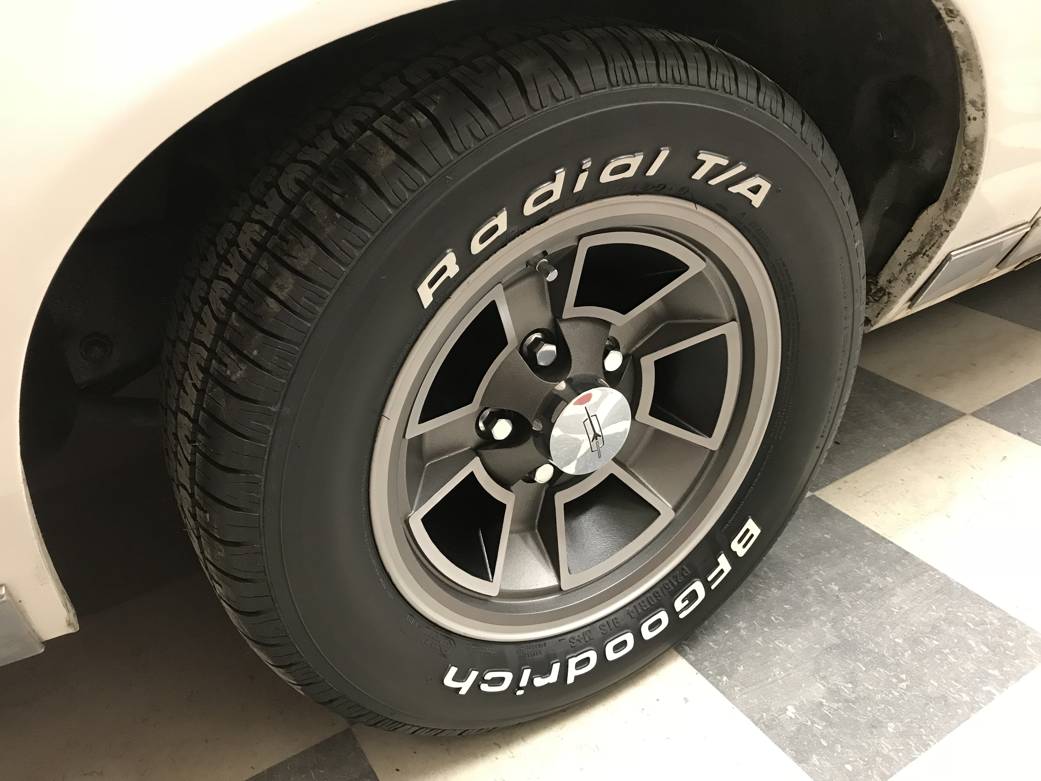

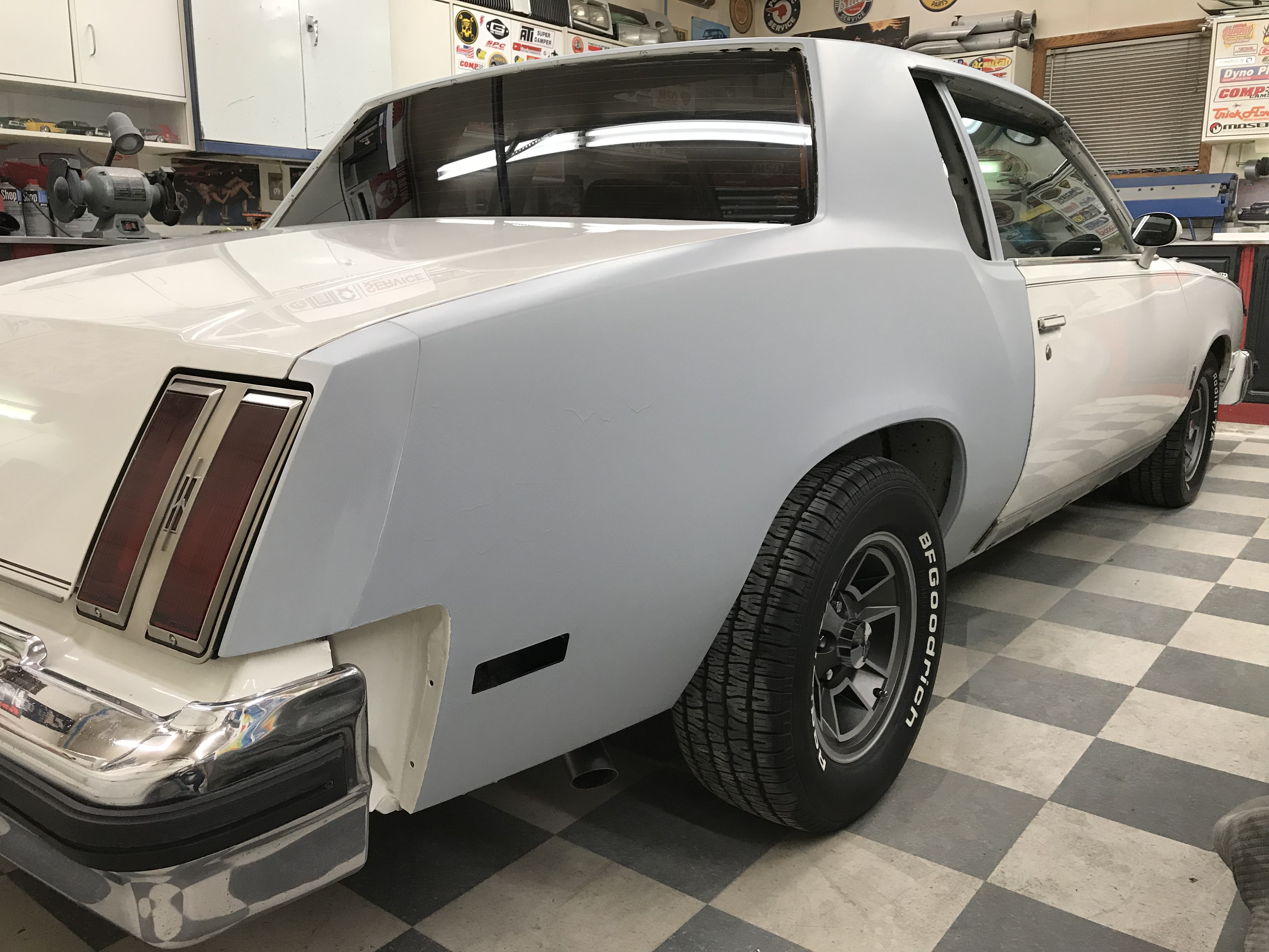

Time to get ‘em back on the car!
I think these fit the bill nicely. They’re not quite so wide on these narrow wheels, and look more at home especially on the front. The car also now has a nice little rake to it, nothing major, but just enough to make it look good.

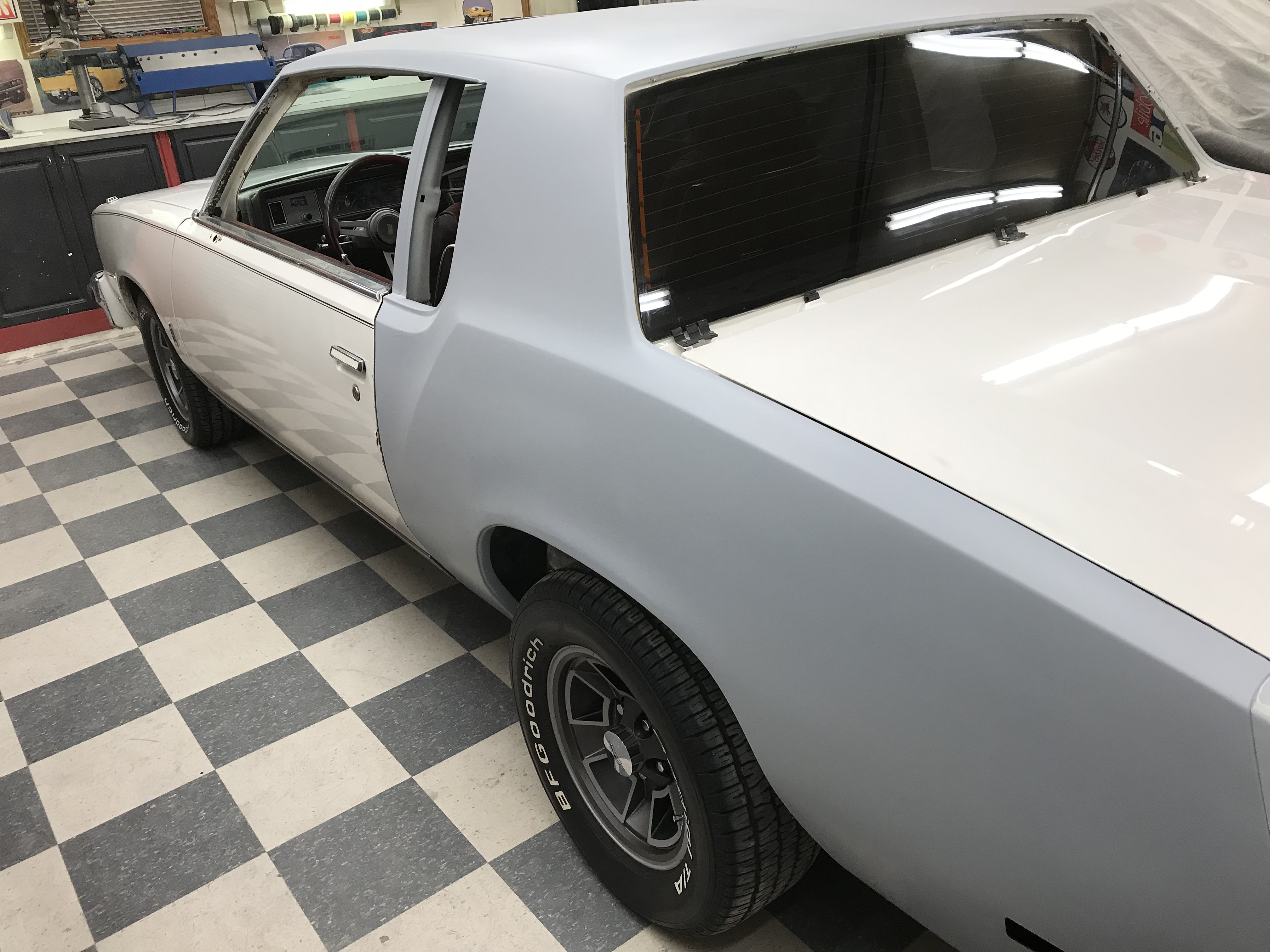

The last few days I’ve been slowly getting back into working on the car again, and by last night I had finished stripping the last of the old paint from the rubber(?) filler panels that go between the quarter panels and the back bumper.
These pieces are absolutely horrible, I cannot put into words my incredible dislike of them. They’re made of some sort of strange rubber/polymer compound or something, and are extremely difficult to work with. Virtually every one you see has the paint cracked on them because they’re so soft and flexible nothing will flex with them.
And sanding them is something else as well. It doesn’t matter if you use 400 grit or 120 grit, the material seems to “self heal” and all leaves the same finish. I despise these things and would skid them in a heartbeat if I only could.
Anyways, I had to go on a resupply mission earlier this week to get some more materials including paint, so I picked up these...
....plus some Bulldog adhesion promoter and reducer that was back ordered:
With my interest gradually coming back again and the materials I needed in hand, tonight I prepped up the filler panels with a thorough cleaning of wax and grease remover and then hit them with the tack rag and a couple coats of the Bulldog.
Here they are ready to go:
I mixed up the white with an additive of 10% flex agent, and got to shooting them.
Here’s tonight’s progress:
Not bad considering that’s a 120 grit finish on there!
Once these are dry and fully cured, I’ll install them back on the car at least temporarily. Right now the huge gaps on the car where these go are bugging the hell outta me.
The next things to receive attention will be to get back on the rear wheel wells and start on the filler panel between the back window and trunk lid. It’s currently the wrong colour and has a bit of body work to be done on it.
