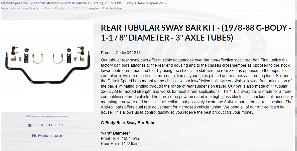

This is the one I bought today. Bigger than 7/8" or 1", smaller than 1-5/16" or 1-3/8", hollow and lighter than the big solid bars, not nearly as stiff as the big solid bars but stiffer than the smaller hollow bars. Middle of the road pricewise. I'll put it on and the slicks and hit the pavement this weekend. I will update.
Non-adjustable links so you will not be able to dial in any preload.
