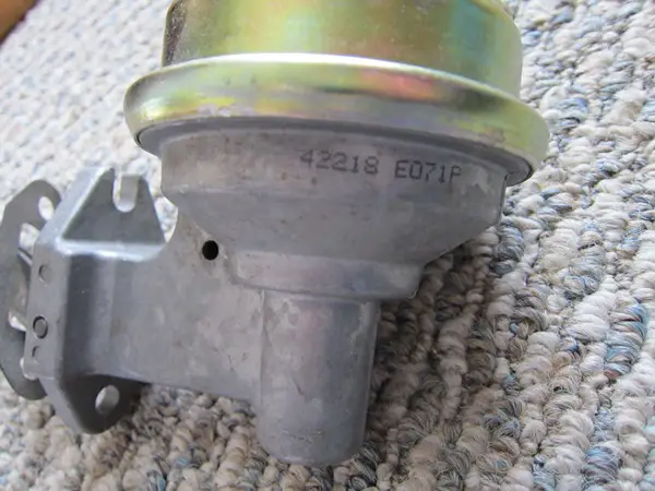

Others will fit and work that has a return vent, but that part number was only listed to fit 85-up VIN 9 engines. But it first appeared in the 84 H/O Dealer Bulletin announcing the availability for the 84 H/O, although it never made it in the parts books. Nothing special about it that I can see but I have no idea why it's different p/n than the others.
They're hard to find. I'm down to about a half dozen of them.
The ACDelco number 42218 was stamped on some of them.
