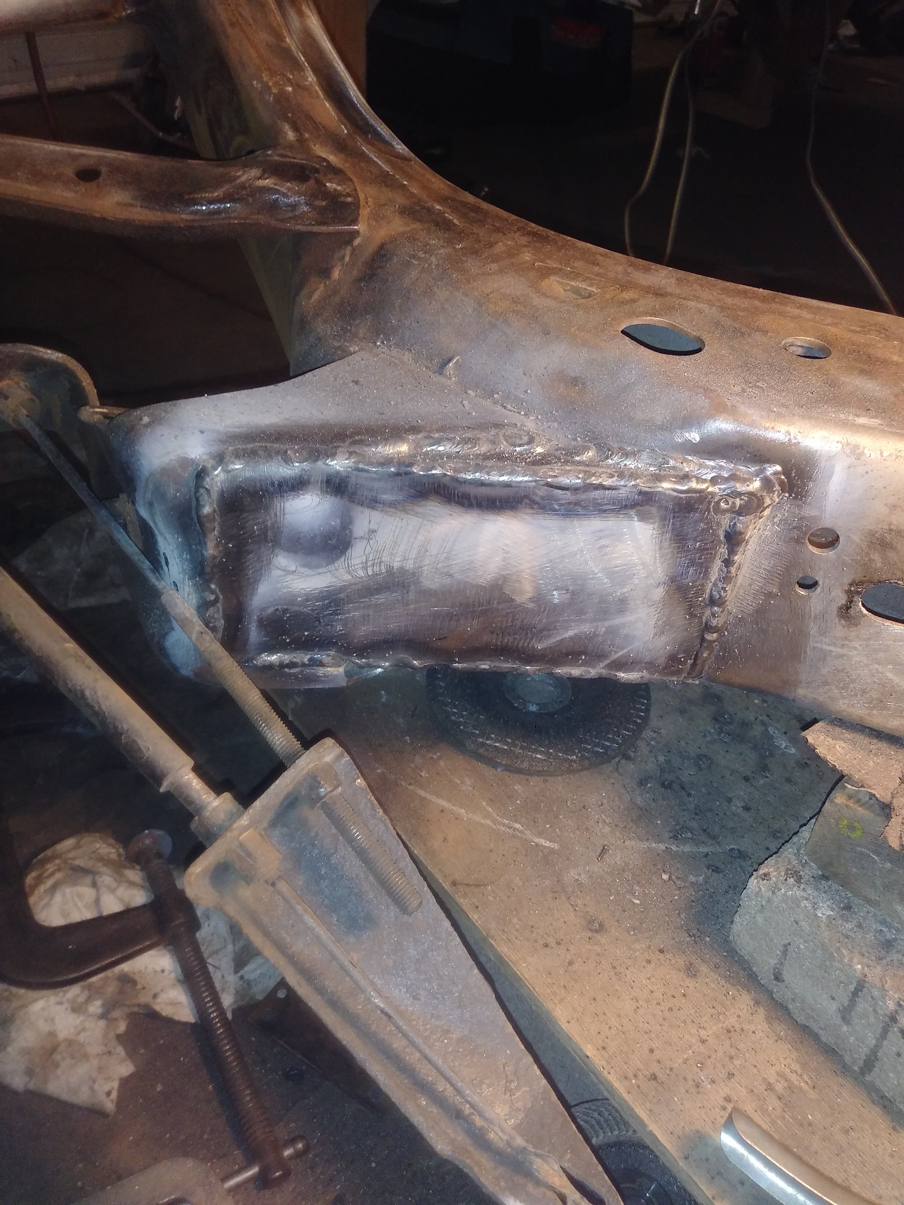

I used 14 ga metal to box in the lower control arms. Just traced my cardboard template onto metal. I welded the triangle braces first.
I made spacers and bolted the LCA so it wouldn't move before welding. I also painted the spots that are unreachable after welding. Then I clamped on the outside piece and welded it shut.

I used 14 ga metal to box in the lower control arms. Just traced my cardboard template onto metal. I welded the triangle braces first.View attachment 160889
I made spacers and bolted the LCA so it wouldn't move before welding. I also painted the spots that are unreachable after welding. Then I clamped on the outside piece and welded it shut.View attachment 160890View attachment 160891
