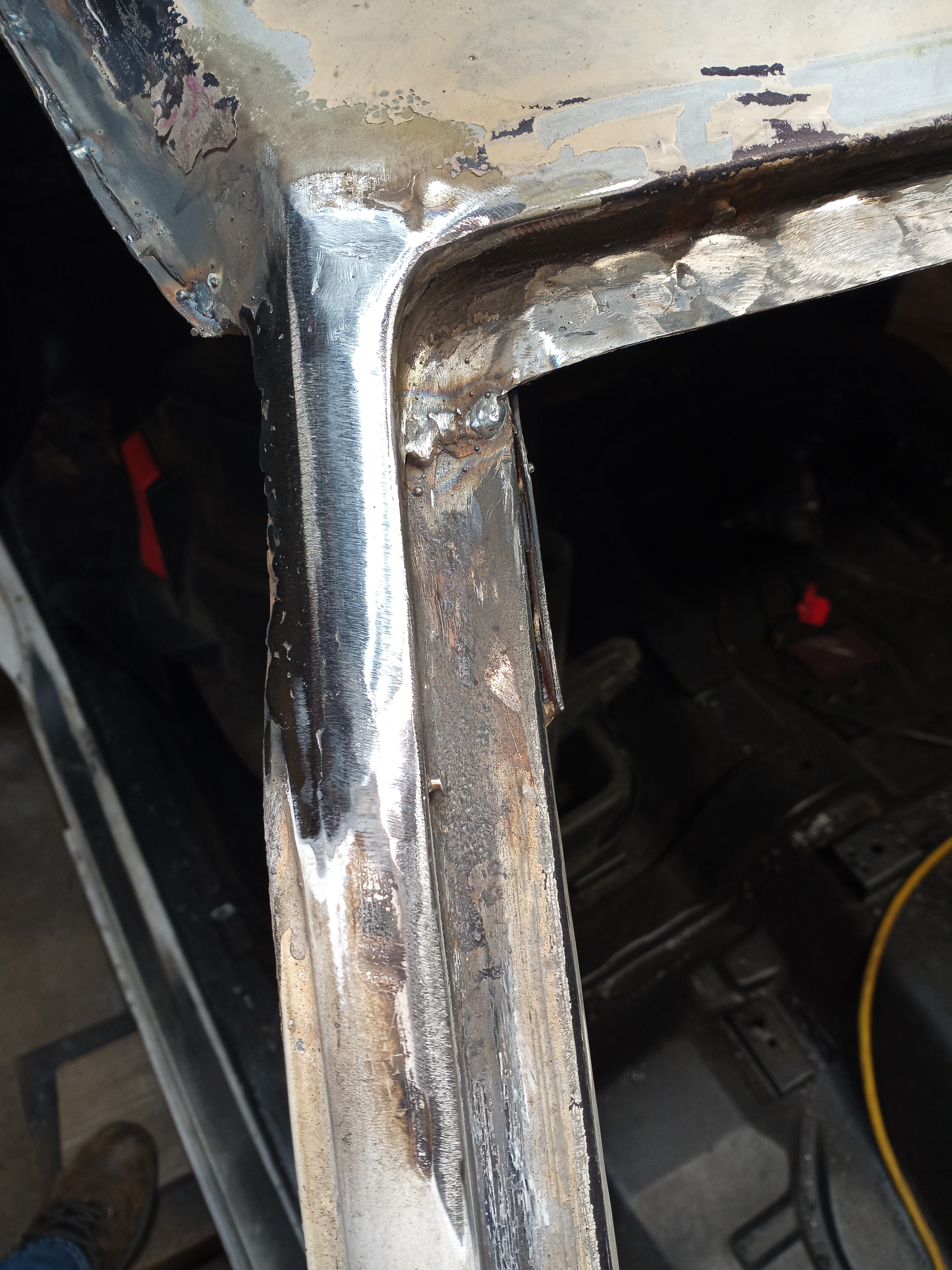

I been grinding the welds in the window channels and filling any holes I missed.

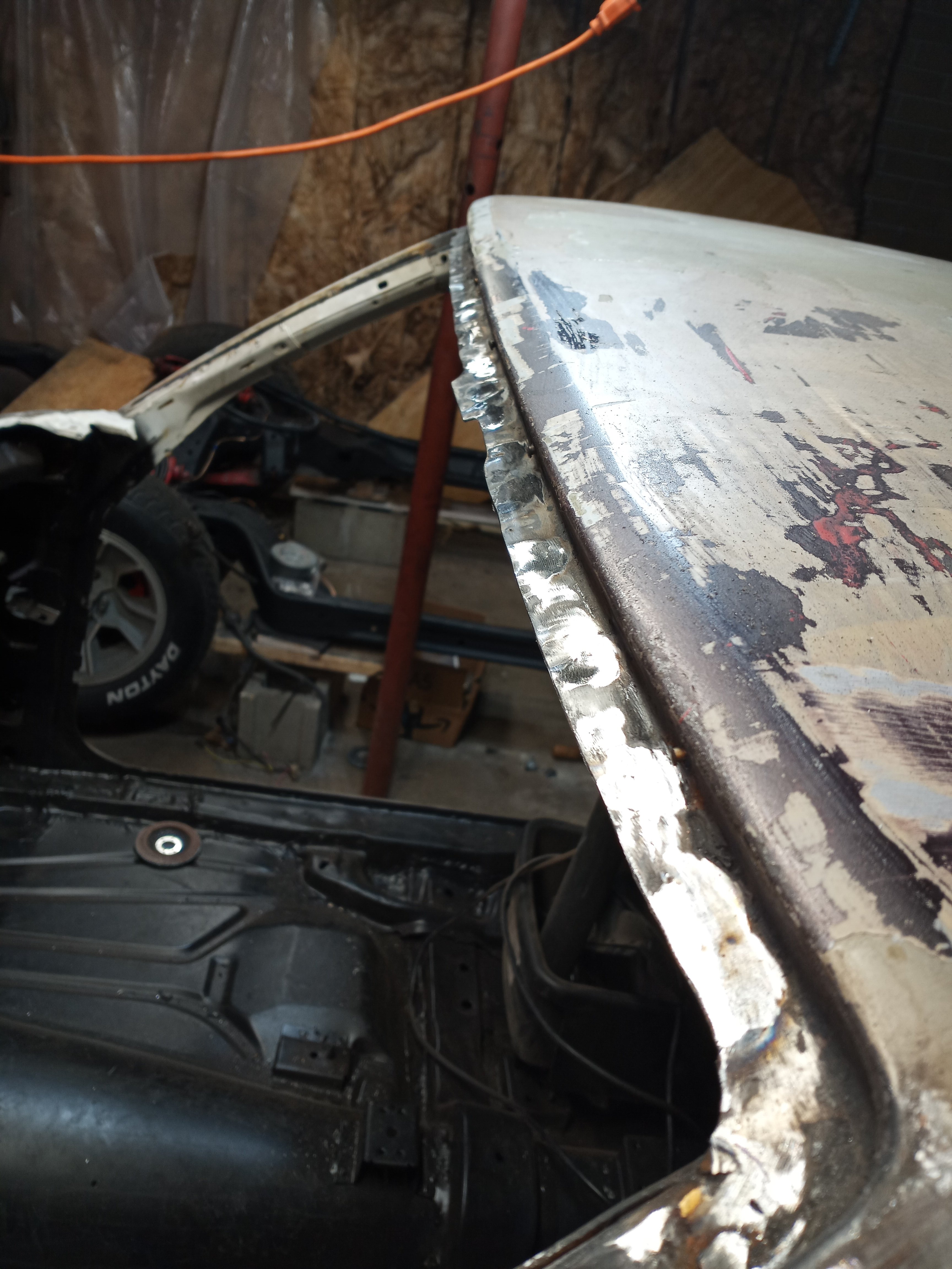

I started filling in the passenger A pillar seam with weld. I just stacked welds on top of each other until it took shape. I'm not sure how the left side is supposed to look, were the drip rail meets the pillar. I could use a picture of this area finished with the molding on it.
the underside view there's a big gap.
Here's the top finished out.
Its much more time consuming and tedious then I expected.

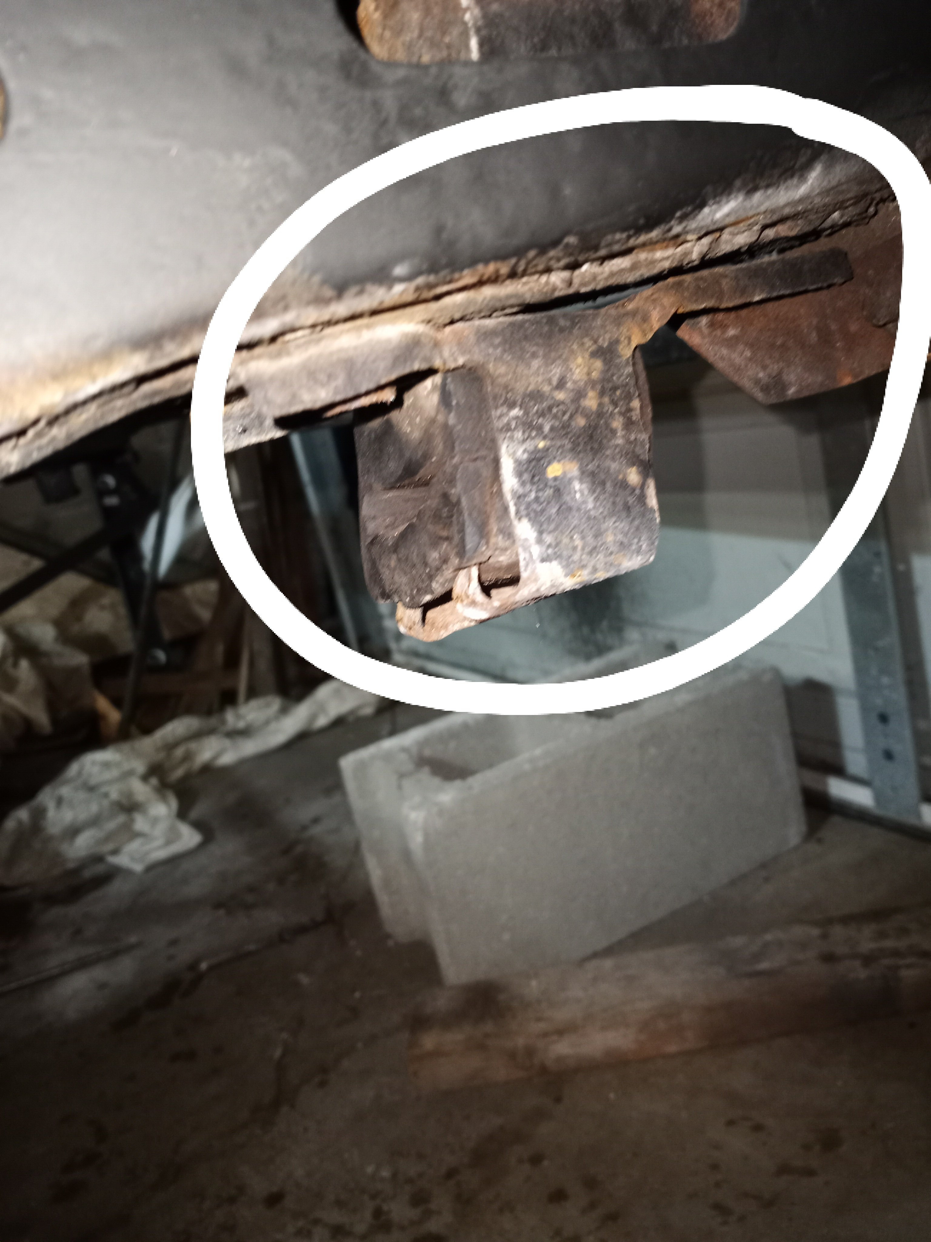

What is this and is it necessary? The frame needs about an 8" patch on the bottom and it looks like it goes under that bracket. I want to cut it off so I can make the patch. The bolt is seized. Wd and torches didn't work
I been grinding the welds in the window channels and filling any holes I missed. View attachment 168977
I started filling in the passenger A pillar seam with weld. I just stacked welds on top of each other until it took shape. I'm not sure how the left side is supposed to look, were the drip rail meets the pillar. I could use a picture of this area finished with the molding on it.View attachment 168978 the underside view there's a big gap.View attachment 168979
What is this and is it necessary? The frame needs about an 8" patch on the bottom and it looks like it goes under that bracket. I want to cut it off so I can make the patch. The bolt is seized. Wd and torches didn't workView attachment 168982
That looks like the mount for the pinion snubber. They’re probably still available NOS, and definitely aftermarket. I’d say hack it off and get it the hell outta your way.

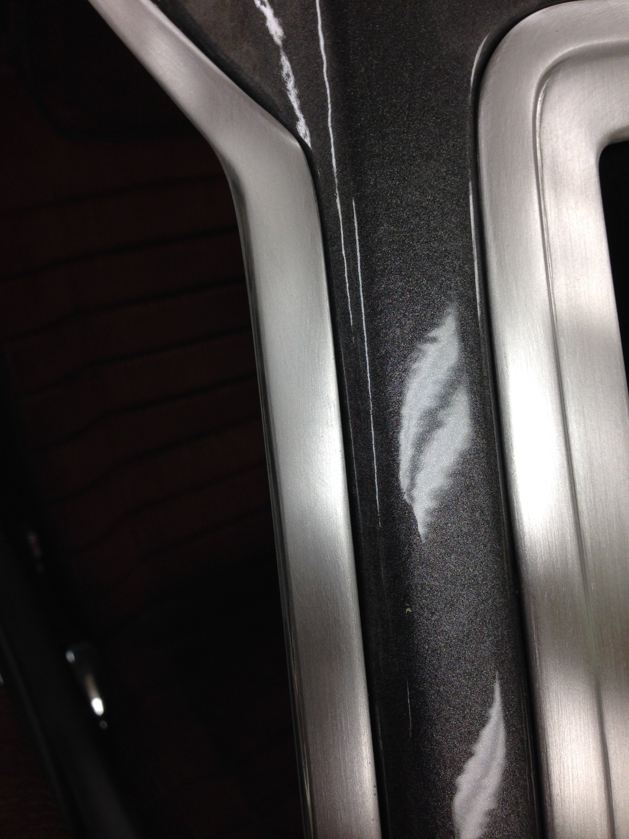

As for the “A” pillar area, hope this helps:
Thats exactly what I needed, much appreciated. My only question for gm engineers is where the hell is the water supposed to go? Maybe it all runs off the back of the drip rail.
Btw in case you didn't know, that "stainless" trim is the titz
The circled rubber in steel piece appears to be a frame mount for a muffler/tailpipe hanger to me. I have thrown out a bunch of them.
Correct, kind sir. The water channel is technically from the top front to the rear of the horizontal part of the trim molding. Water runs off the roof into the channel and out the backside. Then it pinches itself off in the front and is basically a water dam only along the sides of the windshield to try and collect water and direct it up and over the water gutter when driving (and minimize water onto the side window) and to allow it to drain into the fender area when stopped. It's a bastardized setup for sure. T-tops are even worse as there basically aren't any water gutters as most humans can relate to.

That is the MCSS exhaust tailpipe hanger.

That makes sense,thanks.I'll sure be glad when I start putting it back together. Its hard to find stuff for my 8 yr old son to do during this process. I don't wanna turn him loose with a grinder, welder etc. Plus even with a fan in the window the fumes can get pretty intense if the door isn't wide open.
Hell I thought factory monte ss tailpipes were under the back seat 😆
Thanks. I figure that means I have some leeway towards the front since it's supposed to go out back. In rktpwrds pictures the side of the roof and top of the A pillar are on the same plane and the molding is tight to the metal. I wonder (but not gonna do it) if cutting the drip rail off like NorthernRegal did would be better or worse for the water runoff.
Not sure. But if you notice, without the chrome piece on there, there IS no channel on the A-pillar. The chrome piece bolts up to actually make what little channel there is. Hence it acts more like a dam vs. a real rain gutter. Designed to last 10 years, and idiots like us keep playing with them 35-40 years later.
