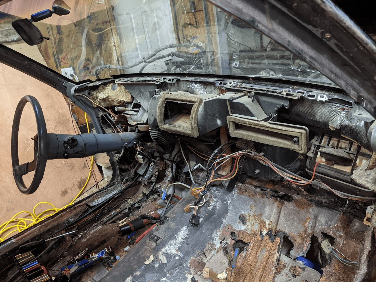

BUILD THREAD Rustier then I thought!!!

Is a frame off resto for everyone? Not even close. It takes a real commitment and dedication to see it thru(and about 15k). But your advice on replacing floors is spot on, only thing I'd disagree with is splitting the floor, only because it adds a crap ton of welding,grinding and seam sealing.

No disagreement here on that score, Mr. 64, For myself I wouldn't wish a floor pan job on anybody. Been there, done that, on my own Monte and no matter how much time you might budget for the work, it always takes longer, gets lot dirtier, and raises your blood pressure higher than recommended. In my case the only saving grace was that it was not my daily driver so I could come and go on the work as time allowed. And it almost always becomes a case of "While you're in there" as the floor pan work revealed that I had damage to the firewall under the heater box and that had to be cut away and replaced as well. Sorry, no photos of me in my bunny suit, sitting on the floor in the empty engine bay and applying wire feed love to the problem; it's better that way.

I was looking for an alternate - something a little less work. Though I had a line of something reasonably priced. Three time I tried to get the guy to let me come look at it. Every time I asked him to confirm a time and give me an address he ghosted me. At the same time he was advertising it on local groups etc. Either the guy was a scammer, or just wanted to deal a with someone sight unseen. Anyway, I've invested in the sheet metal at this point and am slowly proceeding, but it's going to be a ton of work. And probably a ton (literally) of MIG wire too.
