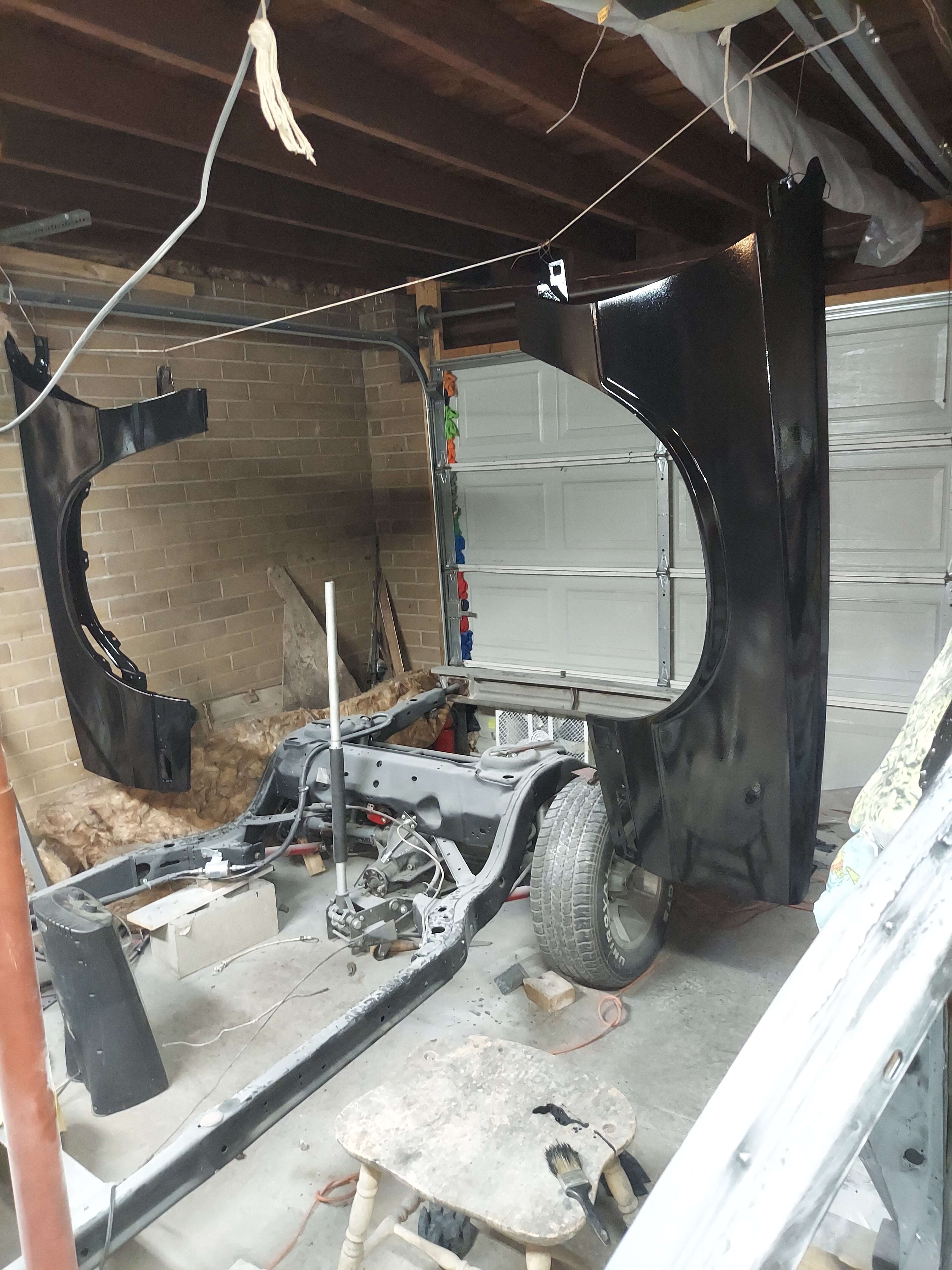

I got the fenders in epoxy. 2 wet coats.
I got runs in it again. I keep getting my gun too close. I need a guide or something lol. I also stuffed the old epoxy on the shell. I put 1 wet coat over it, but the filler just soaks that stuff up.

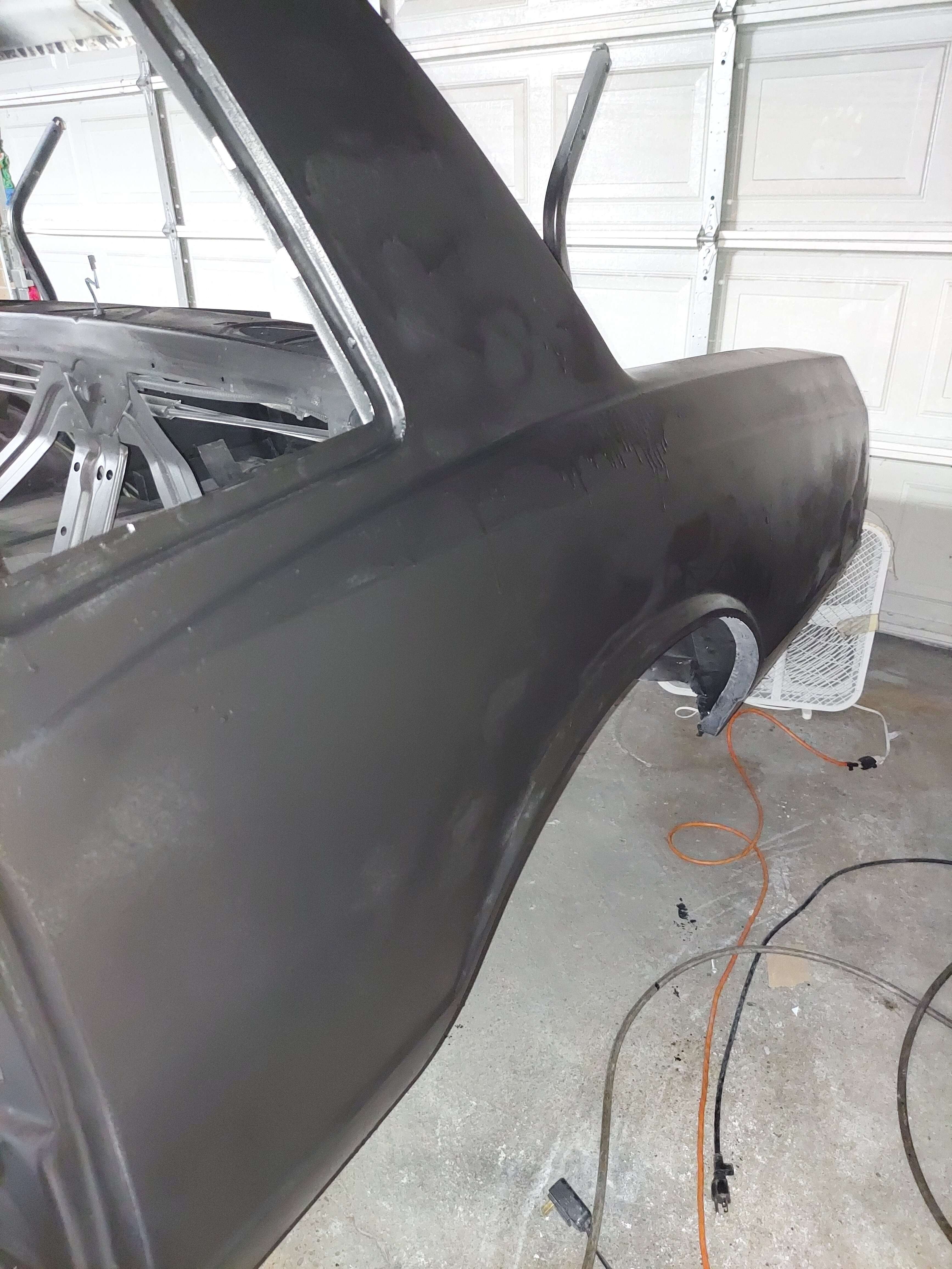

I got runs in it again. I keep getting my gun too close. I need a guide or something lol. I also stuffed the old epoxy on the shell. I put 1 wet coat over it, but the filler just soaks that stuff up. View attachment 208771View attachment 208772

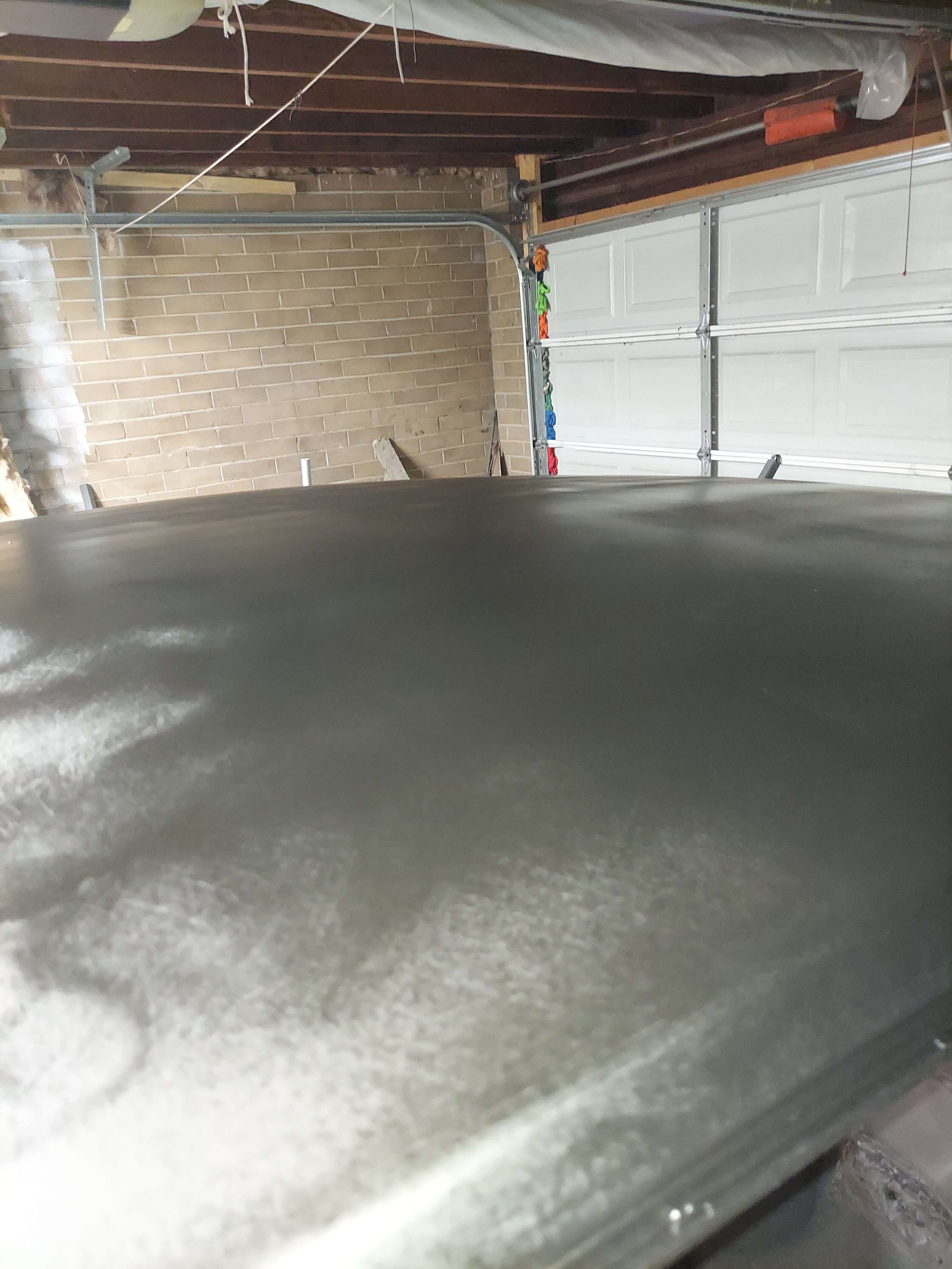

I got another wet coat on the shell. It covered all the filler spots. My gun technique is horrible, it especially shows on the roof.

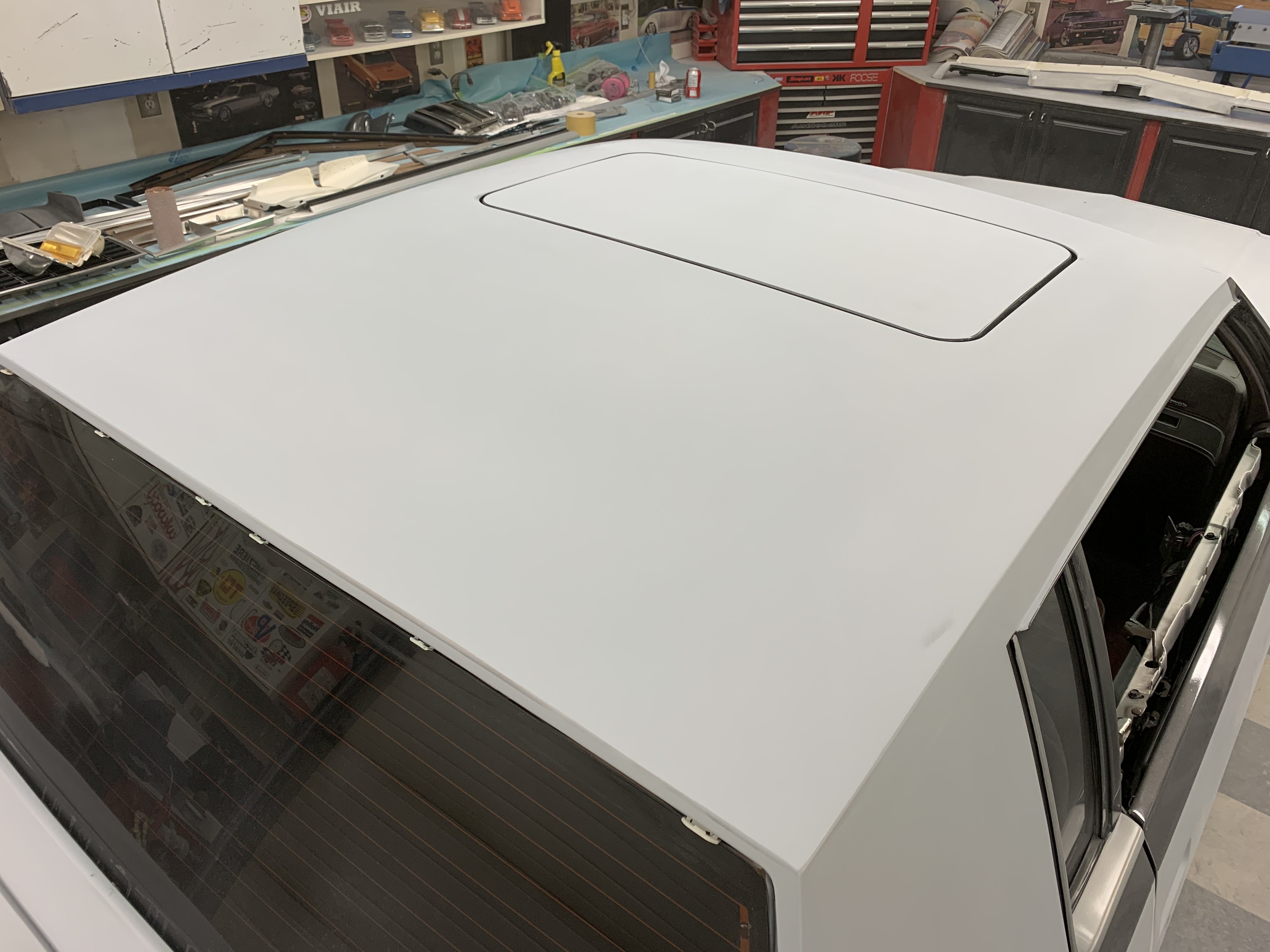

This afternoon I gave the roof a thorough cleaning and several wipe downs with wax and grease remover in preparation for starting the final block sanding process, then applied some dry guidecoat.
Here we go...!!

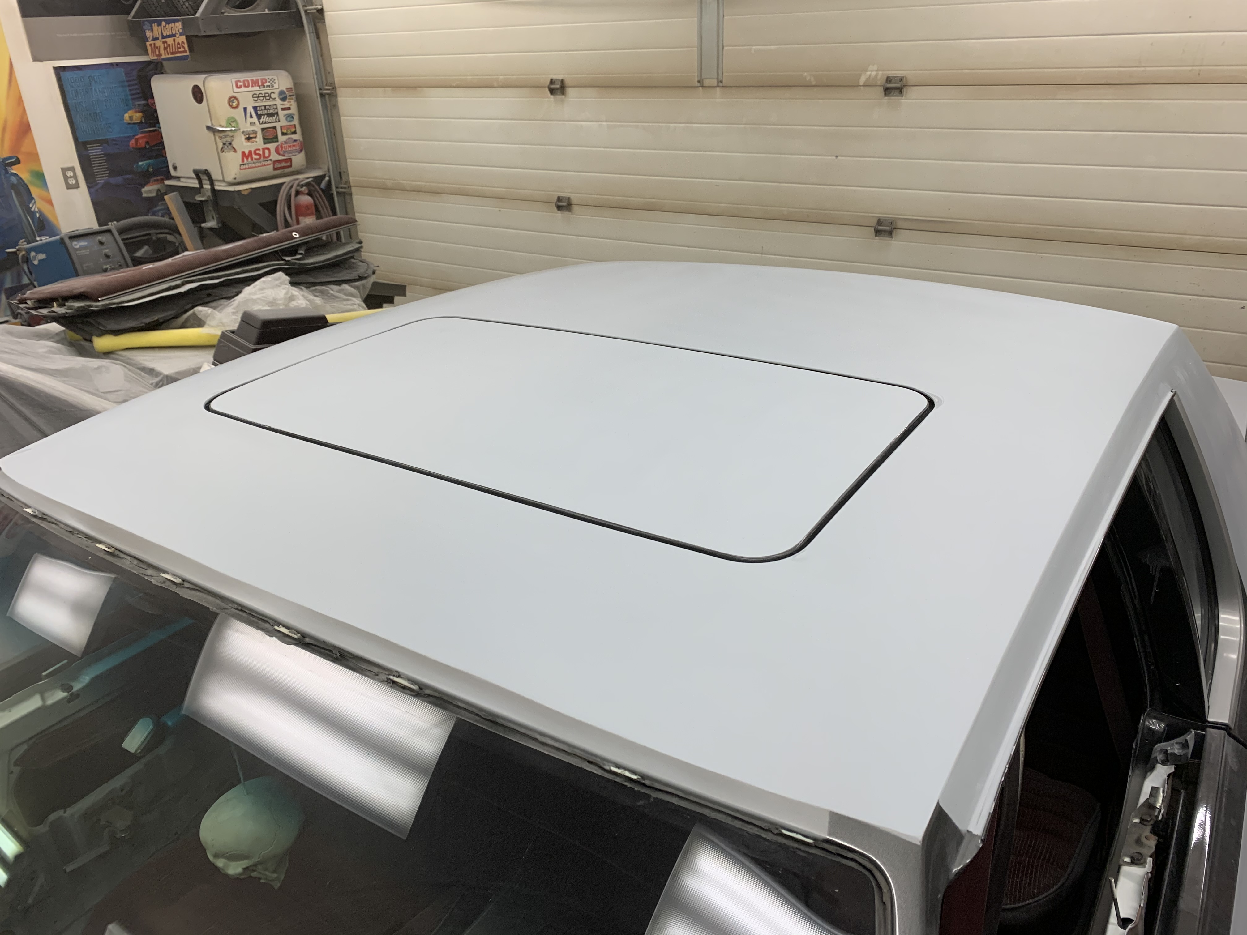

After a couple hours, I have all of the flat sections of the roof including the AstroRoof insert completely blocked out in 220. Found a couple of areas that will need some minor attention, but no big surprises thankfully.
She’s not quite smooth as glass yet, but it’s the first major step to getting it there. I’ll continue to block the entire car out in 220, then go back and spot prime any areas that need it before moving on to 320.

I really do wish it was that easy Rick, but I’ve got a bit of a journey left to go yet. Once I get the entire car to block out properly and evenly in 220, I still have 320, 400 and 600 wet grits left to go. Once I hit the 400 stage tho, it should really start going quickly as there’s not much material being removed, just enough to eliminate the previous grit’s scratches.
