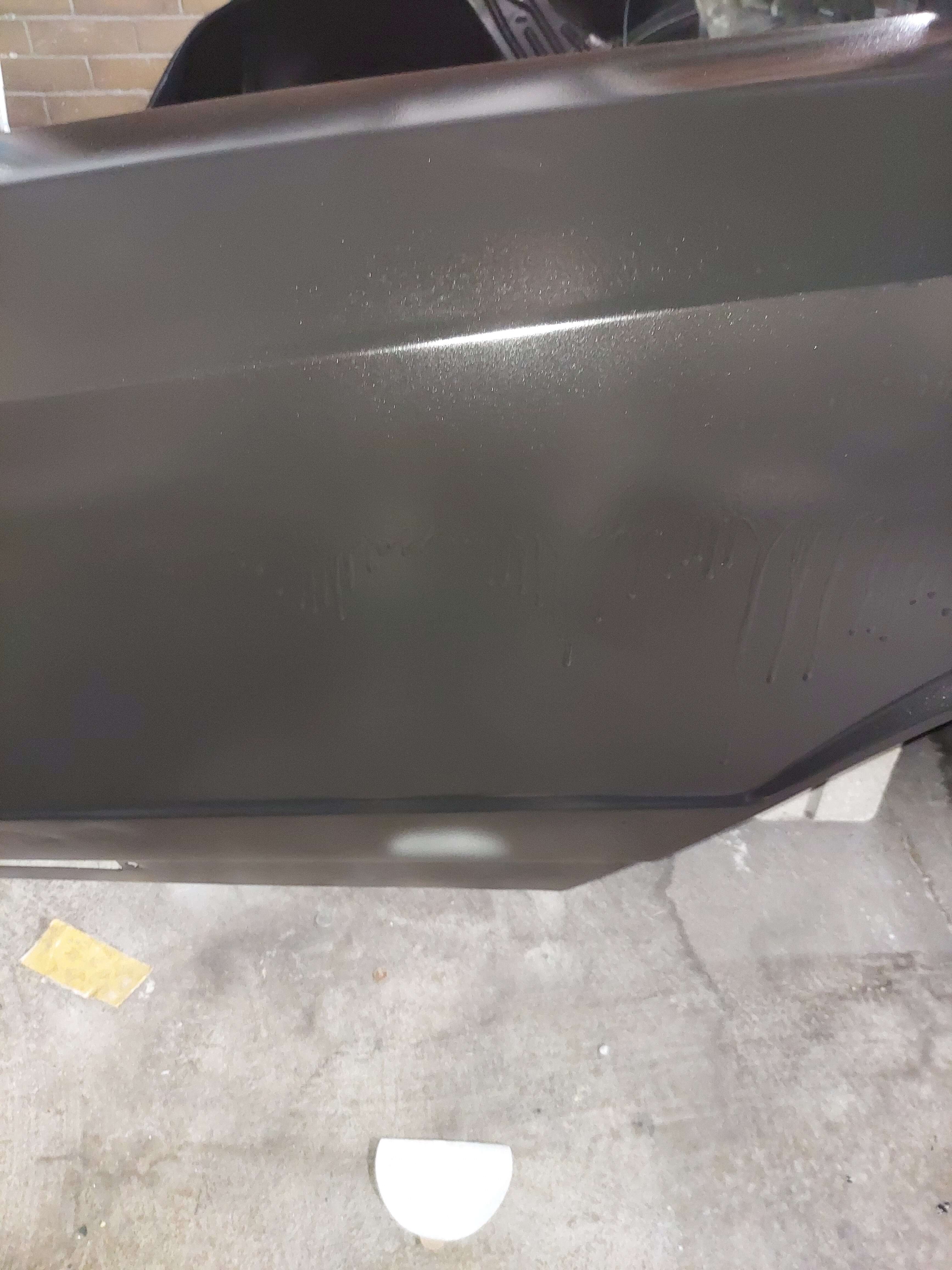

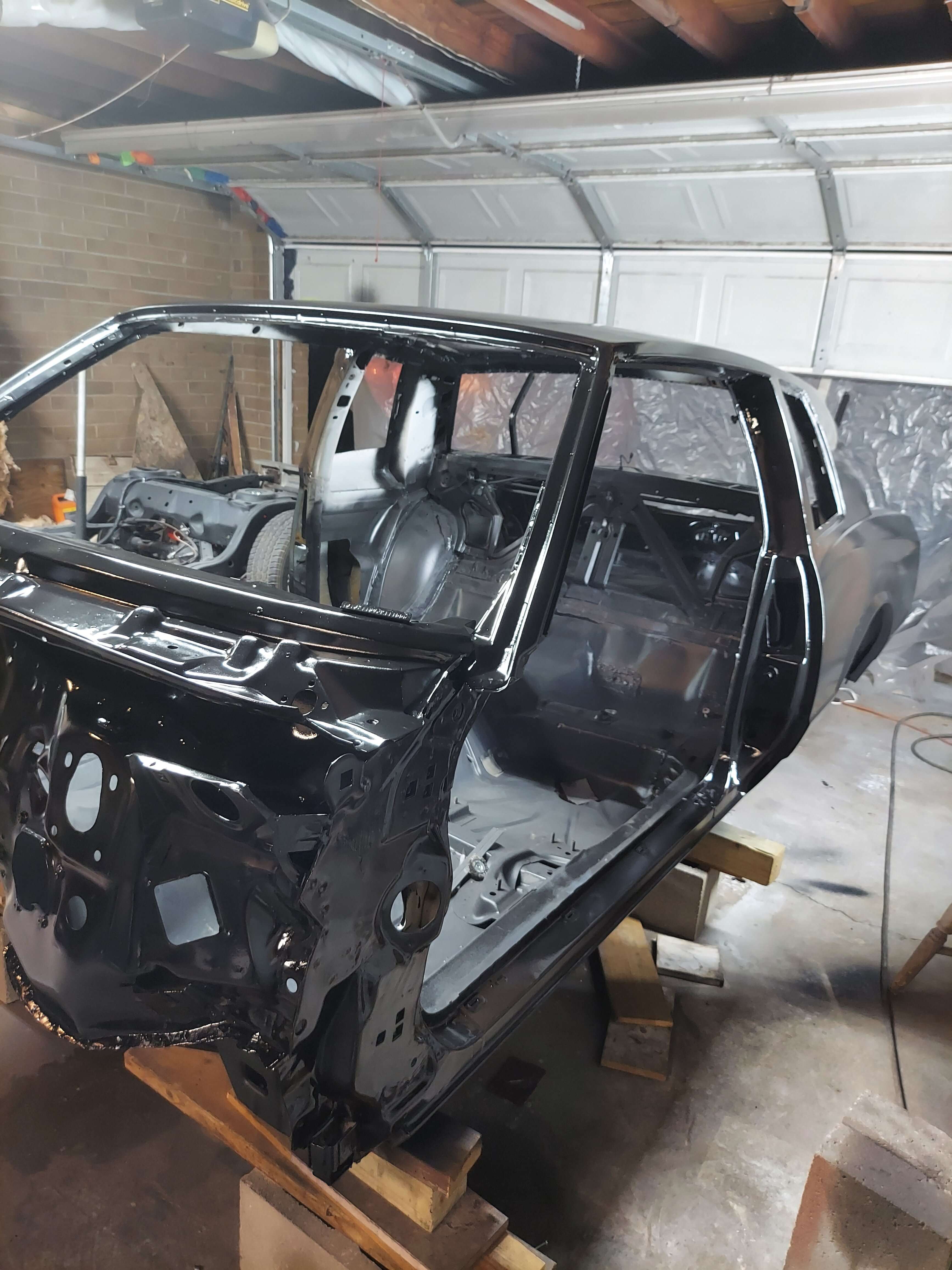

It's in epoxy finally. Solid 12 hr day, with all the prep. Scratching all the nooks and crannies is a pita. It came out good except. I got 2 massive runs right from the start on the pass. Qrt panel. I was holding the gun way to close, not paying attention.
Bugs were literally landing in my paint as I was spraying it. I'll never spray at night again.

It's in epoxy finally. Solid 12 hr day, with all the prep. Scratching all the nooks and crannies is a pita. It came out good except. I got 2 massive runs right from the start on the pass. Qrt panel. I was holding the gun way to close, not paying attention. View attachment 207382
View attachment 207380View attachment 207383

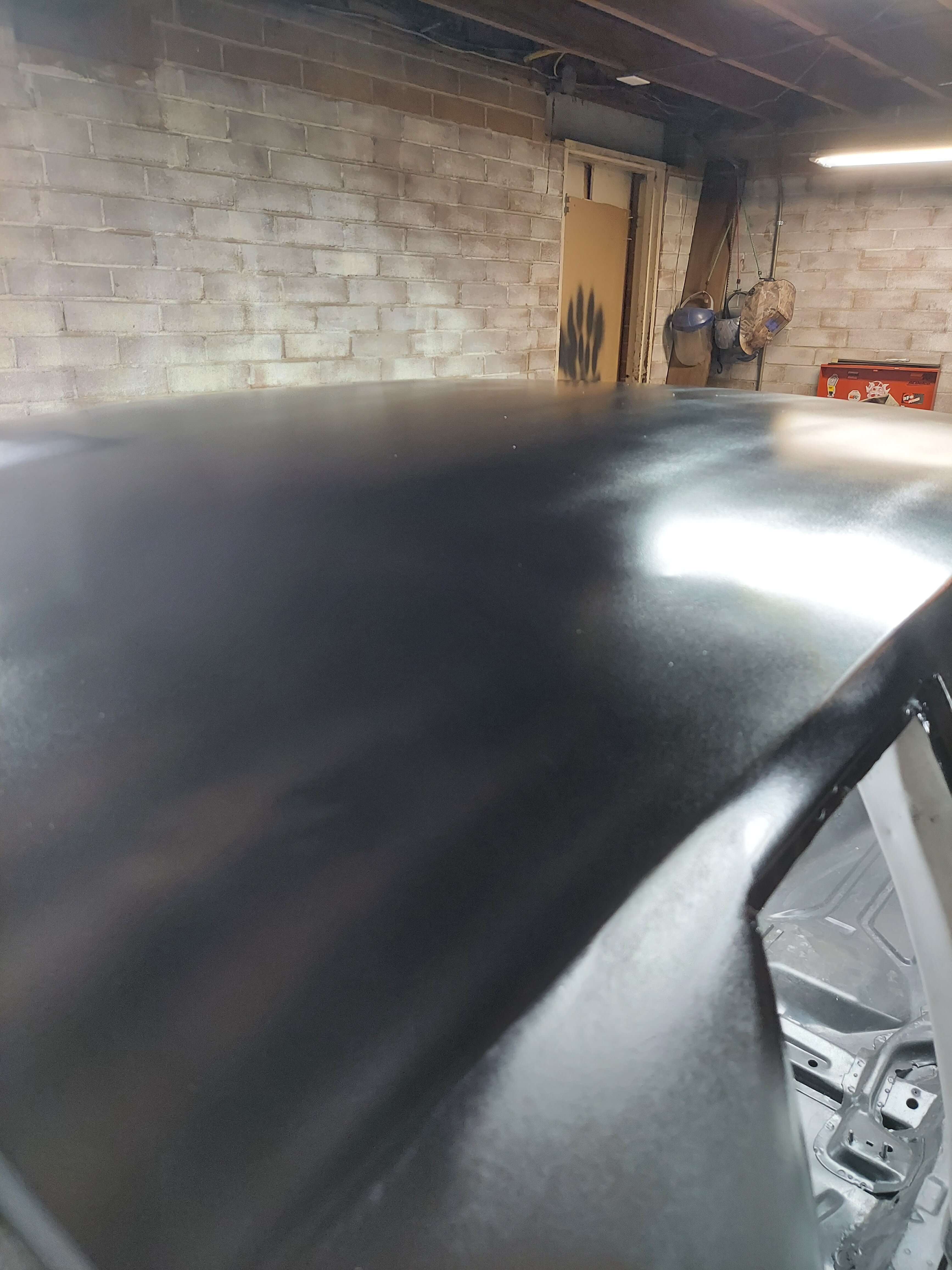

After letting the epoxy set for about 3 days I started the filler process. I blocked out the car with 180, revealing the lows and highs.
Can you tell which qtr panel I "fixed". Good grief Rktpwrd close your eyes. I remember reading him say something like there is no almost straight panel. It's either straight or it ain't. Welp, this ain't unfortunately. And by getting it "close", I dissappear about 1/8" of this body line
But most won't ever notice, so screw it I soldiered on. Around here I had finished both sail panels, rockers and a few small spots on the roof. I went to put it on the qtrs plus a LG spot on the roof, I must have mixed it wrong, cuz it stayed so soft I could flake it off with my nail I had to strip it down and start from scratch in these spots. I couldn't tell, I even sanded it smooth. It feathered into the epoxy with80, 180.. I only noticed when I picked up the paper with soft filler on it, i checked all the filler at this point for adhesion and if it was cured all but the qtrs and the roof were. From now on I'm marking on the paper where that batch went on the car.
