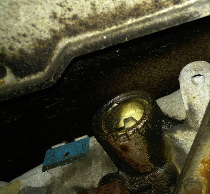

Found this leaking though , not really sure what it is or if it's even a problem. I know very little about transmissions so sorry for any stupid questions and I appreciate y'all bearing with me !

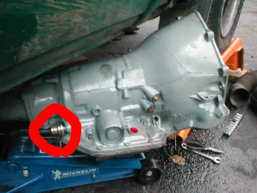

The modulator on a Th350 looks like this:
If there is one, there should me a metal line with rubber on the end going to the modulator. That line goes from the modulator to a port on the intake manifold. A Th200 with not have a modulator as stated above. A Th200 usually has the word METRIC stamped into the bottom of the pan.
Another thing, it could be a Th250, the lighter duty Th350. The Th350 and Th250 are visually identical in every way except for the band adjustment screw in the case above the cooler line fittings (brass pieces above the red plug in the pic). You never really know with a 32 year old car.
If it's a TH350, and the modulator is bad, they are only $15 dollars and come with rubber hose. If it's a Th200, the TV cable could be out of adjustment. It has to be at full extension at full throttle. That's how you adjust it. If it's a Th250, you might be screwed, but it's very unlikely it's a Th250.

if you look at the picture he posted of the leak that shows it's a TH200...
Guess I didn't see that post. ¯\_(ツ)_/¯
Welp, now that that's settled, look into making sure the TV cable is set right. Check the fluid level and condition as well.
