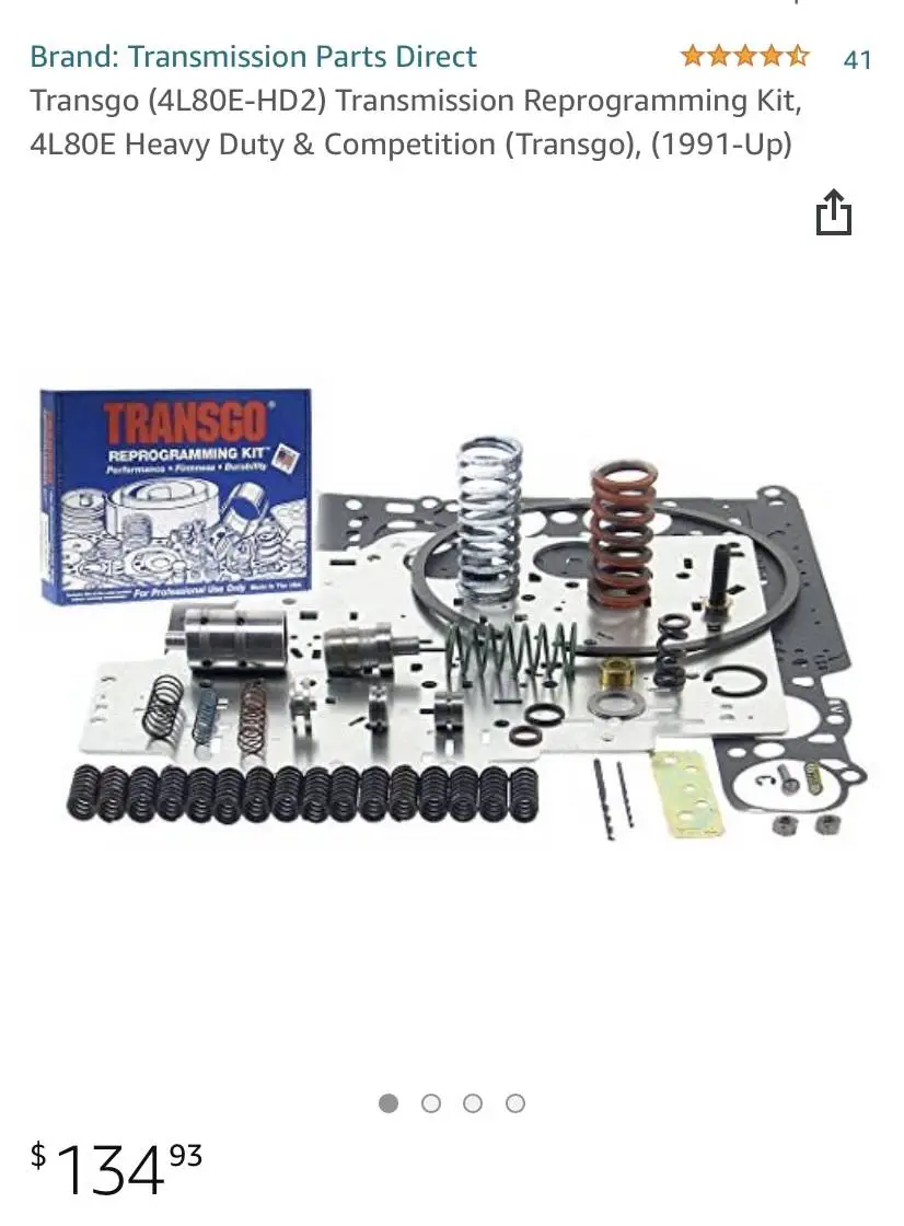

How much power are you running through your 454 and transmission? I just picked up a 4L80E out of an Aston Martin DB7 believe it or not... It read in this article, https://www.autogespot.com/the-legend-of-the-1999-aston-martin-db7, that they were rated to handle 440hp in that car but I have heard they can handle more. I am making around 530hp with my 383 stroker and need the stock 4L80E to handle it at least for half a year.

Most people will say a stock 4L80 in good condition is good for 600 hp. Add a Trans-go HD2 kit like I did and they are good for over 1000 hp.
Sorry, I'm not much for introductions I was just trying to figure out if this thing is gonna blow up on me tomorrow or not, lol. My name is Tanner though and thanks for the help. I'm going to leave it stock like I said for a half year to a year (especially if it's good for around 600hp stock) and then rebuild it when work slows down and I have some free time.

I don't have the Trans Go kit in mine, but I do have a good pump and it is properly rebuilt. I'm making north of 800hp. You should be fine on a stock unit with your motor if the trans is in good working order.
