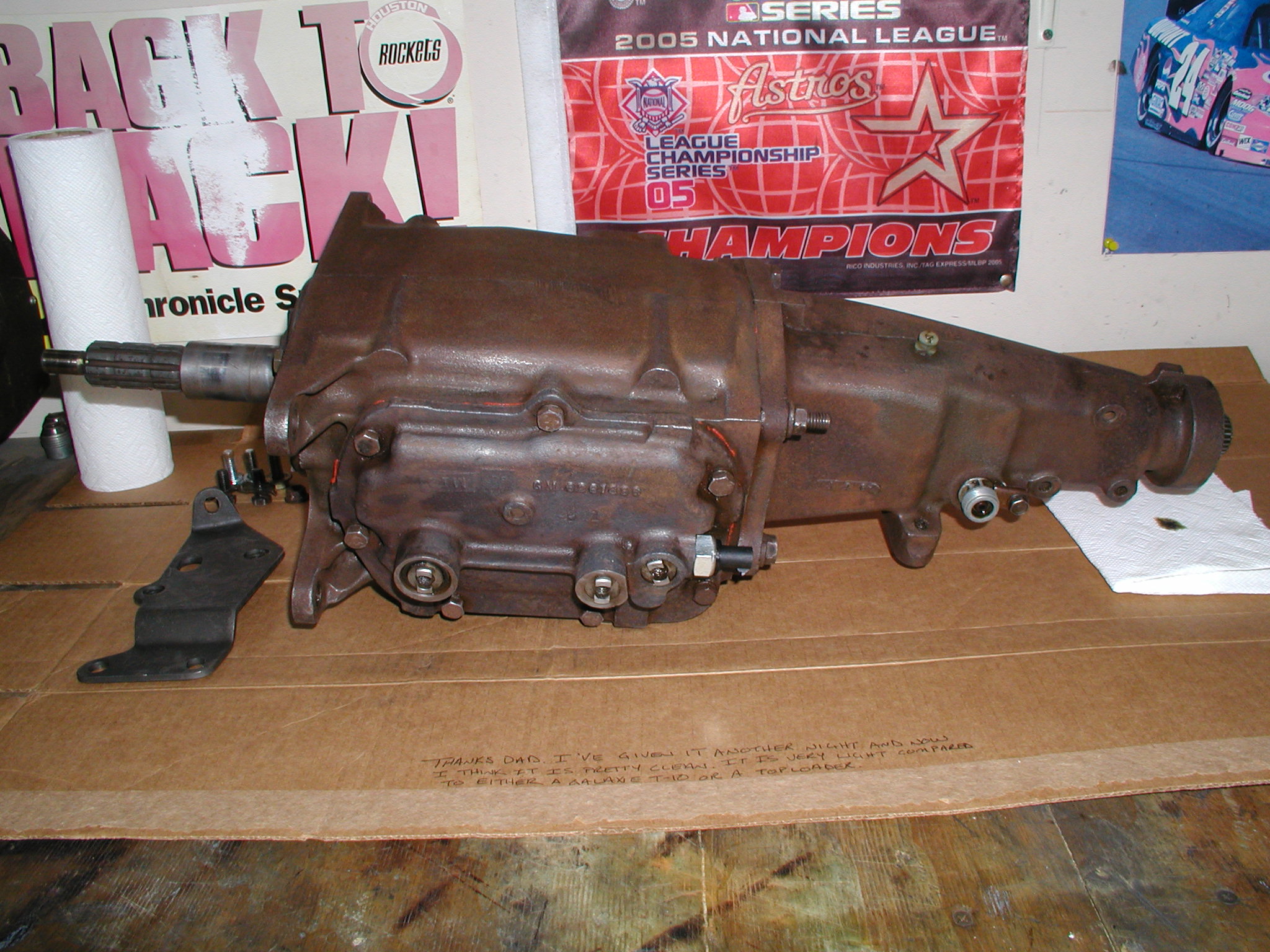

I also got the four speed cleaned up in preparation for the overhaul. It also was filthy. It had geologic layers of crud on it. It's looking better now.
Reactions: MrSony
