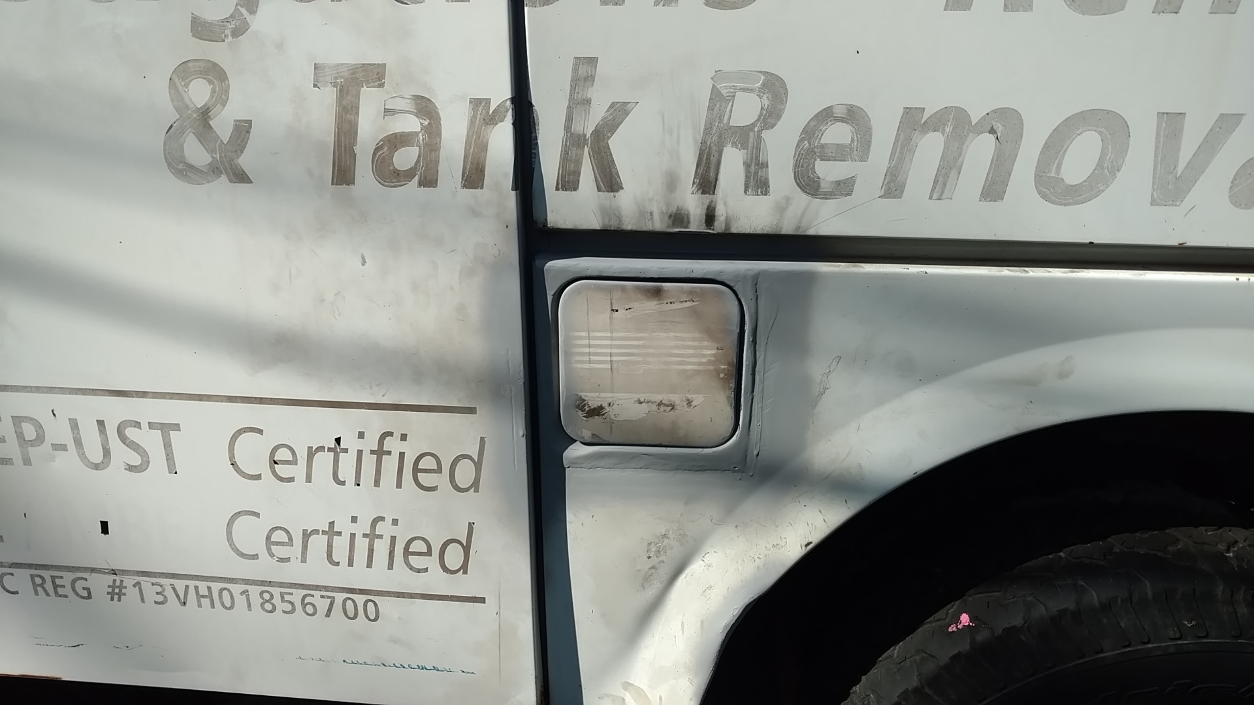

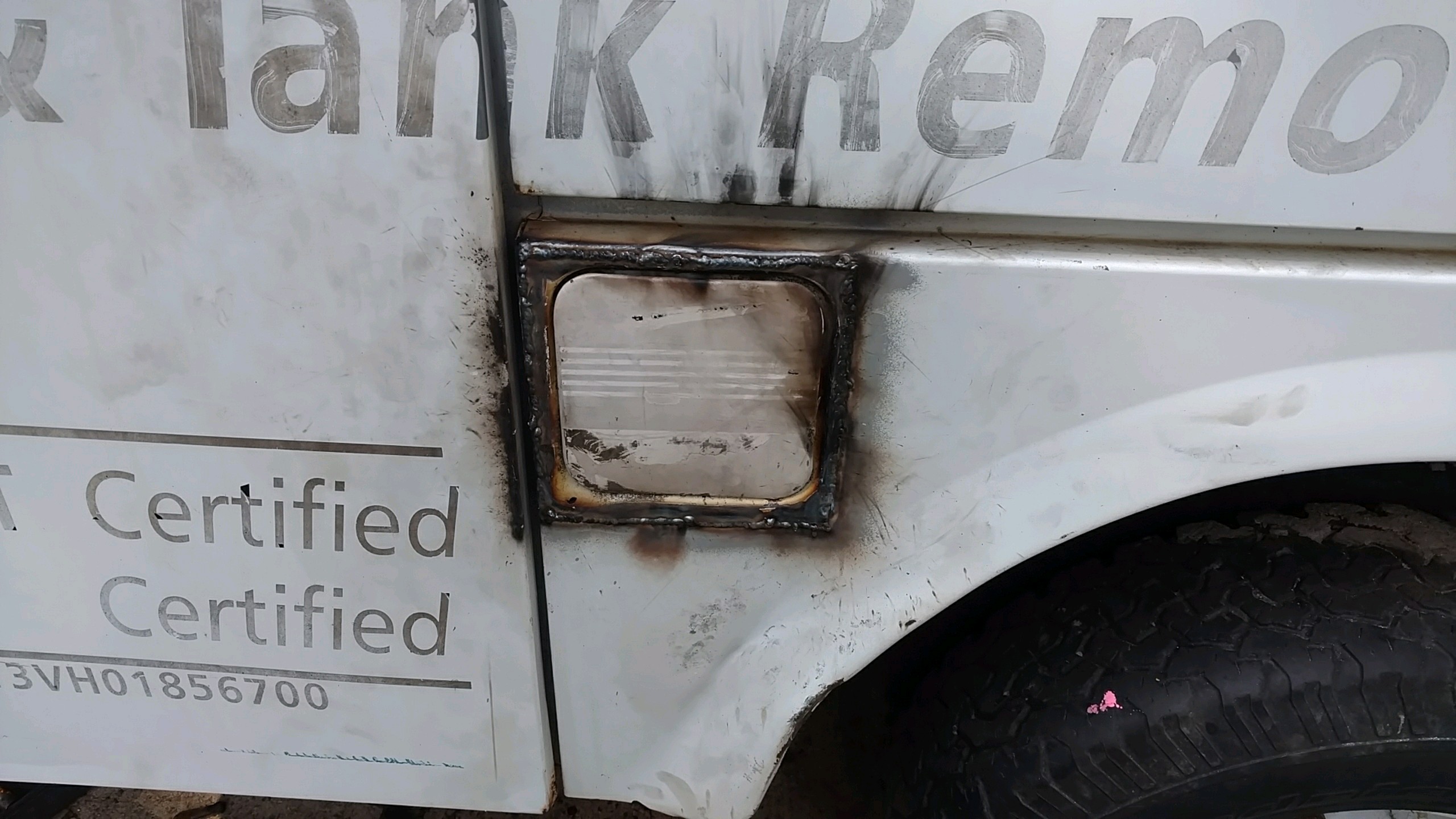

Anyway put the truck in the driveway and did some waking and hacking. Tired of running it off a gas can I chopped a hole in the right quarter and welded in a gas door and pocket from an 87 Blazer got a little creative with some exaust pipe and some hose and for the first time sence I owned it it has a filler neck. Cut a hole in the bed brace for the filler to go threw and braced it with C-CHANEL. Cut the fuel line to fit installed a filter on the rail by the tank hooked it all up and it works. It's not my best work but then again it's going to be my work truck

Anyway put the truck in the driveway and did some waking and hacking. Tired of running it off a gas can I chopped a hole in the right quarter and welded in a gas door and pocket from an 87 Blazer got a little creative with some exaust pipe and some hose and for the first time sence I owned it it has a filler neck. Cut a hole in the bed brace for the filler to go threw and braced it with C-CHANEL. Cut the fuel line to fit installed a filter on the rail by the tank hooked it all up and it works. It's not my best work but then again it's going to be my work truckView attachment 72654 View attachment 72655 so glad I'm not doing that anymoreView attachment 72657 View attachment 72658i just roughed it out and primed it good enough for nowView attachment 72660 form and function tomorrow morning I'll try to get something else done
