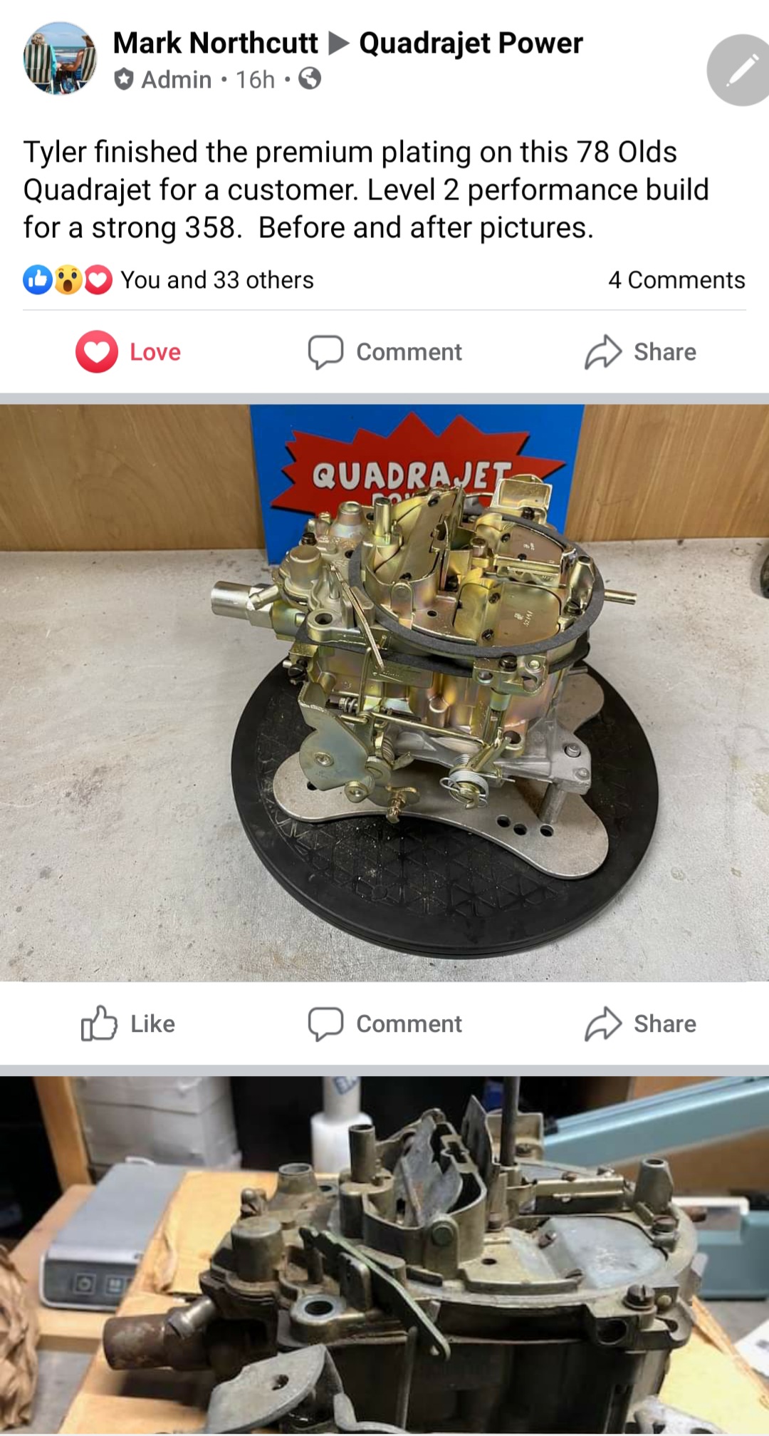

Only a matter of time before I get to see the Salon come to life. I'm really pleased at how great the carb looks. Shot out to Quadrajet Power for that! I'm positive I will be pleased with it's performance as well. Until then I'm waiting for FedEx to deliver. I will follow up with an update. Here is a before and after picture.
Only a matter of time before I get to see what the Salon will come to life. I'm really please st how great the carb looks. Shot out to Quadrajet Power for that! I'm positive I will be pleased with it's performance as well. Until then I'm waiting for FedEx to deliver. I will follow up with an update. Here is a before and after picture.View attachment 161916
It is amazing what an idle recalibration does to these late 70's Qjet's. My 78 403 carb was night and better after Everyday Performance recalibrated it for my 9.6 to 1 Olds 350. I plan on using Cliff Ruggles book to rebush, rebuild and recalibrate the idle circuits on the even leaner 800 cfm 83 Canadian non CCC 307 Qjet. It is so lean at idle it needs the idle cranked to 1200-1300 rpm. Can hardly wait to hear this motor run!
