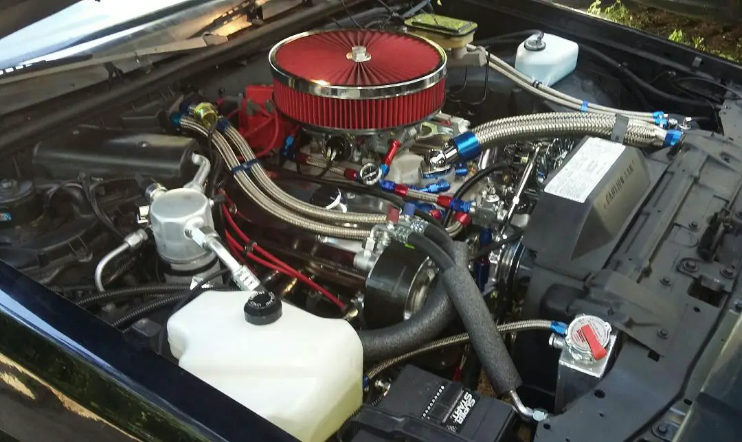

On my Regal even though I replaced everything in my AC system I used the 307 Olds set up because I didn't want the compressor on the driver's side.
I modified some LS AC brackets to mount my compressor and then made my hoses.
Also my Heads are from Skip White and work great.

That’s real nice looking at least I know it can be done now I’ll get some pictures put on here soon. The car is a real dark burgundy
