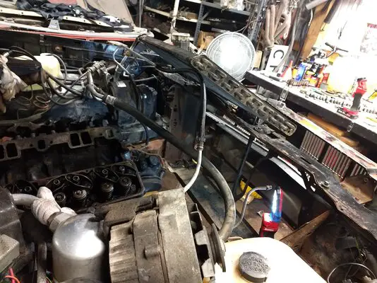

The victim:

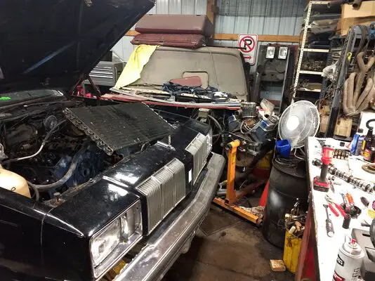

The work space:

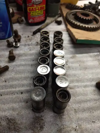

The damage:
I've turned my favorites upside down so you can see what happened but they're all messed up, and I wish you could feel how concave the bad ones are. This view displays the lifters in their respective positions in the engine, with the top left being cylinder #1.
Got a couple of flat lobes but nothin' to be too concerned about, right?

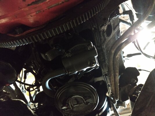

And here's an upskirt shot for you pervs out there:
The choice was to do this inside the building or use the engine hoist to yank the engine, fix, and reinstall it with the car outside. I'm happily performing this task with the engine still in the car, though you'd question my level of happiness at times.
