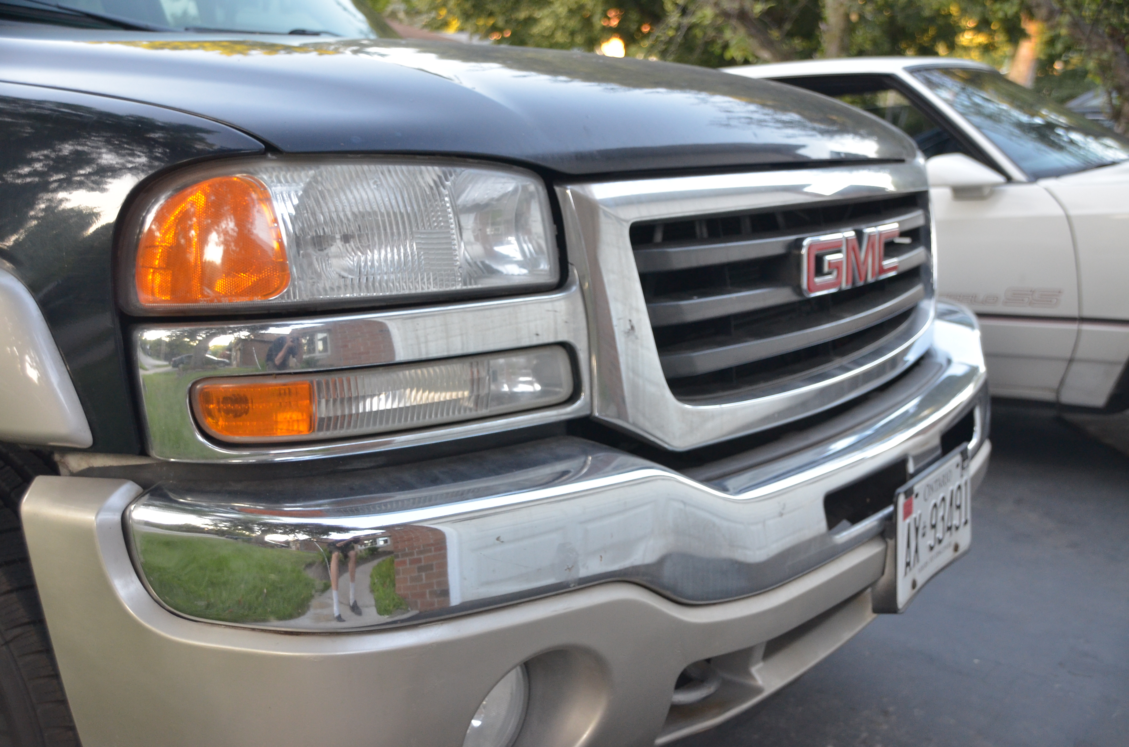

Needless to say, I was pretty happy on Sunday with how things turned out. I've driven it to work two of these last three days. Not everything is rosy. First, the aftermarket headlight assemblies are garbage. I tried to adjust them Monday night after work. They were pointed at the sky, out of the box. I had to adjust the driver's side too much, evidently, as the adjuster came apart. I literally have a piece of folded up paper jammed between the adjuster and the core support holding the beam in approximately the correct position. Also, the passenger side is already clouding up. Finally, even with the Silverstar Ultra's, I'm not satisfied with how much light they are putting out on the ground. The other problem is that the top of the tires have rubbed the fender liners. They aren't hurt but they are marked and that hurts my feelings a bit. They were new. This morning I cut the wheel each way and was able to reach in and adjust the shocks after I got to work. I went in four clicks on both compression and rebound so we'll see how that feels on the way home. I need to measure again because I suspect the front end may have settled some.
On the headlights, I bit the bullet and bought a pair of genuine GM assemblies. I also bought some very bright LED high beam, low beam and fog light bulbs. Finally, I bought a headlight assembly tint kit. The tint is pre-cut to close to the right size. The tint is made in the USA and is supposed to last for 5 years. It is supposed to protect the headlight assemblies from the sandblasting, yellowing, etc. We'll see. I really prefer the smoked look on the headlights so we'll see how it goes.

I like the front end lower but I'm not willing to live with the rubbing. On the agenda is to put in the new genuine GM headlight assemblies to replace the trash aftermarket ones in the truck. I'll have to have them tinted because I really like the look of the smoked headlights. Also, my brother and sister-in-law got me a set of CalTracs traction bars for Christmas. Installing them is on the agenda. That's it for now on this one friends. I'll update when there's news to report.
