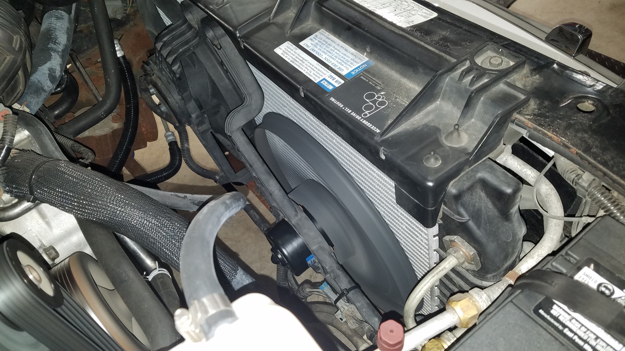

I daily drove the car three days last week. Last Monday night, when I got home, I aimed the headlights. It was cool outside so I wasn't running the A/C and was letting the car idle. The temp guage crept up one tick away from the red, which is the warmest I've ever seen it get. It turns out that's not that warm (low 220's) but it was disconcerting at the time.
In looking into what was going on, I realized the primary radiator cooling fan motor wasn't running. It turns out it hasn't run the entire time I've owned the car. I had misidentified the Driver's side fan (the functional one) as the primary fan.
In my research, I learned you can display most of what the ECM monitors on the climate control display in the car. Armed with the temperature that the primary fan (passenger side) is supposed to turn on, I watched the coolant temperature and observed the fan didn't run. I didn't diagnose it further. I bought a Four Seasons replacement motor from RockAuto. It was a $28 gamble.
I replaced the motor after work tonight. I was a little surprised to learn the motor had been previously replaced. When I swapped the motor I noticed the old one had a NAPA tag on it. Anyway, Success! Now the primary cooling fan works. Another small improvement for the car.

Are those fans shroud less?
