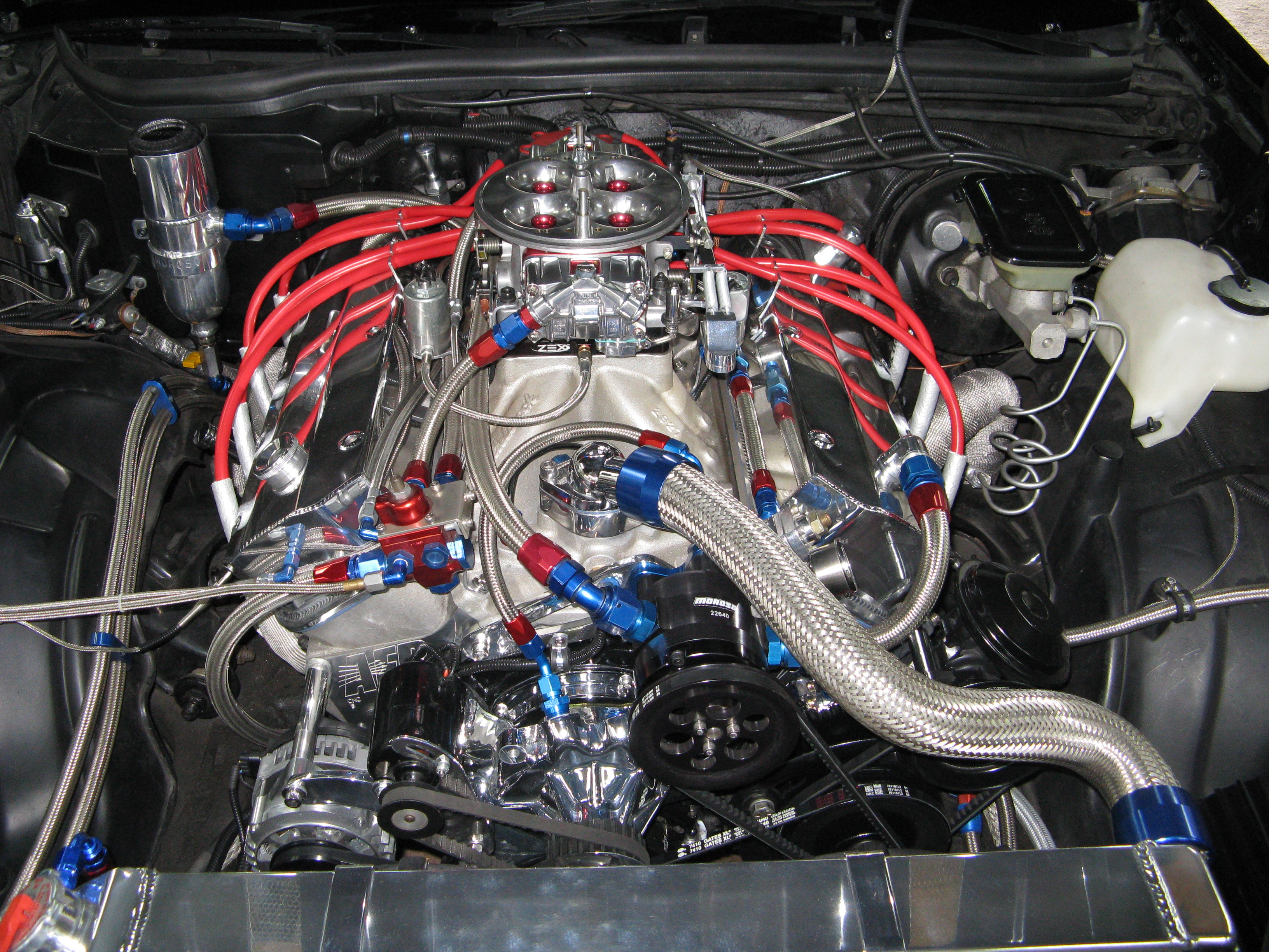

Are ya running an external trans cooler & the radiator tank?
I am bypassing the radiator and it instead goes to a trans cooler with a fan and then into a B & M Trans Fluid Consistency System that holds 4 more quarts.

A question for the guys running AN lines WITHOUT an external cooler. How do you run them to the radiator fittings ? Theyre a good distance apart. Just having them hang might look kinda strange. Bending them at an angle to follow the radiator might look worse.

Another thing done. Getting closer to having the 81 back on the ground. I liked the way 565bbchevys lines looked along the inner fender so I did the same thing. Used 4 AN clamps. I attached 3 to the inner with 1" socket head screws. Easy. I had to make a few runs to the speedshop to get the right angle AN fittings. Used 1 90 degree and 3 30 degree hose ends. I also put a couple of pieces of split loom on the battery cables just in case. Couldnt believe the total cost of this stupid set of lines ! LOL
In the end Im happy with the way it turned out.
Thanks 565bbchevy !!!!
