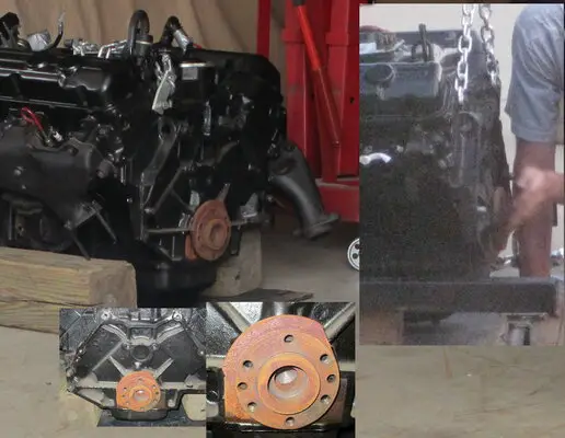

I was digging through old photos and it looks like the block was drilled. Can't tell if it was tapped.
Too bad I don't still have the 307 in the car and the 350 on a garage floor. This is all I have for info on my crank. Wish I had taken measurements.
Back to the block, if it is tapped, it would be cool to use mechanical stuff if I find a deal. But the clutch fork would be an issue. Even though both bellhousings I have were designed for clutch forks, neither were probably designed for G bodies.
