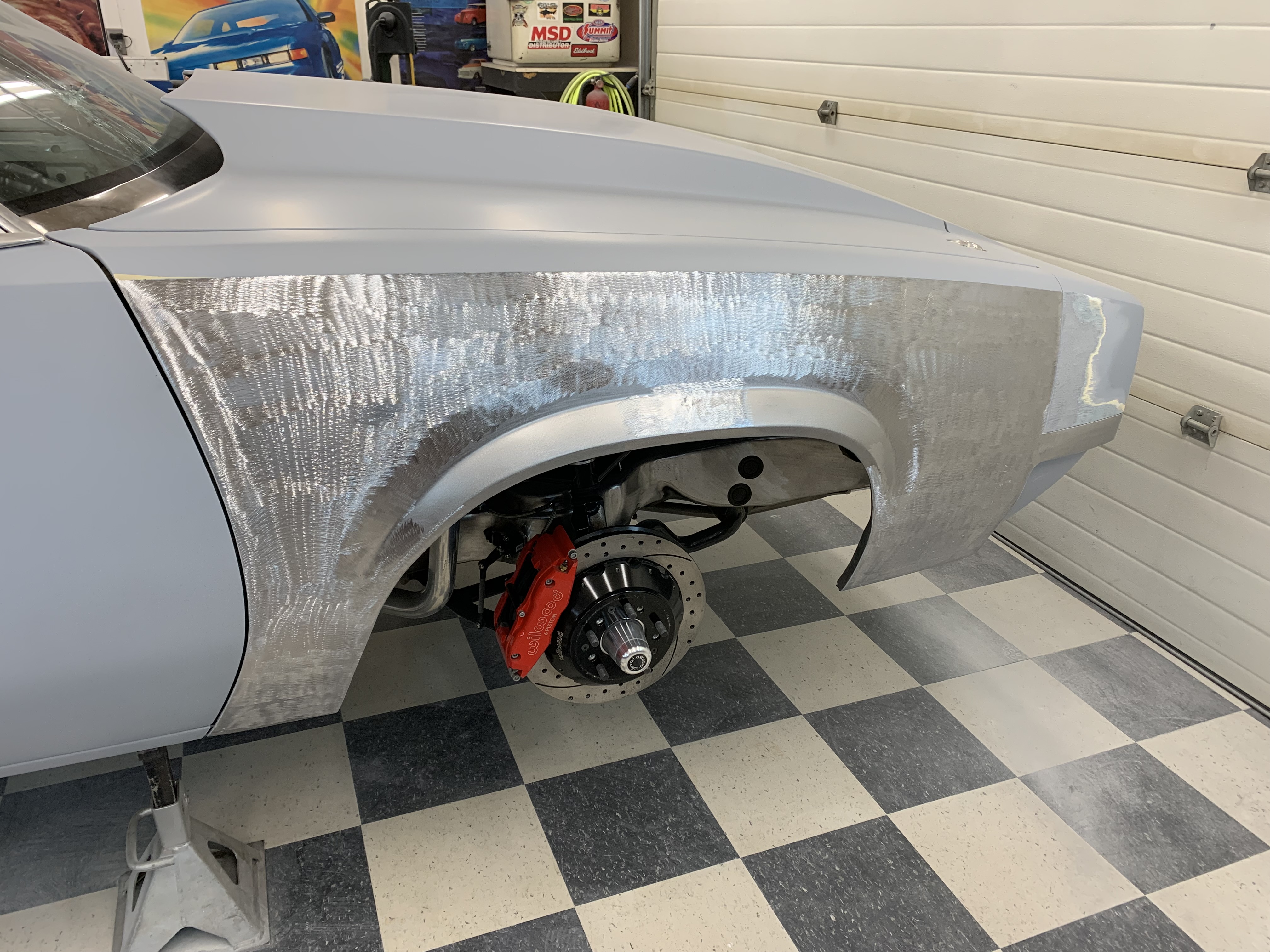

I had a few hours here and there over a couple of days before Christmas to fabricate and weld in the end pieces for the driver’s side, so that’s now all complete.
Yesterday Mike was over, and I had to find a new project to keep him busy while I was stripping all the old primer and filler off of the fenders. I wasn’t happy with the work I had done on them, mostly because I’ve learned so much more since then. I was only using etch primer, not epoxy at the time, had Kitty Hair over top of filler, putty over top of primer, and all kinds of other small faux pas’ that I now know better.
So, off it all came, then the surfaces got profiled with 36 grit in preparation for the first round of fibreglass filler that will kick off “Fender Filler Work 2.0” later today. Stripping and profiling both fenders took me all day yesterday.
