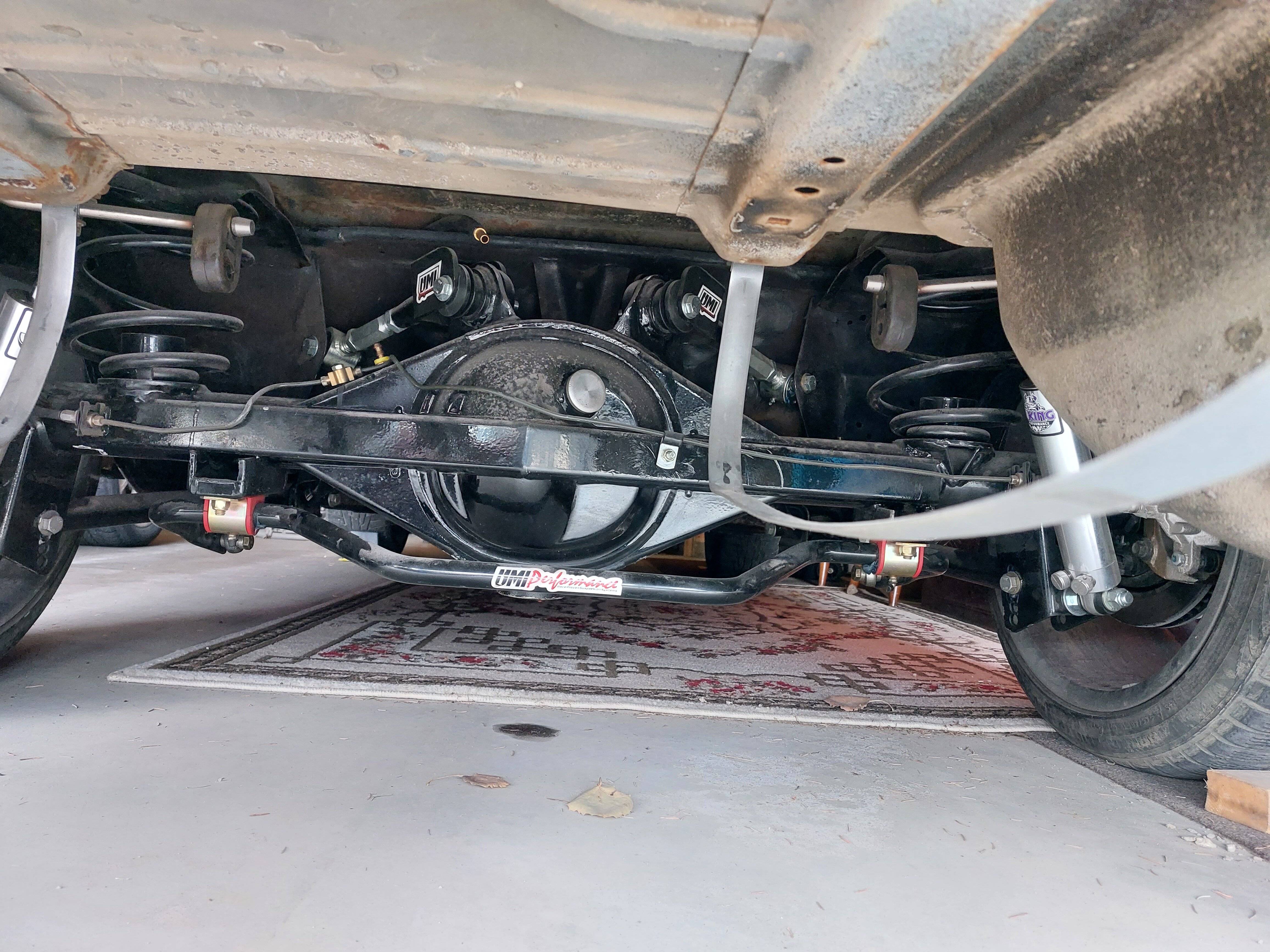

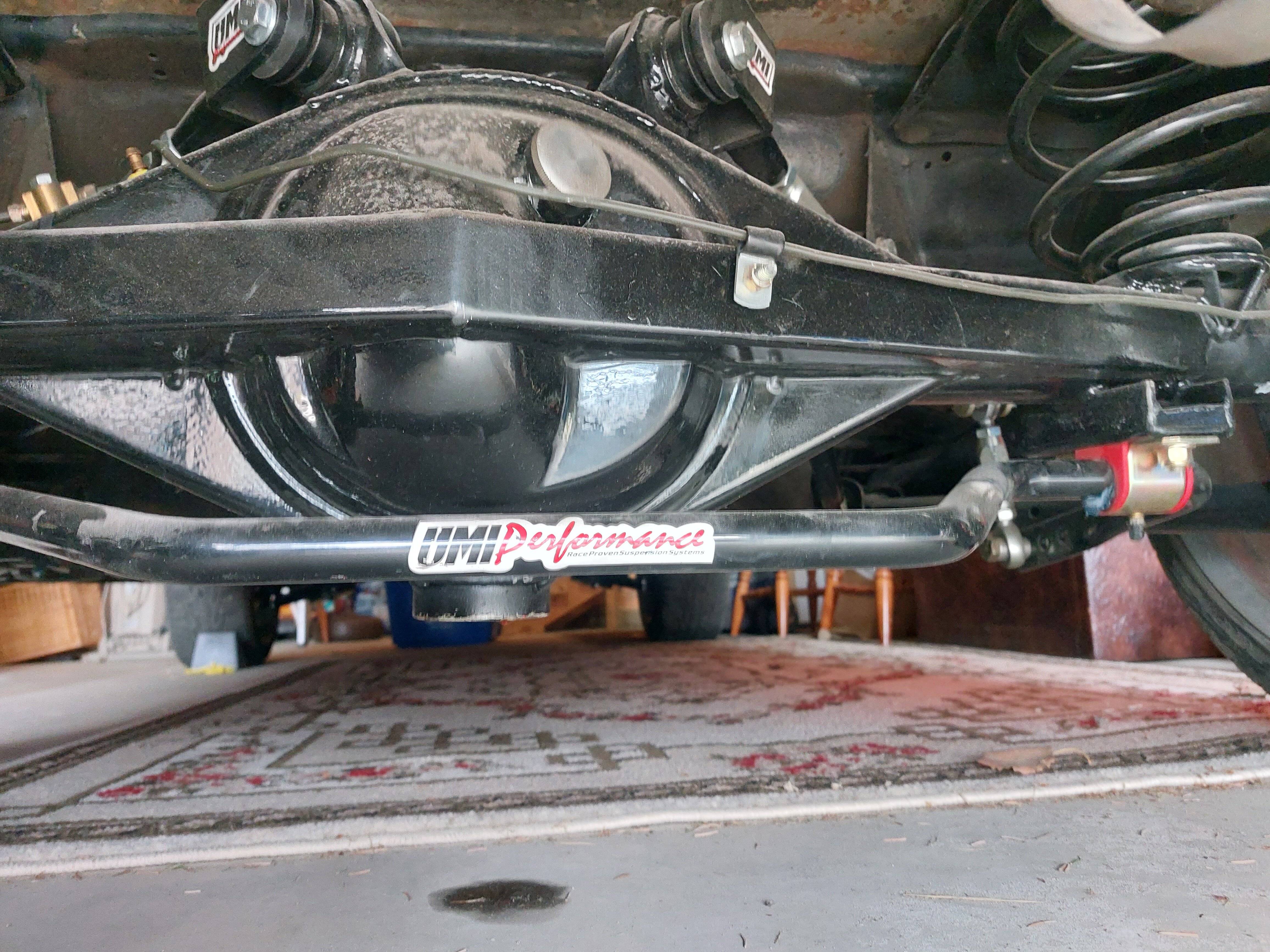

UMI drag bar.

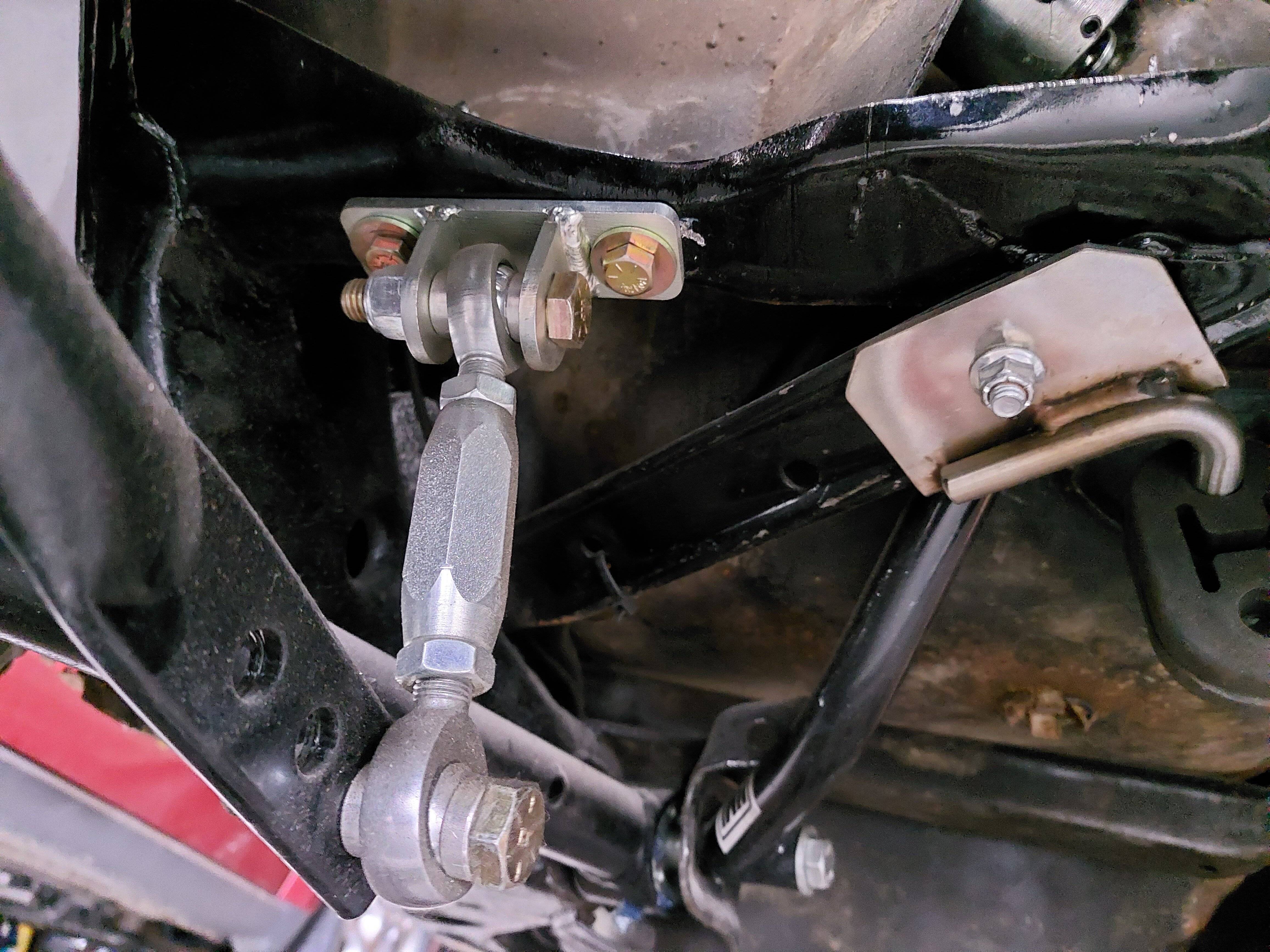

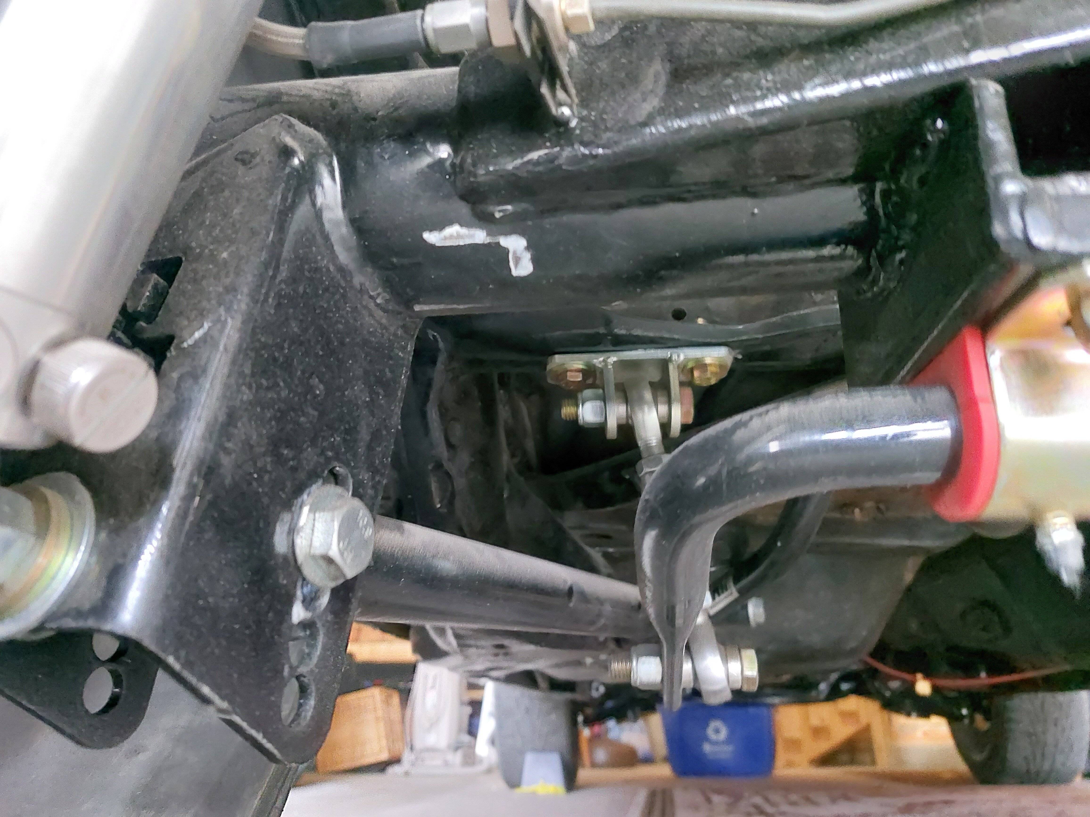

As for modifications, they probably won’t be all that extreme. Cutting the end links to get it sitting level at ride height, welding the saddles on to eliminate the unsightly U-bolts, and using the stainless lock collars outboard of the axle bushings to keep it from shifting around.
