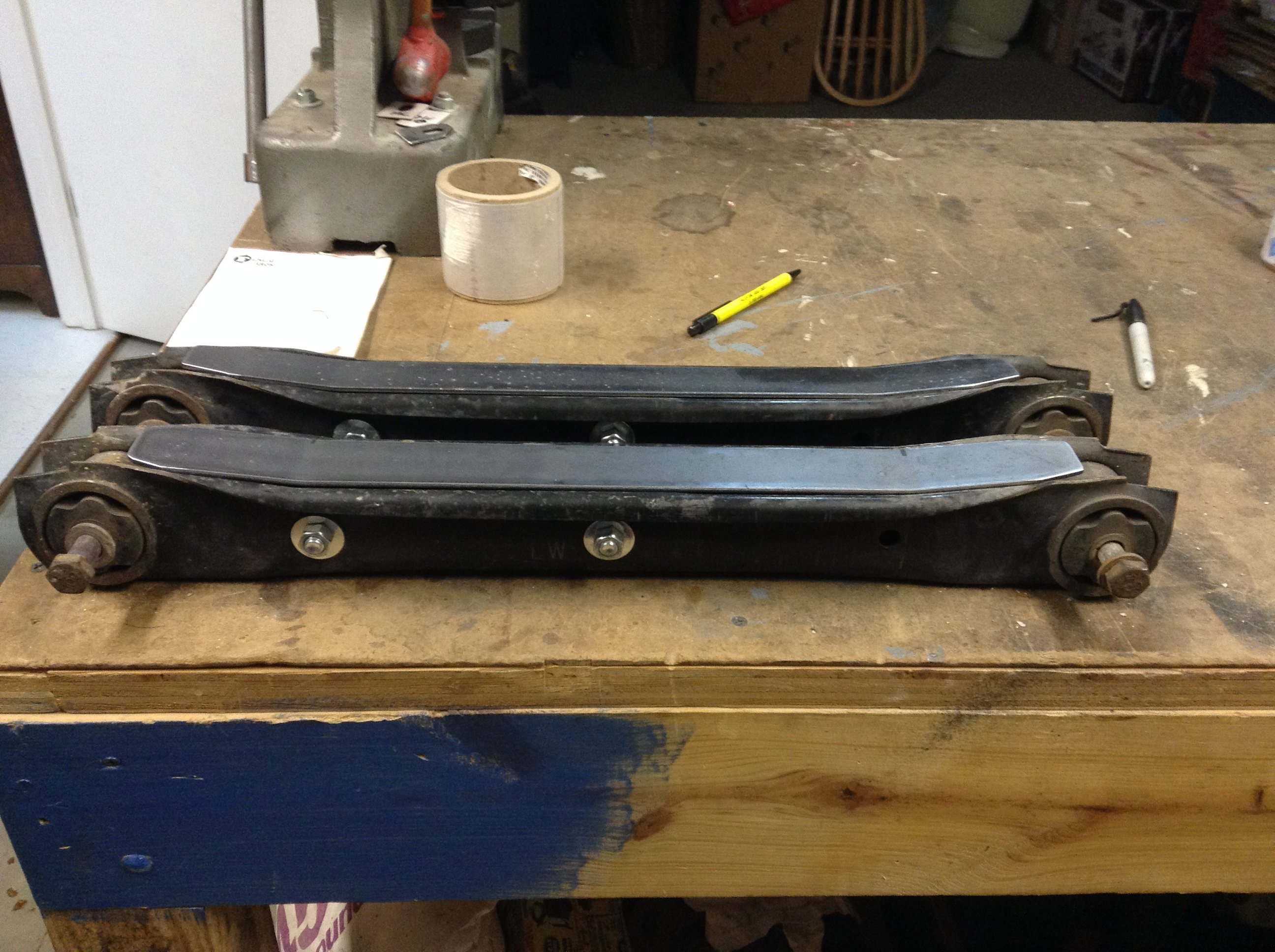

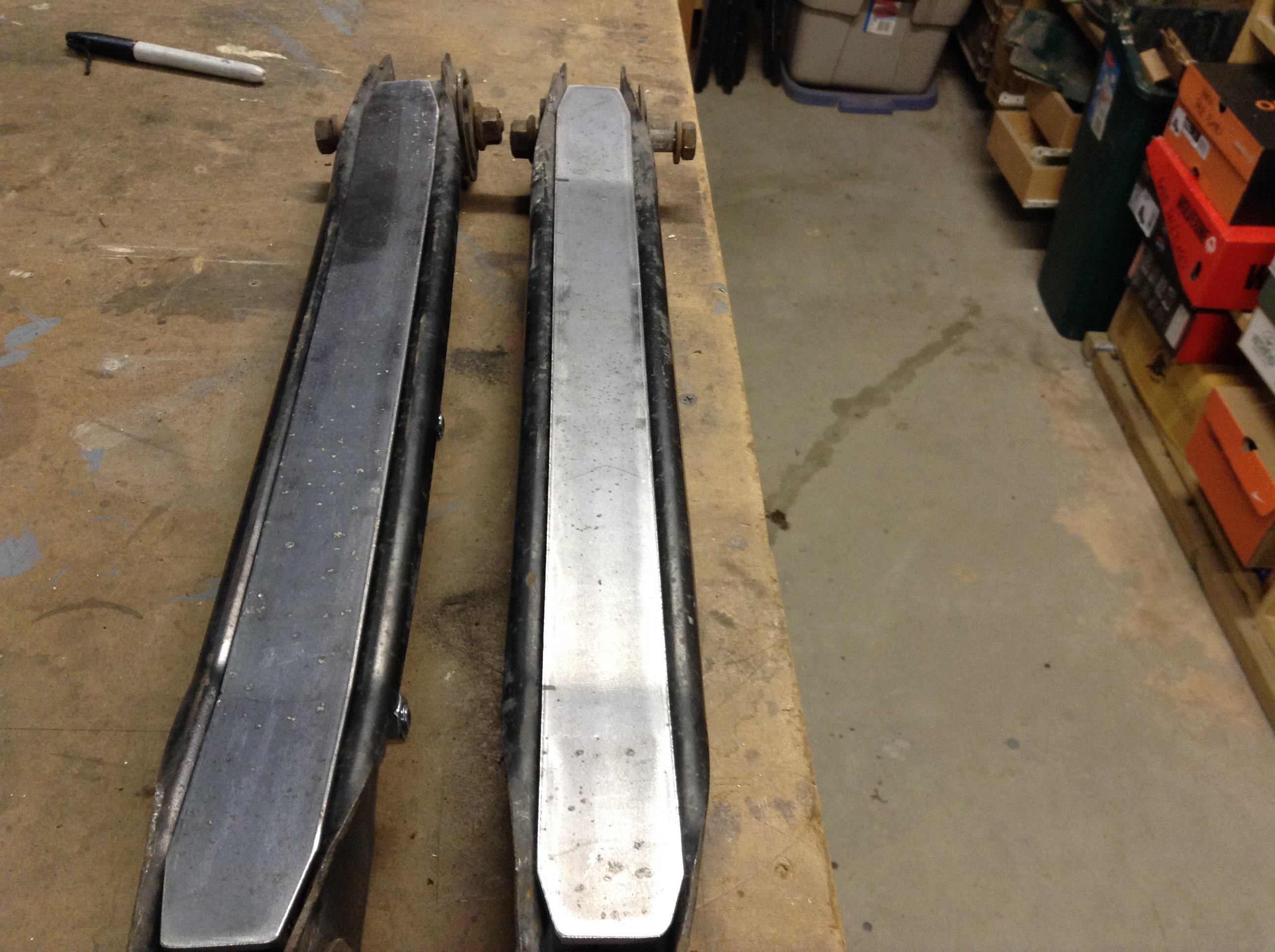

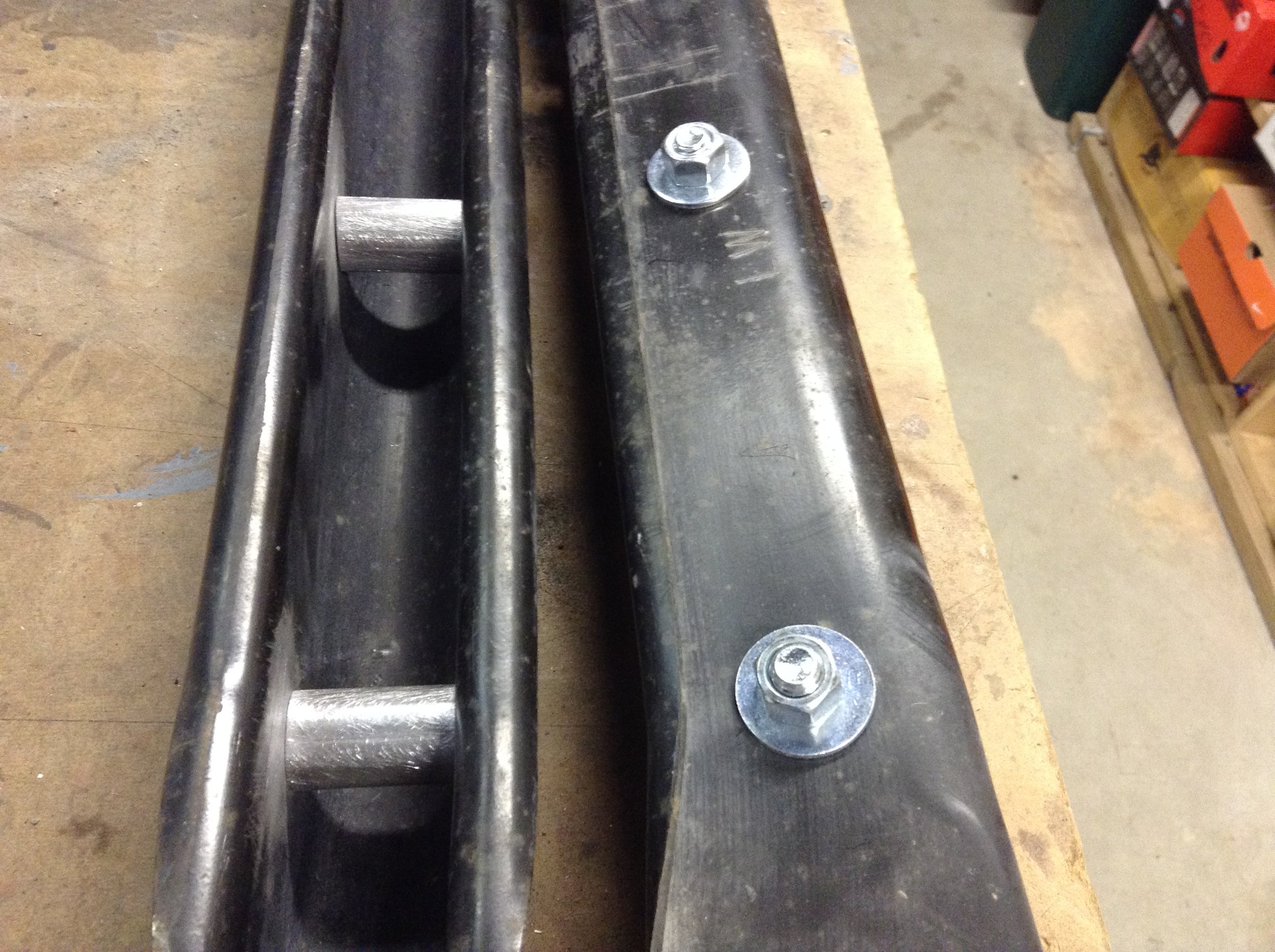

Not sure if this has been covered in this thread so l will post it. For guys wanting to box in their rear lower control arms,most times the arms are rusty, sometimes bent and have 30 to almost 40 year old bushings in them.
Instead of using those arms , go to the junkyard and look for a 4 th gen Fbody I have found several sets that are almost rust free with way newer bushings. Another plus is they are even easier to pull than a GBody.

View attachment 63516 View attachment 63515 View attachment 63510 Not sure if this has been covered in this thread so l will post it. For guys wanting to box in their rear lower control arms,most times the arms are rusty, sometimes bent and have 30 to almost 40 year old bushings in them.

Was mentioned but no pics were provided for comparo
