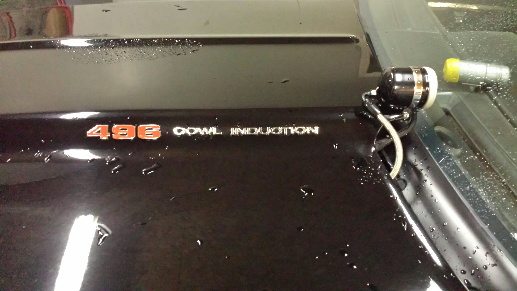

Hey that hood looks familiar! Those are the same emblems I used. I got them through Summit.View attachment 39568
Very nice tach location. Yes i did get them through summit lol. I will try my best to inslall my hood tomorow. Favorite part of a cowl hood is a cars look can turn from "oh look at my nice car" to "move out of my way this things a beast".
Its a fuel pressure gauge not a tach lol.
