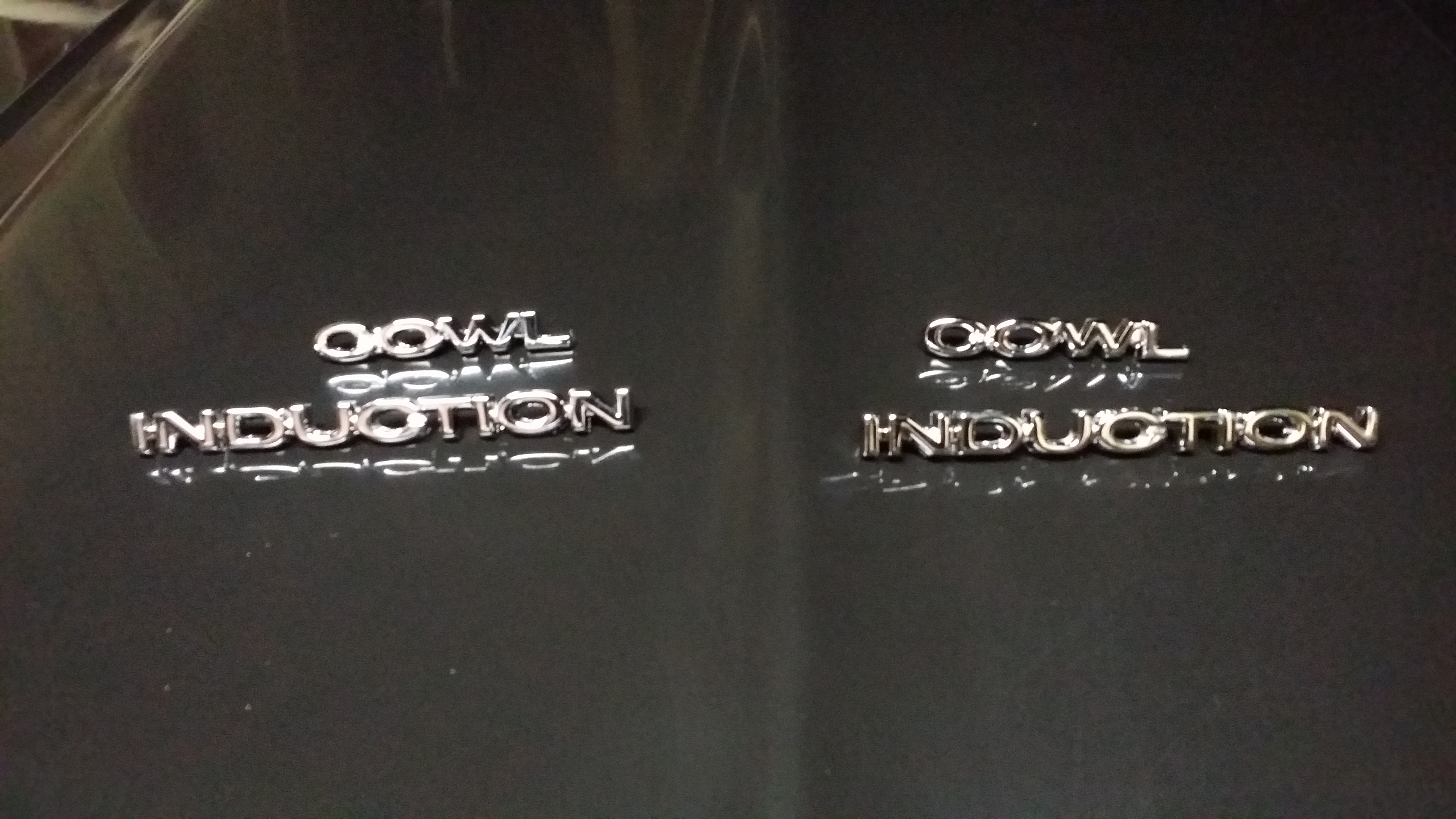

Well got the hood all nice and shiny! Gratified...yes. Was it easy...NO.
I did exactly how I said I would, a fresh coat then a last 2000 wet sand. Left the surface smooth to the touch. Applied rubbing compound to scratch out the scratches. Sounds crazy but that's how paint works. I could get the hood perfect but that would mean 3hrs of 2000 wet sanding and no life...and before that I need about 5 coats of black and thats wayyyy too much. Using the rubbing compound on the surface immediately changed from flat to gloss but removing the compound was the worst. Rub rub rub. Leaving a nice glossy finish but has an unfinished gloss if you know what I mean. A typical paint detailing would call for rubbing compound (if needed) polishing compound, then a wax. I'm going to go ahead and jump to the wax next. The rubbing compound I chose wasn't nearly has harsh and soft enough to skip a polish.
So up next a CARNAUBA wax.
Looking good. Can't wait to see it on the car.
